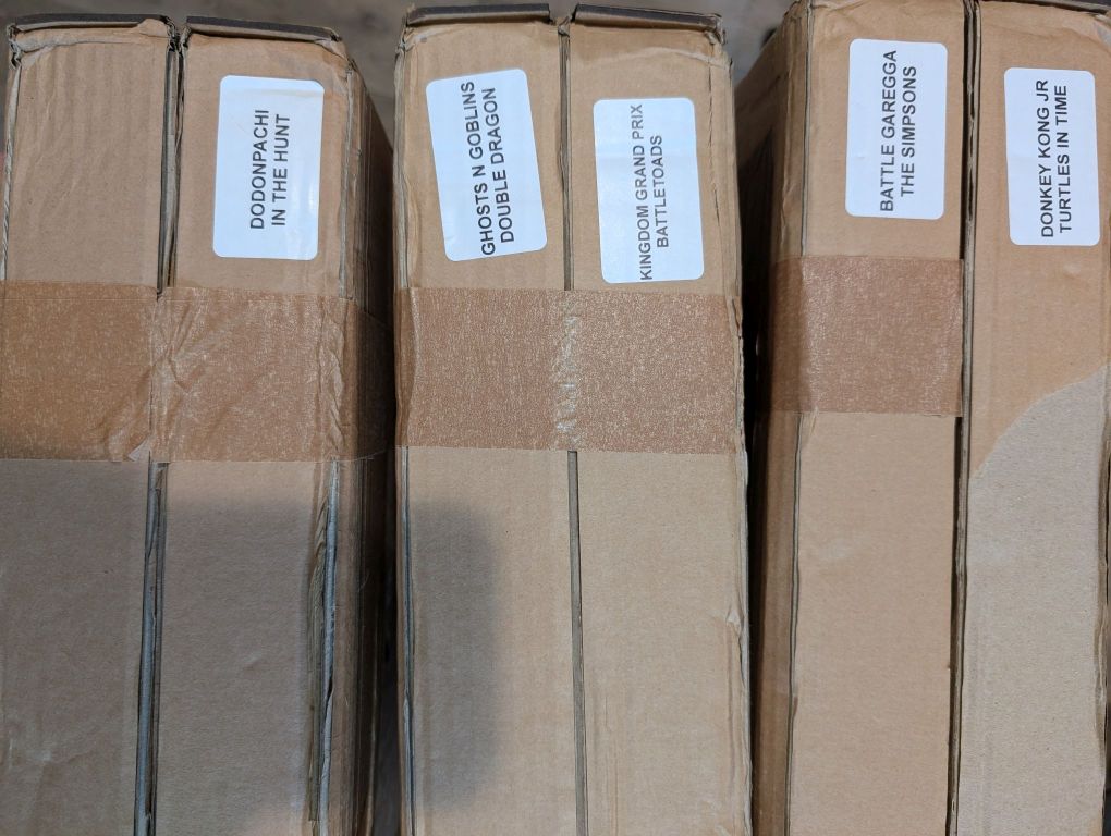

Shipment and Packaging

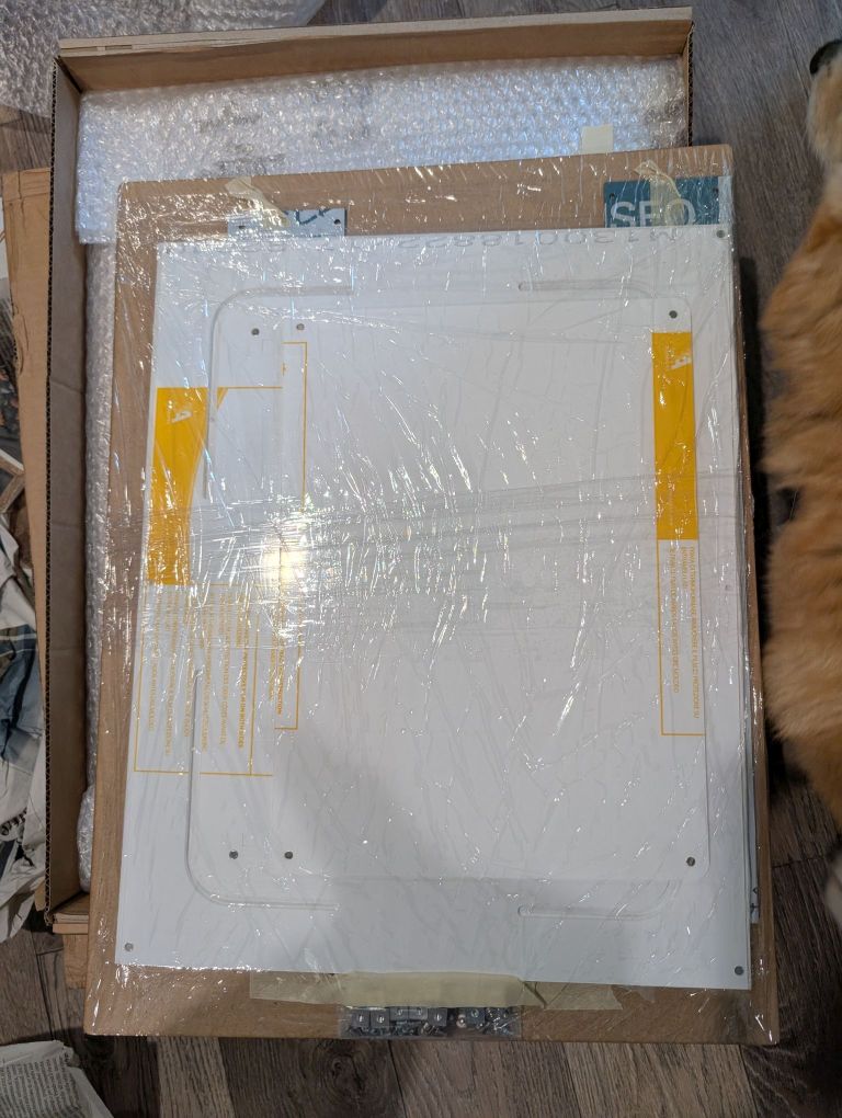

The packaging and organization on the shipment was, simply put, outstanding. The cases were broken down into several discrete packages, each consisting of a couple units bundled together (with each unit having a couple cases inside). Each unit had a label which identified which cases were contained within. Opening up a unit revealed the individual case bundles (each individually wrapped, labeled, and protected). Each case's individual parts (and an accompanying hardware package) were not simply wrapped together- they were also affixed by tape to a large batting board (which is a step above and beyond). The common hardware package for the entire set was located in one of the units, and was itself broken down and bagged individually for purpose, with clear and easily legible labels.

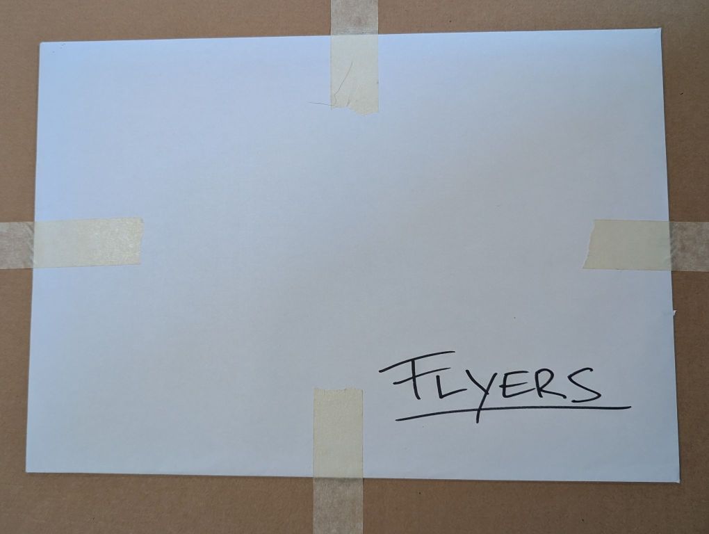

The artwork comes with the cases (a very pleasant surprise to me). The side labels appeared to be printed on light card stock. The flyers were likewise professionally printed, but on double-sided, heavy gloss paper. On the opposing side of the game art flyer is the instruction set (where applicable, otherwise an alternative art is used so you can choose which you like). Also included was a roll of corners, for affixing to the cases to hold the flyers. He even included a couple sets of nitrile gloves (to prevent fingerprints during construction) - a thoughtful touch.

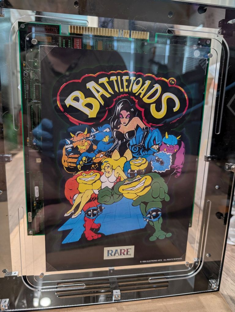

Construction
The construction process was straight-forward and easy, made even more so by the very clear visual instructions (in the form of a PDF build guide) that @Semload provided. Once I completed the first and understood the process, I was able to go from packaging breakdown to completed build in about 45 minutes per box (working at an unbothered pace). The hardware for the box looks and feels of good quality, and the acrylic was laser cut cast acrylic. On the bottom plate is engraved the game's logo and on the opposing plate is a set of alignment marks to permit for affixing the included game flyer. The sides and bottom of the case are affixed via screws into aluminum (I assume they're aluminum, anyways) support cubes. The top edge is affixed entirely by magnets (permitting easy access to the edge connector). Similarly, the 'face' plate is held in the corners by magnets, but the connection is reinforced by two large thumb screws through the middles. This arrangement allows for fast access to the underlying PCB without having to break down the box (while the thumb screws ensure it's sufficiently held in place).
Issues
As we all know, not everything goes perfectly. The side labels suffered from a few mispunches for the mounting holes, and a couple were just slightly too large. Having said that, the holes wound up disappearing once mounted, and the very-slightly oversized labels were appropriately clamped into place by the mount, so it wound up not mattering. Additionally, a couple plates wound up needing a recut. One plate was simply a manufacturing error, the other was the result of Battle Garegga's unusual orientation (which has the edge connector on what may be construed as the side). After speaking with @Semload and identifying the issues, he promptly made it right, and I have zero complaints. Accidents happen and this was resolved 100% without issue.
Criticisms
With regards to criticism, I do not like the magnets. I will almost certainly be removing them and replacing them with screws. On paper the idea sounded really great, and I quite liked the concept; but, in practice they are far too weak to accomplish their job appropriately. The only location where I intend to leave them is the top edge plate, which provides access to the edge connector of the PCB, which functions well. Everywhere else, though, I feel like the better solution is simply to use screws and sacrifice some of the ease of access for improved case rigidity.
Overall / Final Impressions
Overall I'm both impressed and very pleased with the purchase. The packaging was really phenomenal. The assembly was tremendously easy. The results are beautiful and practical, and speak for themselves- I think. I especially love the prominent artwork on both sides and the windowed appearance. I was also particularly happy to be able to find a solution for my classic, double-stack PCB games. The Donkey Kong Jr. case fit brilliantly, which was my largest game and the one I was most concerned about. @Semload was professional, friendly, and responsive throughout the process (I'll almost certainly be buying again from him).
Construction
Issues
Criticisms
