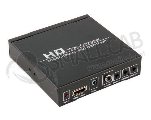

I've been using one of these to output to a modern monitor. It's cheap and works great.

Is there such things such as composite to DVI/VGA/HDMI converters that work well?
I was hoping there would be a way to do this without the additional hardware of the OSSC or whatnot. My goal is not to buy an OSSC or some extra hardware for every separate setup I would use.
How is that device? Does it introduce lag?

Those scart to HDMI boxes are pretty bad, you'll have all sorts of nastiness that comes from it processing 240p as 480i.

I'm happy with the one I have. No lag that I can notice, which isn't surprising as it's a simple conversion. Crisp image and compatible with every combination of game / monitor I've thrown at it. No fuss, no settings to mess with, just simple and effective. Crisp image, just no scanlines. Not as good as an OSSC but much better in terms of price to performance ratio.

Yep I didn't think they would be acceptable.
