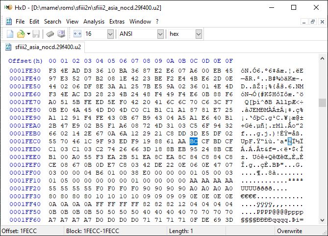

Asia NoCD has been dumped. Looking at differences between it and the Japan and US bioses, the only differences are
0x1FECB, which controls the region
and
0x1FECC, which controls if it looks for a CD or not. Normal is BD, NoCD is BC.
Desolder the flash, make the change, reflash it and solder it back?
I haven't actually tried this, so I don't know if there's some catch involved.

Yeah just reprogram your 2i bios with a nocd version. No need to do superbios in your case as 2i technically has no protection.
Thanks. Is there any video on this by any chance ? I do have a chip programmer and some soldering experience to pull this off. Not sure which chip to replace here.
