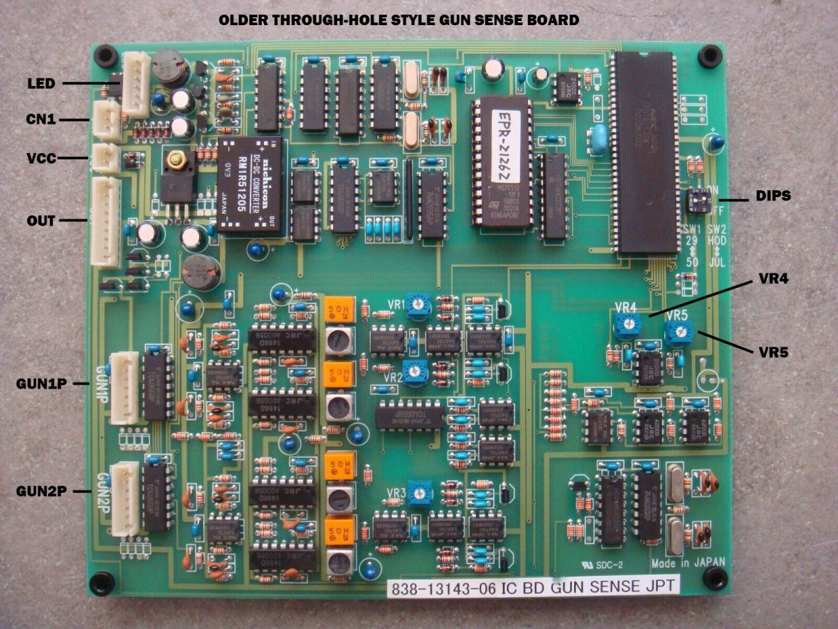

I beleive there is an FPGA on the gun I/O board, or some other sort of CPLD.
There isn't
it's got an EEPROM and a NEC CPU and the rest is basic 74 series logic or analog ICs.
newer boards simply use an SMD version of the NEC CPU with the code embedded.
I have many times before. most recently in my write up here: http://solid-orange.com/1611
which is linked on the first page of this thread and on at least 3 other posts :P
@rtw has recently done some testing using a scope to look at the data on the various pins.
LED chain is confirmed to be a simple addressable set of LEDs it's basically just got a flip-flop to turn them on one at a time from a simple pluse signal.
more research needs to be done on the actual data coming off of the sensor but it's essentially analog data which backs up the little technical info that could be gleaned from the patent about it using IR region/motion/intensity to determine position.

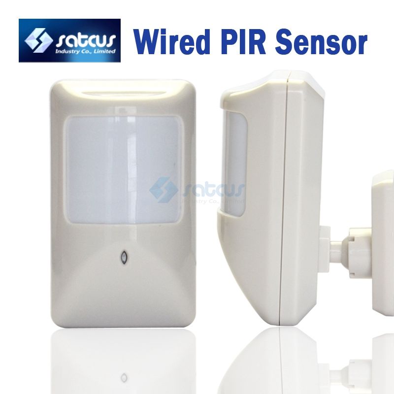

EDIT: @Zebra, YES that's exactly the technology I was referring to with the IR based Alarm System motion sensors.
it's basically just a more tightly calibrated version of one of these:
it's all the same principal technology, but the alarm sensor is designed to detect ir changes across a large area, the gesture setup is designed to detect it over a small area, and gun setup is simply designed to detect it with greater accuracy.

@Zebra thanks for your info on the guns much appreciated.
All the dumped images from the gun boards are in hotd2 BIOS in MAME.
The CPU that these gun boards is running on is not exactly a powerhorse :)
Code:
 Gun board info:
 "838-13143-nn IC BD GUN SENSE xxx" board, D78213 MCU based, was used in big number of Model2 / Model3 / NAOMI / Chihiro / Lindbergh games.
 known firmwares:
 EPR-20006A  oldest revision?
 EPR-21262 - older revision, used in: 04 HOD (House of the Dead), 06 JPT (Jurassic Park The Lost World).
 TG12      - newer revision, used in: 08 SPY, 09 SPY UR, 11 SPY UR EXTRA - Confidential Mission and later games, backward compatible with older games as well.
