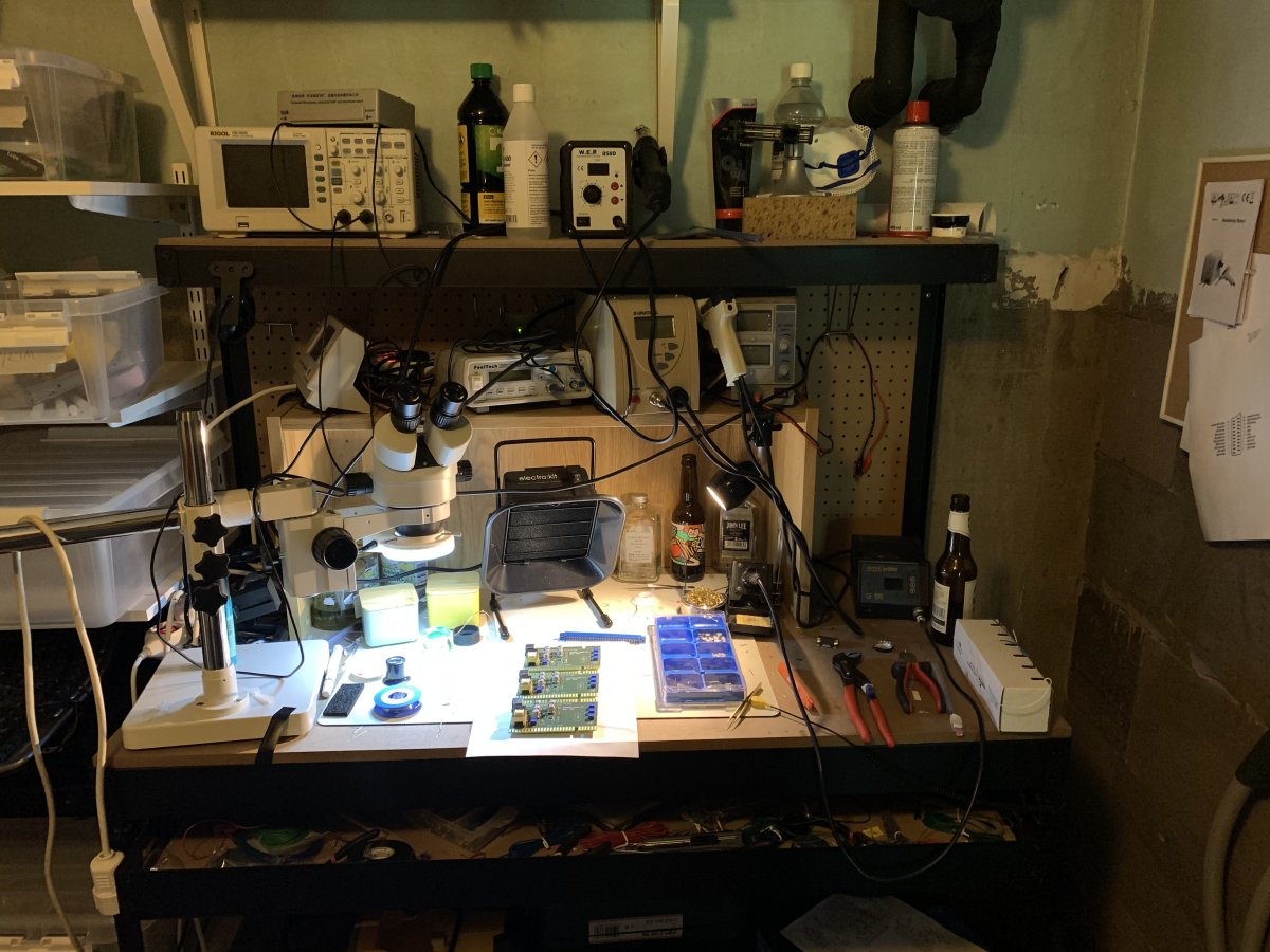

Well yeah you definitely need something for the fumes. I have this cheapo one that uses carbon filters and works better than nothing at least (old pic)

As you may see from the whisky and beer bottles in image above, I have other vices for boring work like this…
Is that in a garage? I only ask because (not sure how true this is) I've read its best to still have some kind of air circulation even with a fume extractor.
+1 the Hakko, I use that with one of those small cheap Honeywell fans in a cramped workbench.
Basement, but i do have an exhaust-fan at groundlevel close to the ceiling of the room, so theres _some_ circulation. Most stuff should probably end up in the carbon filter though
