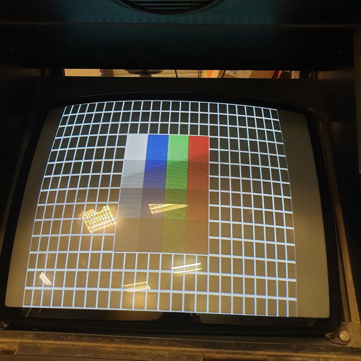

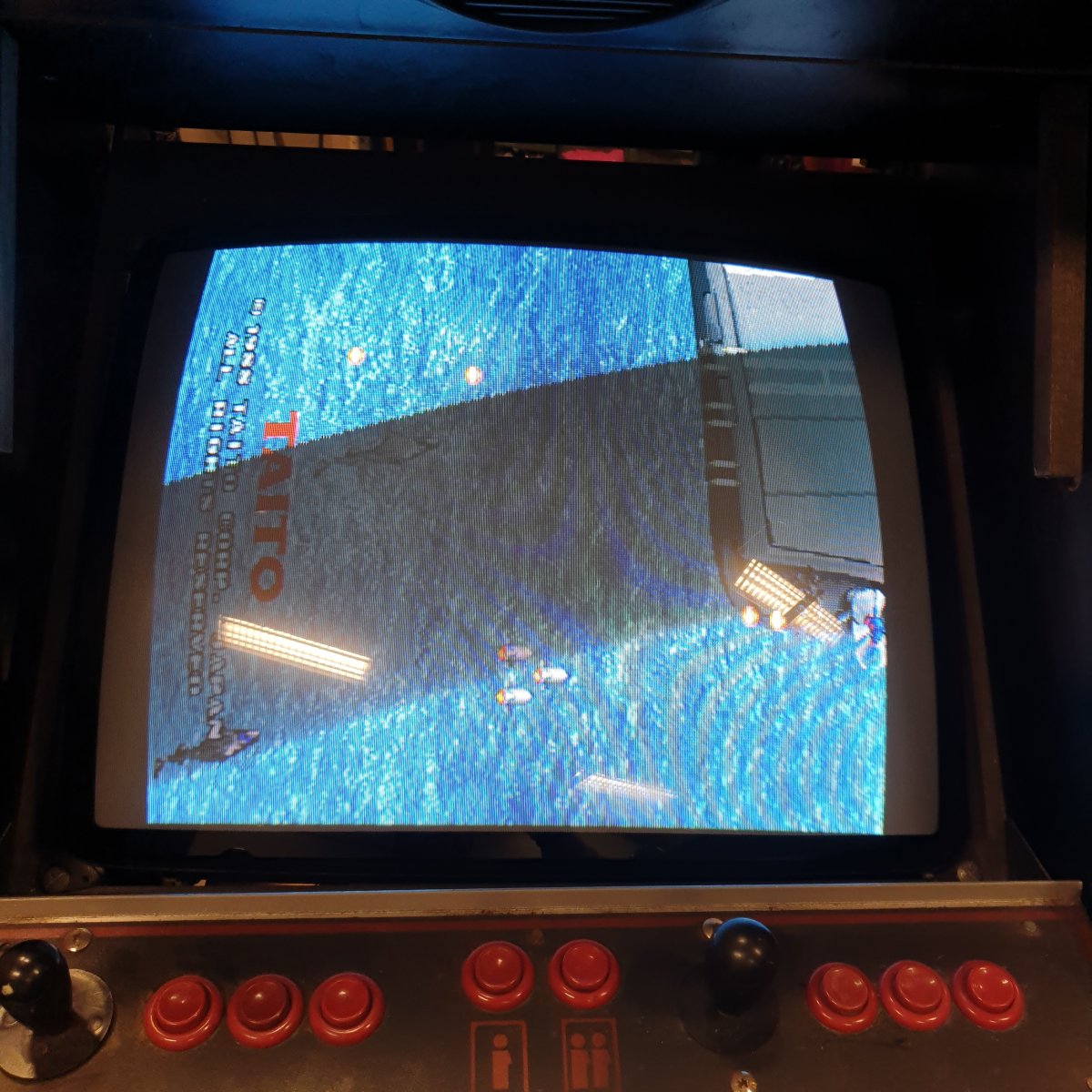

I'v just replaced flyback transformer and a recap, fired it up successfully (I guess cabinet/monitor haven't been working for 15-20 years) so never seen it running myself.
The 130V seem to be ok (The monitor is powered via a step down transformer so 110V (where it should be 128V), but afaik this should be ok (seen other running with this voltage), but can't seem to get the width to fully expand.
I did adjust the coil on the picture as I thought it was the coil for adjusting width, but it's the coil for horizontal linearity. Later found out it might be related to what hantarex names a "bridge coil", but trying to adjust this one it seem stuck, and it started to crumble when trying to move it, so just gave up on that.
Seem to be able to adjust things from the remoteboard and the pincushon board, but not to the full width of the monitor
Is there any known replacements for those bridge coils that is available today, or maybe other chasis that have these exact coils ?.
If anyone have any available it might be of interest, also if there is any other tips on how to sort this issue it woulf be appreciated.

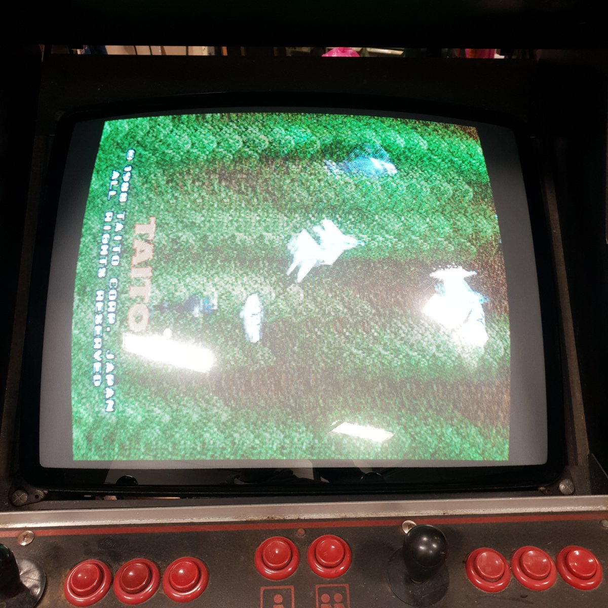

The game used for testing is a vertical shooter so orientation is wrong on the game on the pics :)

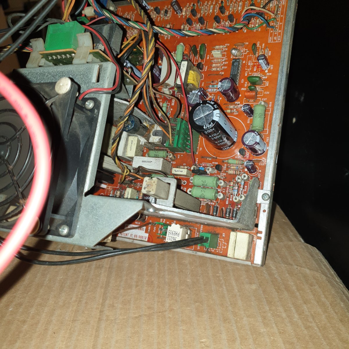

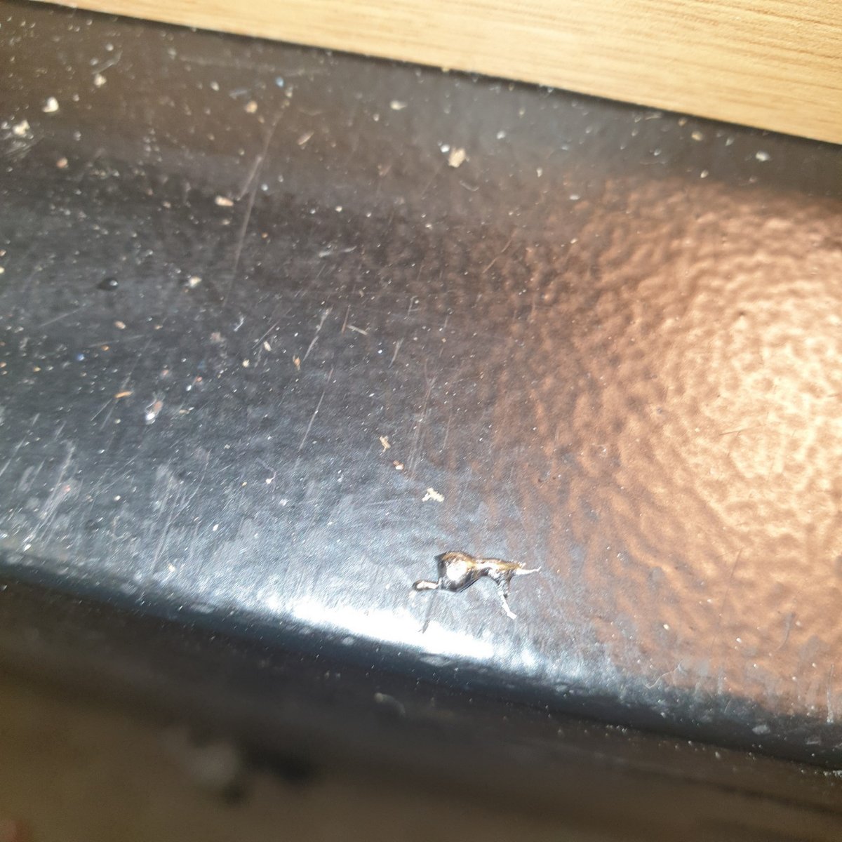

Got it back up and running again, the lightbulb test seem to have "failed" due to to low voltage from the Hantarex us 250 when it gave in 134.4V, hooking up a 110V ac transformer made it come up with somewhat correct voltages, however the main "culprit" was propably a stray soldering "blob" that was sitting underside the board :(
However I'v now added another cap in paralell and have about 0.463mfd on the C37 cap, but still having trouble with my width.
Anyone know if the IC 2 might cause these troubles as well ?., nothing apparent wrong with it, but iirc I'v seen someone had trouble with to much width caused by some errors in this chip (but not 100% positive i remember this correctly).

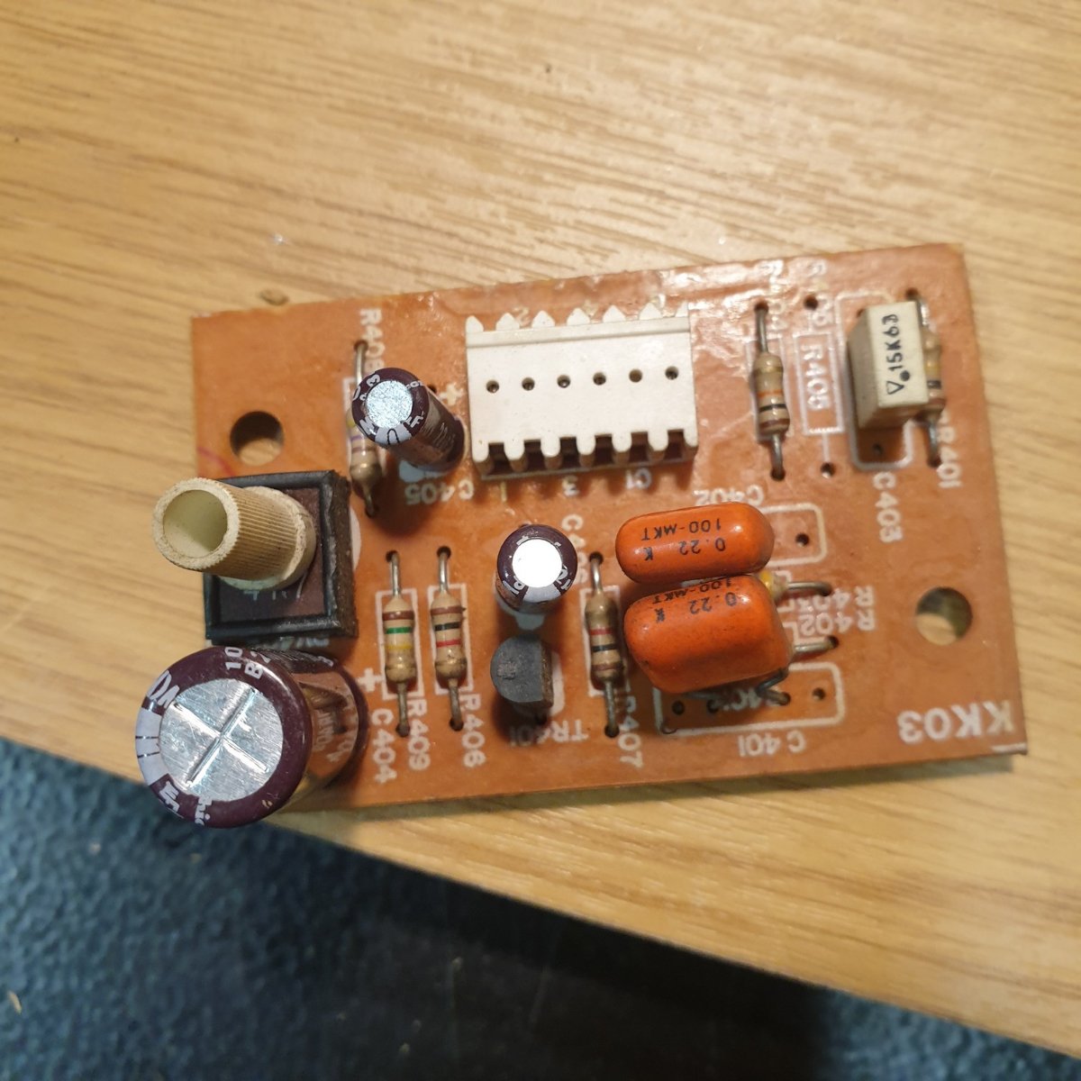

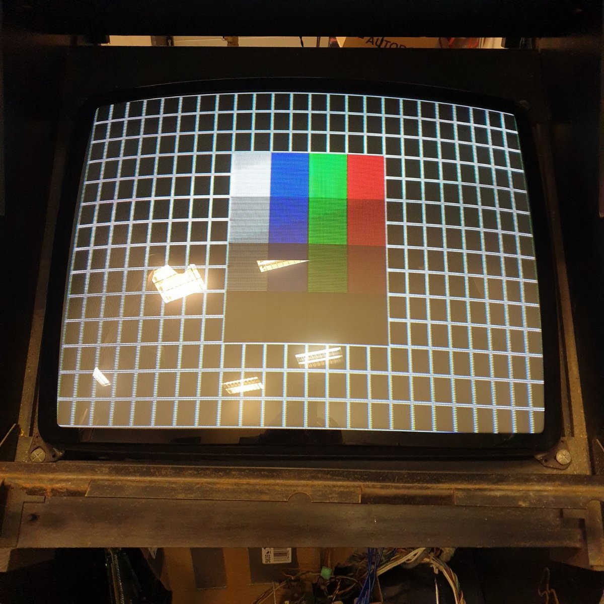

Just thought I'd give a final update on this if anyone else experience this problem in the future.
Finaly was able to sort out the issue and turns out it was due to a short between the legs of C405 on the pincuchon board, still some adjustments to do but seem to be fully working now :)
