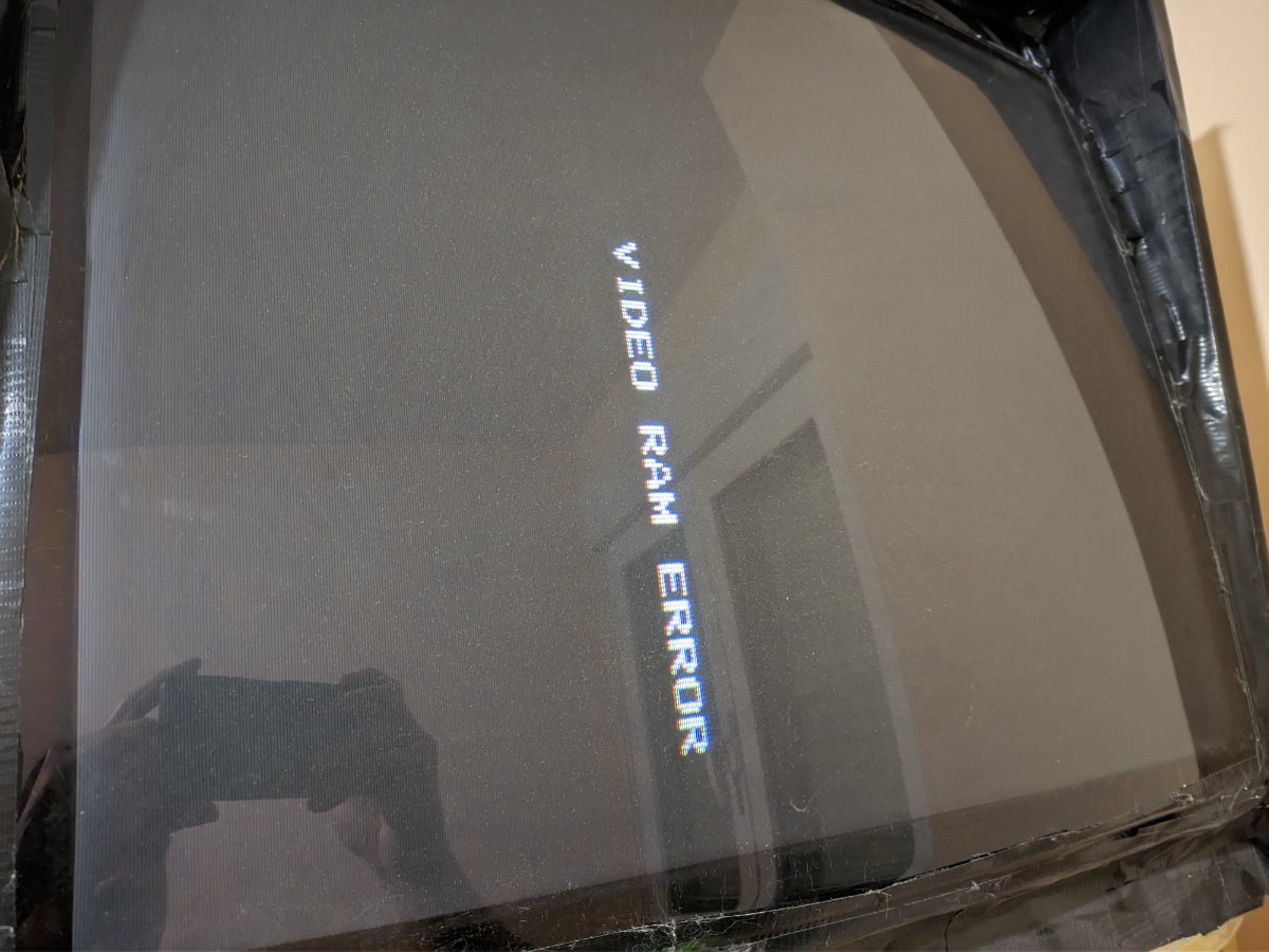

Tailsnic Retroworks Champion Joined Jan 8, 2019 Messages 985 Reaction score 1,013 Location Spain Apr 17, 2026 #1 Hi. Can anyone tell me where is the VIDEO RAM zone on TP-018 original board? Attachments PXL_20260417_224700964.jpg 139.5 KB · Views: 27

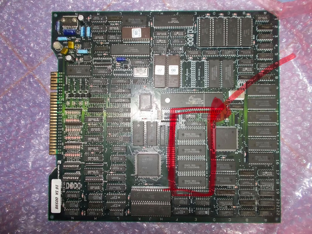

Tonitoxarcade Professional Joined Nov 20, 2018 Messages 307 Reaction score 164 Location Barcelona Apr 18, 2026 #2 Start by looking at this RAM section Attachments IMG_0018.jpeg 562.6 KB · Views: 37
Tailsnic Retroworks Champion Joined Jan 8, 2019 Messages 985 Reaction score 1,013 Location Spain Apr 18, 2026 #3 Alright
Tailsnic Retroworks Champion Joined Jan 8, 2019 Messages 985 Reaction score 1,013 Location Spain Apr 18, 2026 #4 Tonitoxarcade said: Start by looking at this RAM section Click to expand... Thanks!!! 2 of those 4x 62256 rams had databus error!!!!
