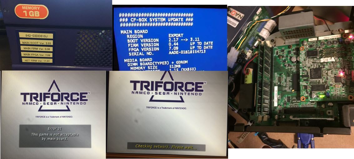

I must be losing my mind. I didn't have to change IP's. I just booted it back up and the IP is pingable. Whether the IP was clashing with another device a couple days ago, it isn't anymore. That's a good thing.
I was in the process of testing different jumper settings, swapping out DIMM and even the network board. As @Mitsurugi-w suggested, run transfergame even without the 'Checking network' message gets me to the flash update while the Error message is showing.
Thank you all for your feedback and insight on this issue.
Here are some pics of the journey for your entertainment:
Honestly, I don't think there really was any problem.
Here is what I did as soon as I received the console:
1. Powered it up with the GD-ROM to verify it actually works. (It turned on)
2. Powered it up with Virtual Striker GD-ROM (It ran)
3. Took a Zero PIC from a working Triforce, popped it in, Changed SW1-2 to OFF (Same as SW1-1)
4. Powered it up and changed Network settings to Ethernet and adjusted IP values
5. Exited test menu and rebooted
6. Error 31 appeared
7. I tried pinging the IP address that I entered in the test menu (could not ping)
8. Swapped DIMM, swapped Battery, Changed Jumpers to different orientation, burned new PIC (worked on other Triforce), etc.
9. Waited a day to fester and think about why it wasn't working
10. Powered it up again and pinged the same exact IP address I gave to the triforce and it Ping'd.
11. I ran transfergame even with the Error 31 message on the screen and it flashed.
During step #6 I did actually try to run transfergame but because it was unpingable at the time, I was stuck. But for whatever reason unknown to me, when I tried steps 6-7 again last night it ping'd.
So I have no idea but for all the years I was taught to troubleshoot error messages, step #6 stopped me from doing anything further because it was an error.
Yeah the error message drove me nuts until I realized the older firmwares did not have the checking network message at all. I think I even told Darksoft how frustrated I was in a fit of rage. lol. But it all works now for me too so glad to pass on the knowledge.
