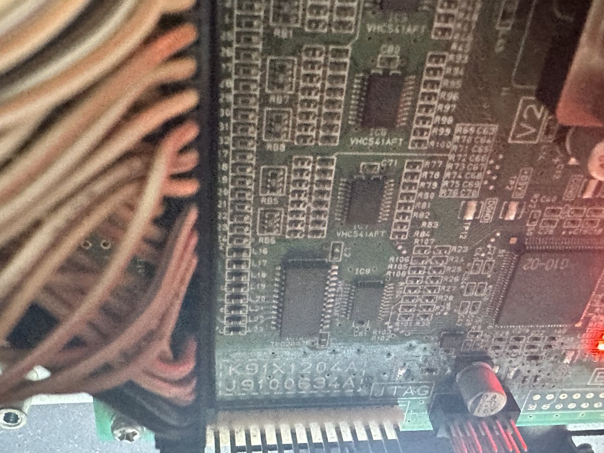

Hey all, spent the day troubleshooting my vewlix c with ttx3 multi. Narrowed it down to the fastio.exe not listed as running after configuration of fast I/O on the multi and “possibly” an I/O that won’t work.
I’ve read through Artax’s readme file but it doesn’t list specific models. Anyone know if this Taito model is compatible?
K91X1204A
J9100634A
It should work. How is everything connected on your end?
Could be one of those I/O's that requires external power to work...
Just got it working about an hour ago. Had to reseat all of the cables, not sure which one but something was loose.
