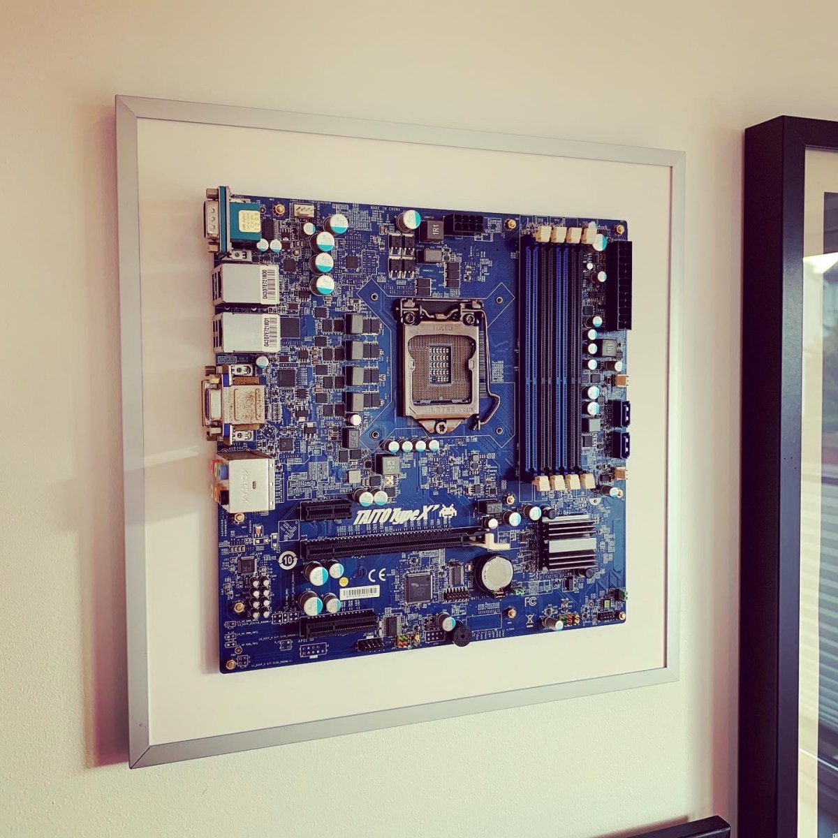

Fair enough. How are your soldering, or should I say de-soldering skills? Those pins look very small and numerous, not to mention multi layer pcb too. It might be better to replace the x3 mobo with an off the shelf Intel P67 mATX board which you should be able to find cheap, that way you can do a straight swap. That or find an OG board, I think Aliexpress has them mobo only.
Absolutely 0 soldering skills. But I got in contact with an IT repair shop, said they would replace the slot for 20 euro, I guess desolder the pins and solder in a new slot, so going to try that.
If it works, great, if not, guess I am going to get a new mother board and swap the x3 ones. Will have to ask nam9 where he got that sweet frame if that's the case.
