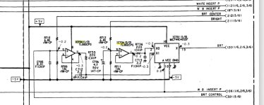

Recapping the BK board did not go well - Brightness is done by IC701 and his buddy IC704. When they are not doing their thing you get lots of random overloads. Guess who gets lots of random overloads...
C706 and R711 are supposed to be in parallel into IC704.
Unfortunately they forgot C706 (4.7/50) when they laid out the the PCB, so bodged it on afterwards - re-bodging the bodge is where the fun started.
C706 should be in parallel with R711 - but I've destroyed R711 with too much heat, luckily the traces and pads are OK
Negative goes to Pin 4 of IC704 (-5v)
Positive goes to Pin 3 of IC704
R711 is open because I've burned it up - so the fix is to replace R711 - this is easier said than done as you can see from the pictures.
This has a couple of interesting effects
1) Brightness control is inverted (0 = full, 4000 = off)
2) the overload protection sees "too bright" and triggers all the time, sometimes within a few seconds of power on
So 3 weeks for delivery of a tiny resistor the size of a grain of sand, then an hour of work to strip all the other components, replace R711, put all the other components back where they belong, and put C706 back in parallel.
