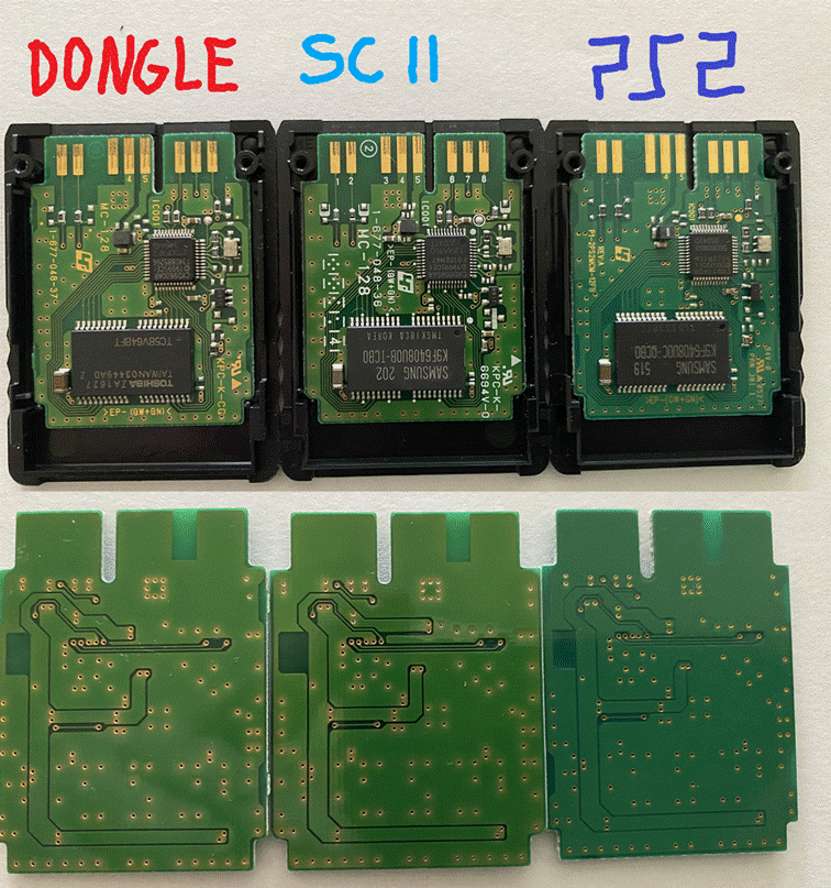

I don't own a soul caliber memory card or i would tinker with it and post a pic
SOUL CALIBUR II记忆卡适配器
PS2记忆卡
namco system加密狗
这3个产品的电路板根本没有任何区别,因为我在二手市场阅览过很多这个电路板,如果你要从电路板来寻找突破口那都会是徒劳或者无用功,这是一个错误的方向.
这三者我认为唯一区别比较大是:
1.PS2记忆卡可以在卡槽1和卡槽2被读取,它仅仅是一个记忆功能的作用,同时两个卡槽兼容ps1记忆卡读取和存储。
2.SOUL CALIBUR II记忆卡适配器只能被插在卡槽2,它仅仅是一个卡槽2的记忆功能。
3.namco system加密狗只能在卡槽1被识别,它负责的是整个游戏的运行,我认为他也是游戏rom资源的一部分,在ps2上面应该等效于MX4SIO
I made some pics. to compare the hardware. Hi res. image here -> https://mega.nz/file/JjExQRSI#QIMOVFF8fBaIMzFgebzaMrp_27sJd1UvQIGOyT1crVk
Even though the cards themselves have the same hardware, they differ on the keyset used, like the "COH" model used on System 246/256. What are the models on the backs of these cards?
Also, I've read that the SCII card doesn't use the standard filesystem. Putting it into a PS2 basically destroys it (or so I hear). Would be great to get a dump of one of these to study, though.
I have one that someone let me dump and im trying to figure it out also
