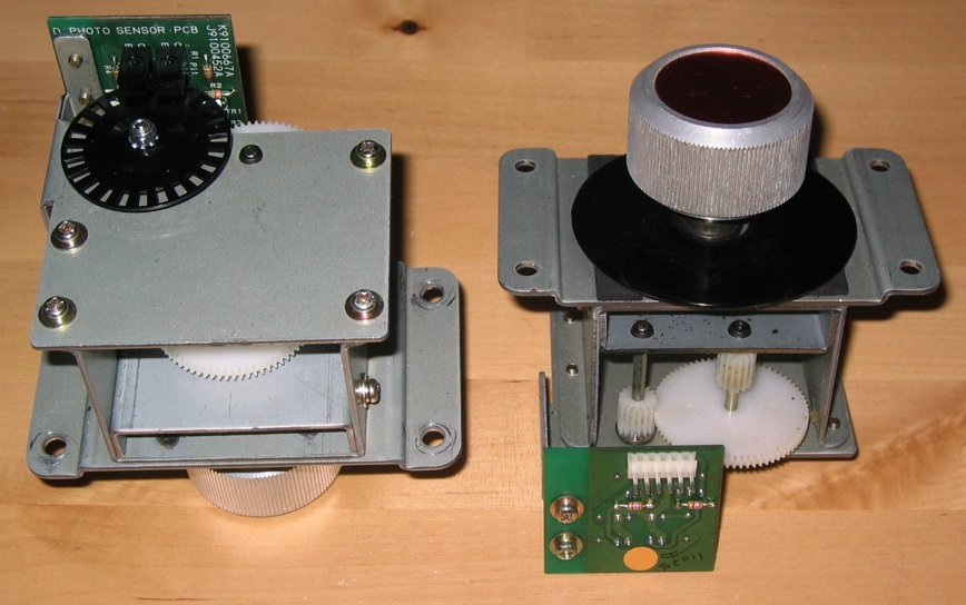

The F3 is designed to work with any of the Taito 4-Gear Spinners (this includes Arkanoid Spinners, the Ghox spinner etc.)Has there been any update on spinner options? anyone found something that works or is compatible or can be adapted?

Capcom and Ghox spinners FTWThe F3 is designed to work with any of the Taito 4-Gear Spinners (this includes Arkanoid Spinners, the Ghox spinner etc.)
I've compared the circuit and gear design of the Capcom Spinner and it is cross compatible, which means that the repo should be as well.

Sadly I don't think those will work as they emulate a mouse input for PC if I'm not mistaken. I doubt it would work, but the most lucky option would be if the spinner wires could be wired to jamma instead of their PCB. No idea if that spinner would create the proper pulses for an F3 like the happ red board does.
I was more hoping in theory the 4 wires from the spinner to USB board carried pulse signals eliminating the red board entirely, but I don't want to theorize too much. Hopefully someone else knows for sure.So could I use one of those arcade1up noname spinners and hook it up to the happ red board?
