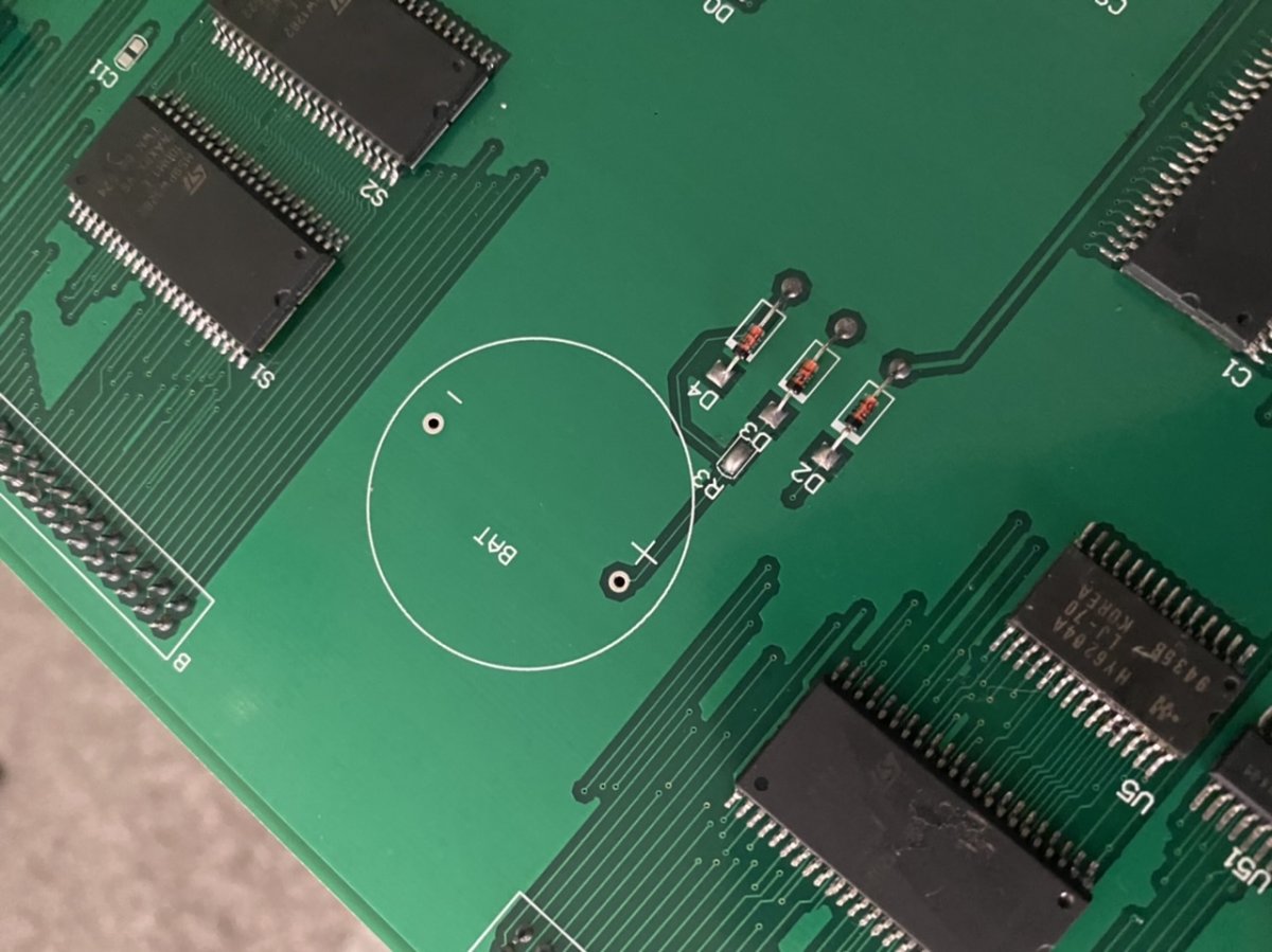

Hi @lydz007 , I just received my SSV multi and been really enjoying it.
I have a question, I noticed there’s a spot for a battery install. Does this allow to save high scores?
If so, what battery should we be using CR2032?

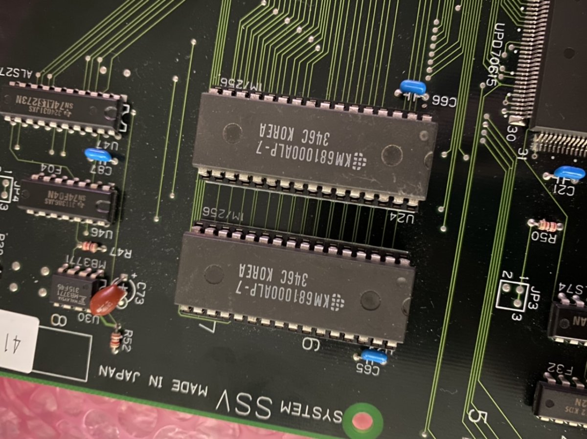

I received mine today and would ask for some directions. there were two EEPROMS sent with it, no marking though. Games are changed by Dip switches or/and the EEPROMS?

Can anybody tell me what the EEPROMS are for?
I could make it work and figured out to change the games, cannot start ULTRA X WEAPONS though...
They are RAM chips. Just swap the two socketed ones on your motherboard with those and you’ll be good to go.
Thanks a lot. I saw that there are more EEPROMS then two on the Mobo. Which one should I change? Since the sent EEPROMS are not labeled, do they differ?
Don’t change the EPROMS change the RAM.
Sorry for being unprecise, I meant RAM of course.
There are five sockets on the mobo with RAM in it and I am not sure which ones to change.
The positions are U23 and U24, as well as U34, U35 and U36. You mean U23 and U24?
Thank you for your help.

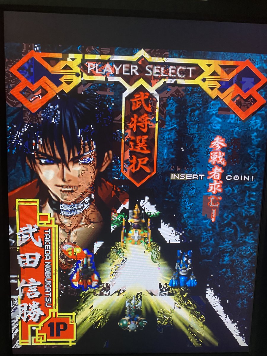

@lydz007 My SSV Multi just arrived but didn’t come with RAM chips. As such, Change Air Blade is the only game that works properly. Ultra X Weapons doesn’t boot and the two Vesara games have graphics corruption.
I’ll order in a pair of the RAM chips and cross my fingers - hopefully the graphics corruption in the Vasara games isn’t from something else.
