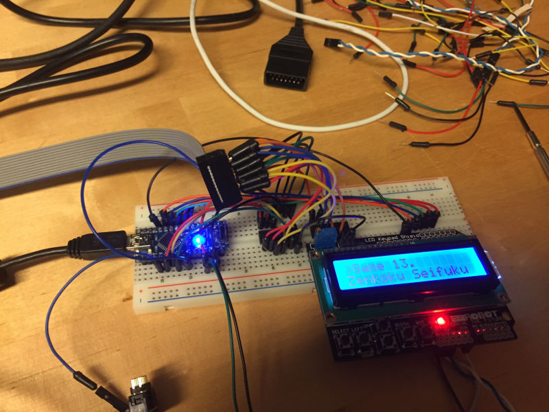

I have been thinking that it would be nice to have small lcd with buttons to choose the game. I have different screens, with buttons and not, and lots of different microcontrollers. Game selector jumpers seem to just connect pull downs so I was thinking just to ground the signal using the microcontroller (or using couple of 4066 as switches). Or is it pull ups?
In startup, microcontroller could read the previous selection from eeprom and set the game selection after that. Problem could be that is microcontroller fast enough to initialize pins before multicart polls the game selection? This has to be first checked that they are not floating in that point. If they are, I think they must be either pulled up or down and not have game for that number in the sd card. Then after delay, user could choose games and press starts and board could be resetted.
Is it that simple or am I missing something? Its 4AM and I'm ready for bed :D

That's almost exactly I was thinking about doing, even got same LCDs. Although I was thinking about using pure atmega328 in 8Mhz mode to enable 3.3V operation and use hct4066be's instead of transistors and powering them from the multicart or the motherboard. Actually I also should have somewhere arduino micro's that are 3.3V version, I remember that they were cheaper than just buying the microcontroller chip.
This gave me idea that if multicart boots always the game its has if the selection is invalid, why not let it, I anyway boot the last game most of the time. Then when choosing new game to load, set the selector and reset the mb.
EDIT: actually LCD need 5V, so using 5V part + 2x4066 seem ok solution.

I'm going to test the selector with external power, then I'm going to solder the reset wire.
Speaking of which...how does the reset work? It seems that the wire for the auto reset is connected to chip that is some sort of voltage monitor and there it goes to SMPC. Line is pulled down to ground by resistor and jumps to 5V once board boots. So reseting would be grounding the signal (through resistor for safety)?
