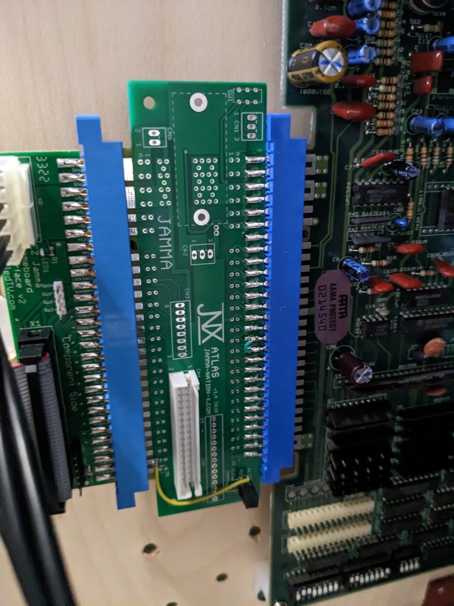

I have a JNX adapter in here that I tried with on.
With TMNT it's no problem bc start isn't even used. I just don't wanna cause myself problems with any of my other boards/systems.
Hmm, I'd test it out with the games you have because while it can cause a problem with some PCBs (F3 mentioned), if you flick the button fast, it's OK. Also I think the way around this is to set up the press as momentary, instead of one while held.
