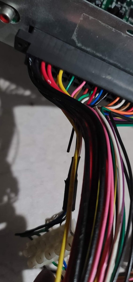

I ended up sticking a Happ Super Harness in there. The difference in build quality compared to the off-brand Chinese one I was using was huge.

Final update on this, ended up cutting some bad grounding out of the video wire that seemed to be the cause. Monitor looks crispy as hell now. Thanks for your help, guys!

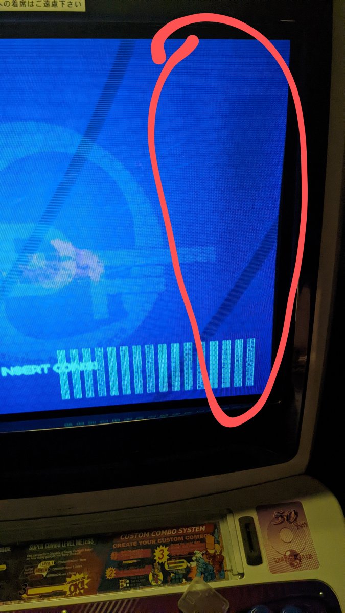

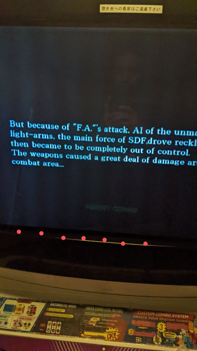

Hi. I have the exact same problem on my New Astro city cab when hooking up Naomi netdimm kit. But my jamma harness looks pretty original and on good shape. Haven’t noticed this issue using my CP2/3. Just wondering what exactly you did to fix it. Any advise would be much appreciated. Thanks!
