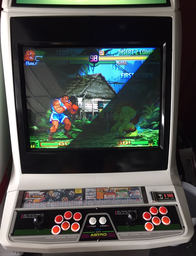

That's the nvram for Alpha 3 US 980904 after getting the red screen, confirmed I could load Balrog.

Okay, managed to get all of the codes working on Alpha3 US 980904
