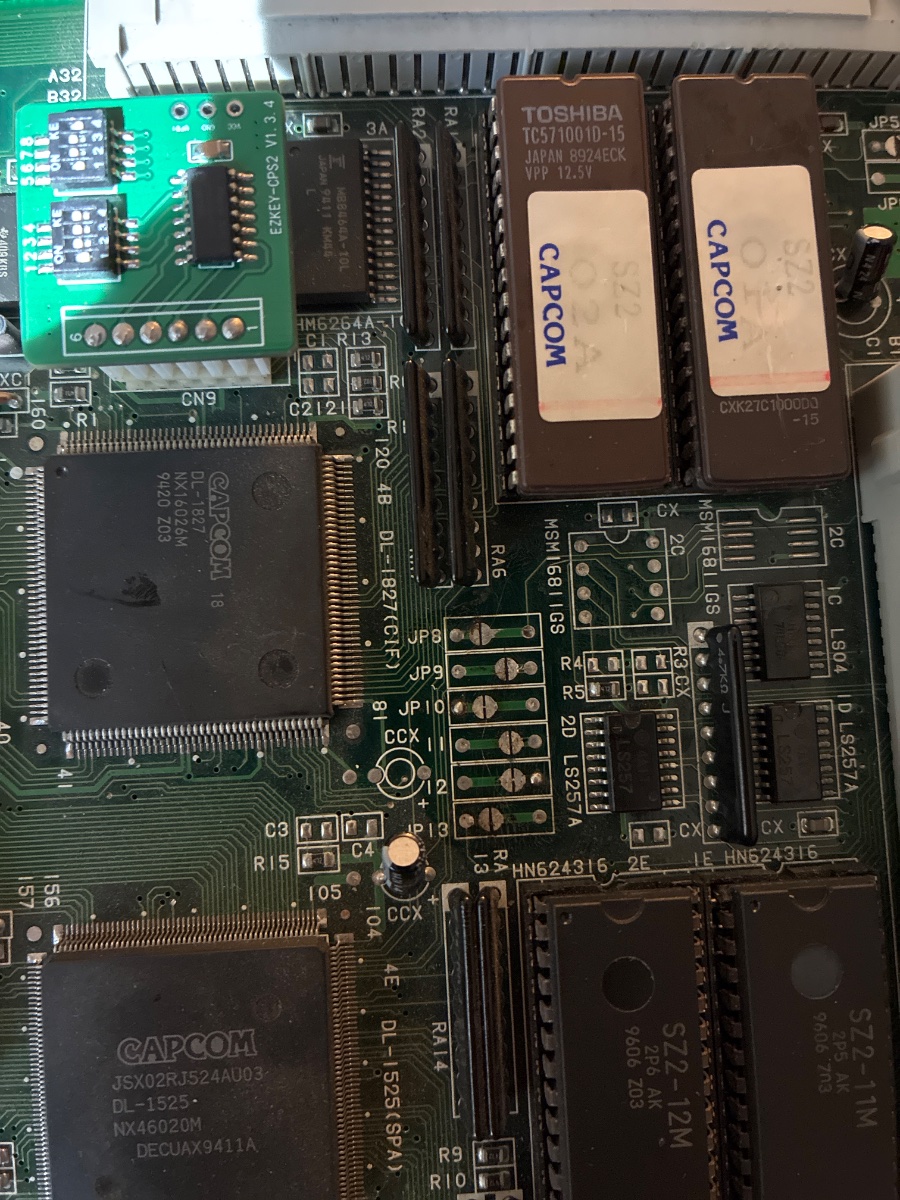

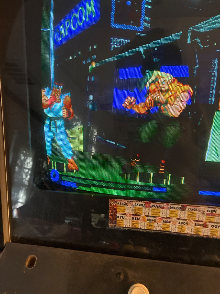

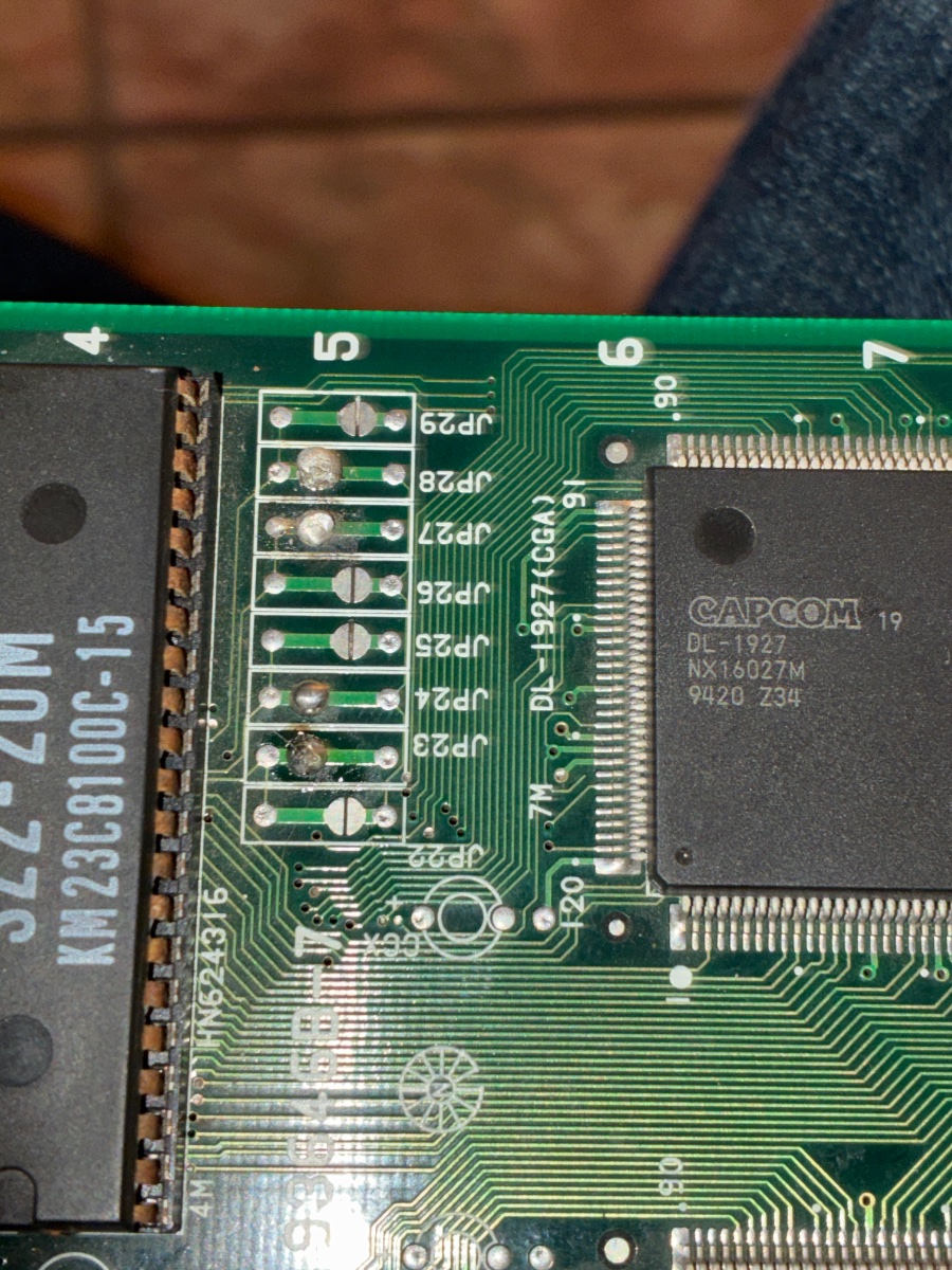

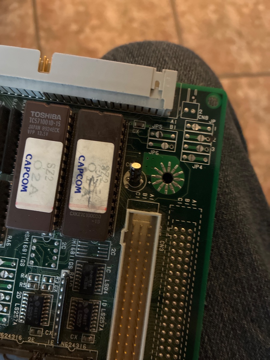

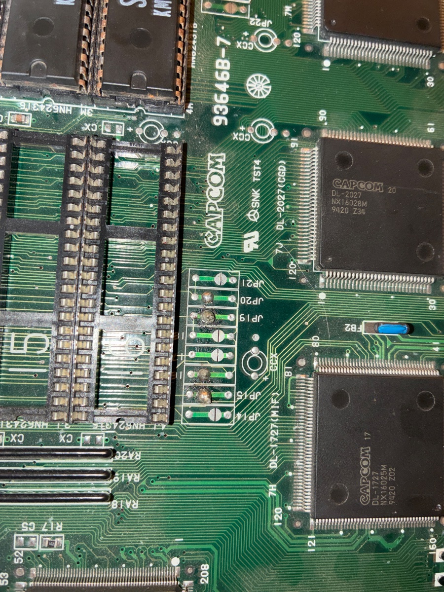

So I recently just did this conversion and finally got it to work but now I’m having audio issues. All the sound effects are working on the menu. But the demo music just sounds like drums and isn’t all there. As soon as I go to pick a character, it just puts out a very distorted noise. I’m also seeing these lines underneath the character. Also the background music during the match is just bass. What is most likely the issue here? I’ll send a pictures of my jumper configuration. I feel like I’m so close to fixing this please help. I had installed an open key by the way. My board is a revision seven, so I didn’t need to solder anything. The only thing I can notice is that there seems to be a very small solder bridge possibly between jp27 and the little bump next to it. Only other thing that stands out is jp5 jumper being a little burnt. If anyone notices anything, please get back to me and let me know any recommendations. I had already tried cleaning some rom chips including o1a and sz2-12m chips
