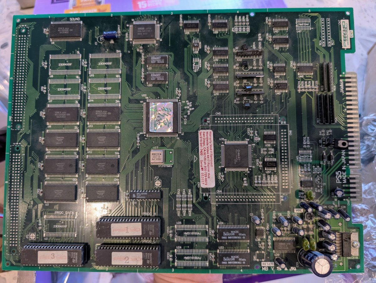

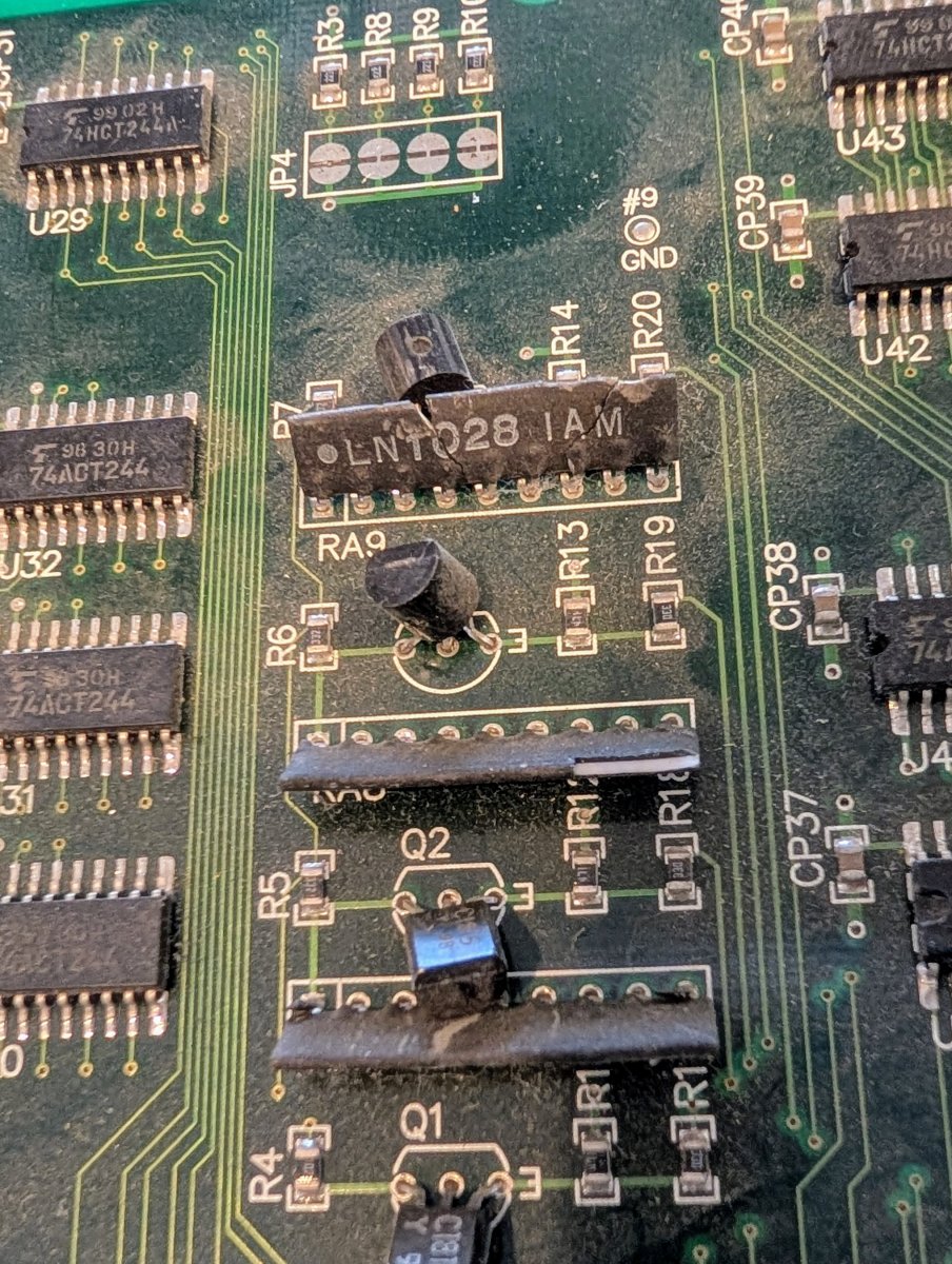

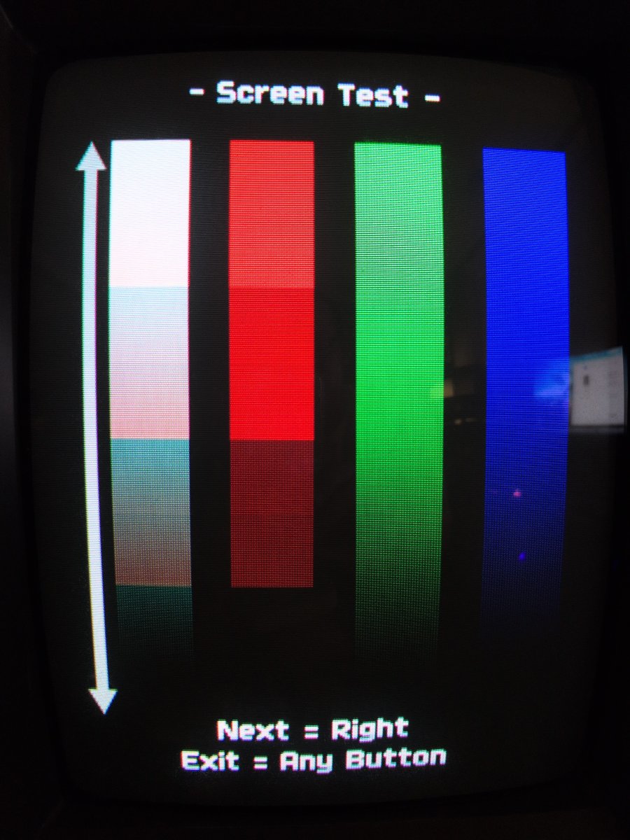

Picked up a Strikers 1945 III / Strikers 1999 sold as working on Ebay. Once it arrived, I realized the resistor arrays range from dinged (RA7, RA8 ) to shattered (RA9). Is that going to be a problem? What bad behavior would I expect from a non-functional resistor array?
I didn't see any behavioral problems after 1 loop except 1) EEP-ROM NG error on boot and 2) it's not saving settings. I'm assuming that means the 93C56 EEPROM at U28 is dead, which appears to be a common issue.
Wisdom from @Hammy :
the color will be washed out
these are color DAC
you can test them with a multimter. each pin should have the same value ohms between pin 1 and each pin
so test with one lead on pin 1
and go through all the pins
with power off OFC
it will step up, like pin 2 will be 0.2k , pin 3 2k , pin 3 22k, pin 4 220k
(example values)
if you can get the values, you can replace them with simple resistors
So I tested. RA7 and RA8 both had each successive pin providing doubled resistance, so the series went:
1k 2k 4k 8k 16k 32k 64k 128k
But RA9 gave unexpected results between 29k-40k for all of the last 5 pins, suggesting the crack totally separated them from the resistor array.
Now that I know how to test resistor arrays for their specs (thanks, Hammy!), it wouldn't be too hard to find a replacement. OTOH, I wasn't looking for another little project (resistor array + replace EEPROM). The seller is local, as it turns out, so I will see if he's willing to fix it or take it back.

You should be able to just replace the array, still a good deal imho.
The fix is pence, you can use regular resistors if you can't find the correct array. ;)
@caius also has one design that may work with surface mount resistors, if not it's easy for him to change it slightly to work.

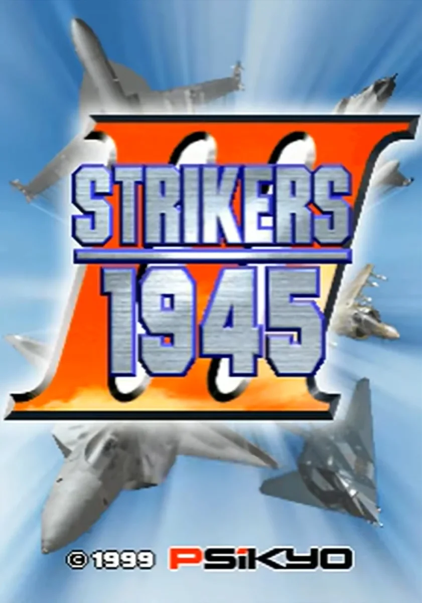

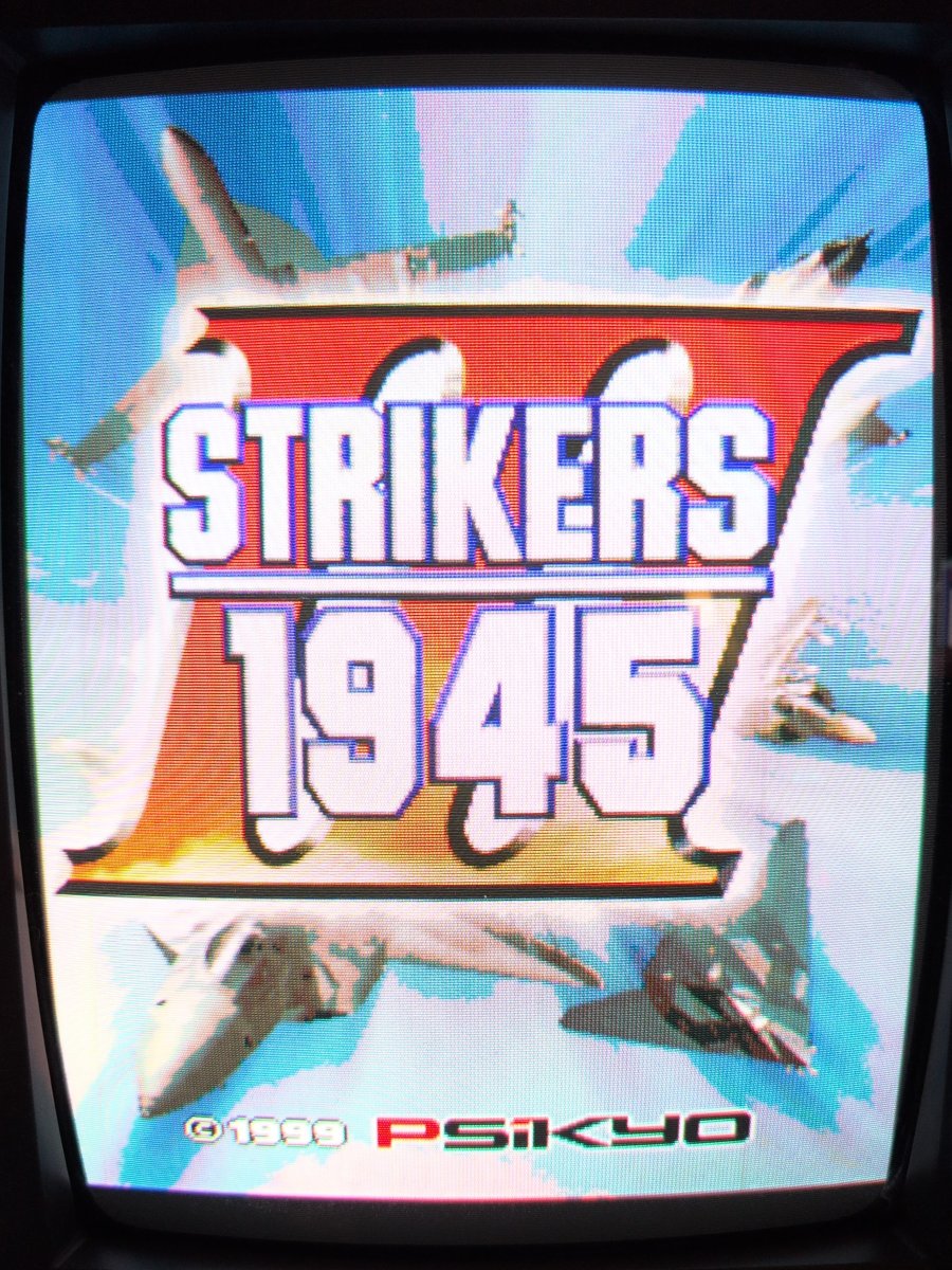

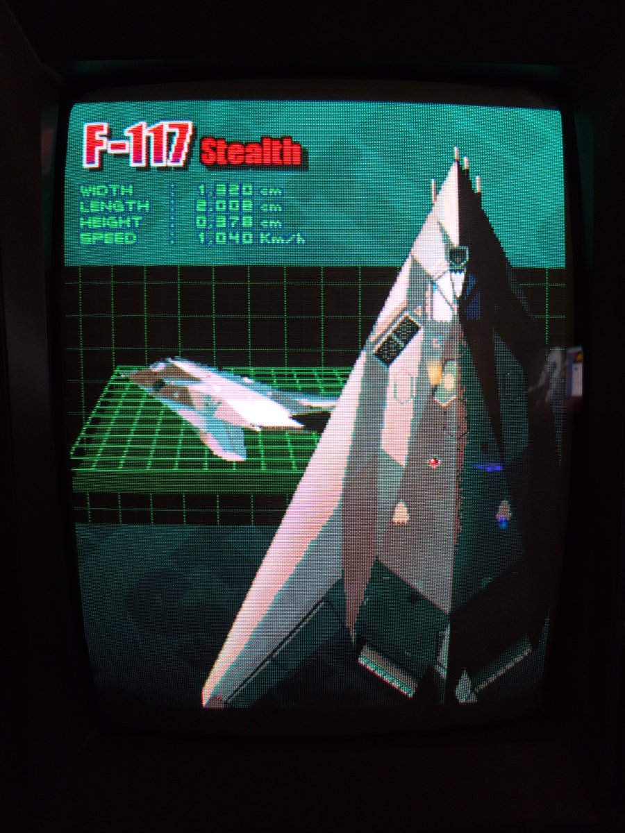

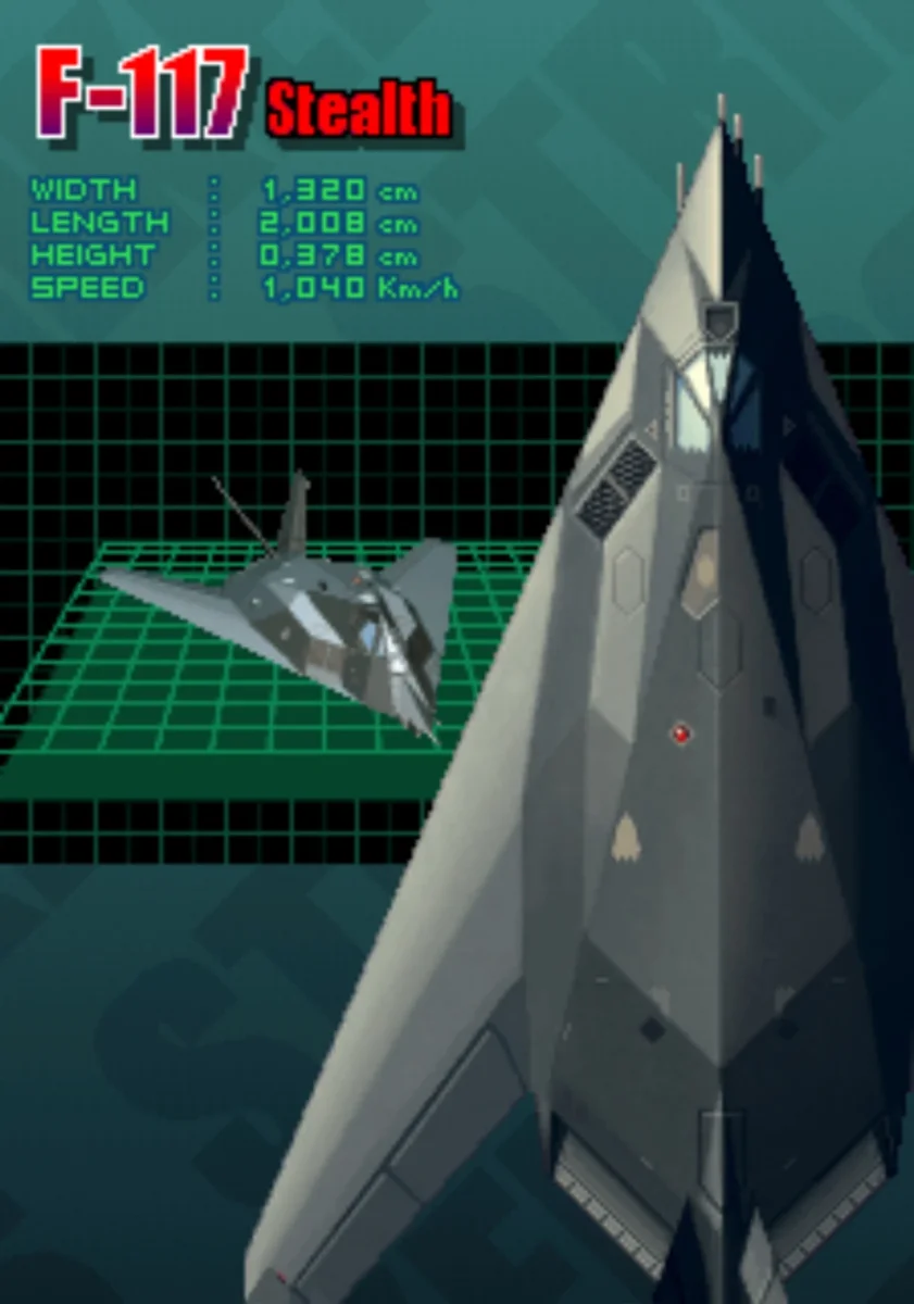

@aje_fr Oh yeah, it's obvious in the color ramp:
With that in mind, and some reference pics, it's obvious the game isn't supposed to be this washed out... or cel shaded 😛
Yes, the parts is a custom resistor array used as RGB DAC, it uses a R-2R ladder inside, I have reproduced many similar parts, the only difference is the resistors values that may change.If you need it I can do a replacement very quick (I should have some Psikyo PCB)
