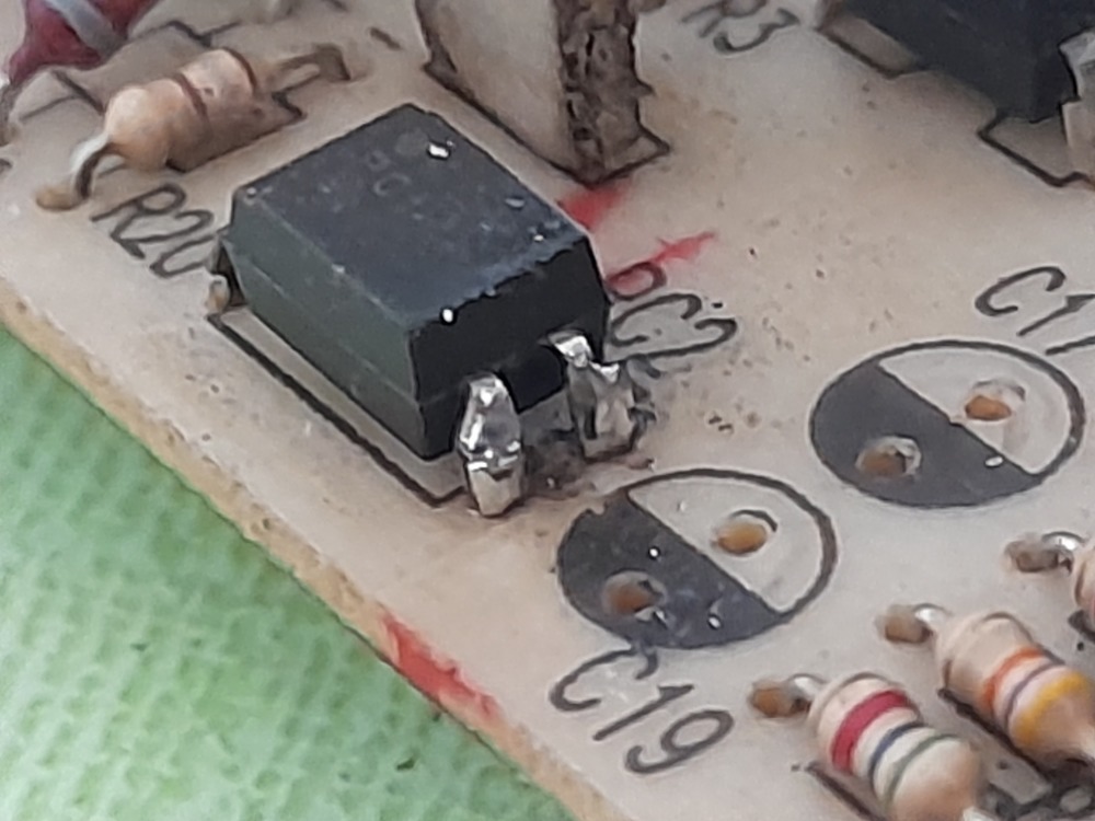

Finally had the time to desolder all the capacitors today and noticed that the two legs of the component labeled "PC2" next to the cap. C19 had both legs soldered together/bridged on the parts side.
Wondering how that could have happened. Is that supposed to be? What is that component? Does not have any description on it.
Thanks

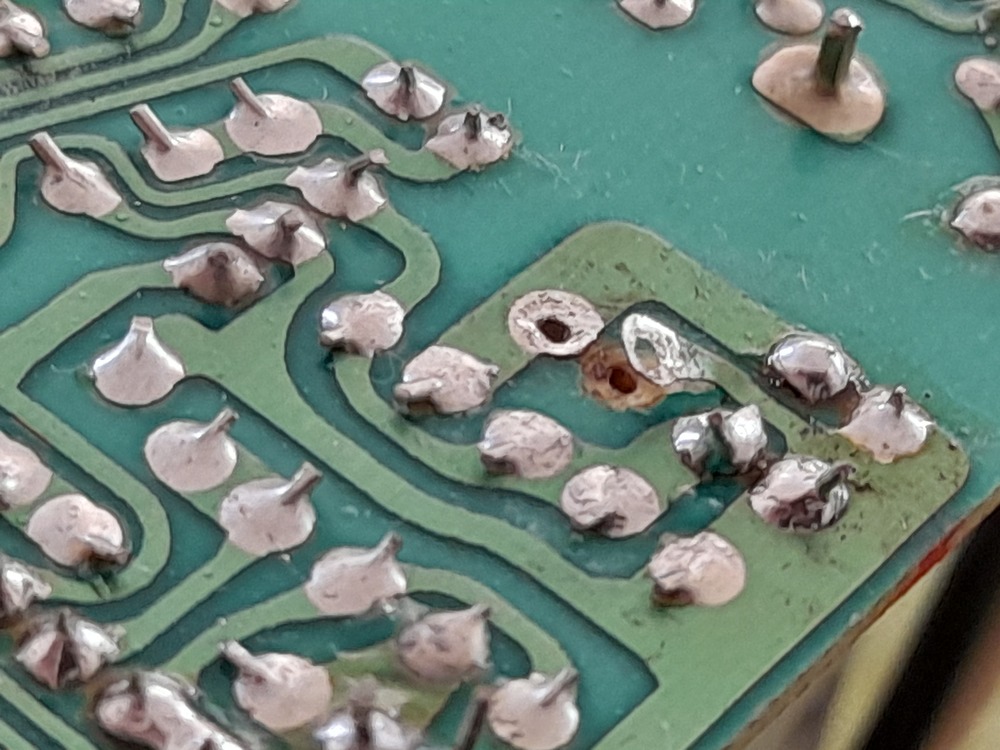

This hobby is constantly throwing curveballs at me. Took my time to place the capacitors, soldered most of them, then realised that at least one trace was damaged:
So my questions are:
-is this an easy fix?
-how can it be done?
-if it is not easy is it safe to just solder the capacitor and continue using the PSU?
