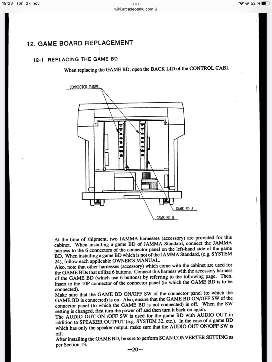

The one I played with had 2x standard jamma connectors installed so it could run 2 jamma games at the same time. Could be the difference between Hitachi and Mitsubishi? Can’t say for sure.

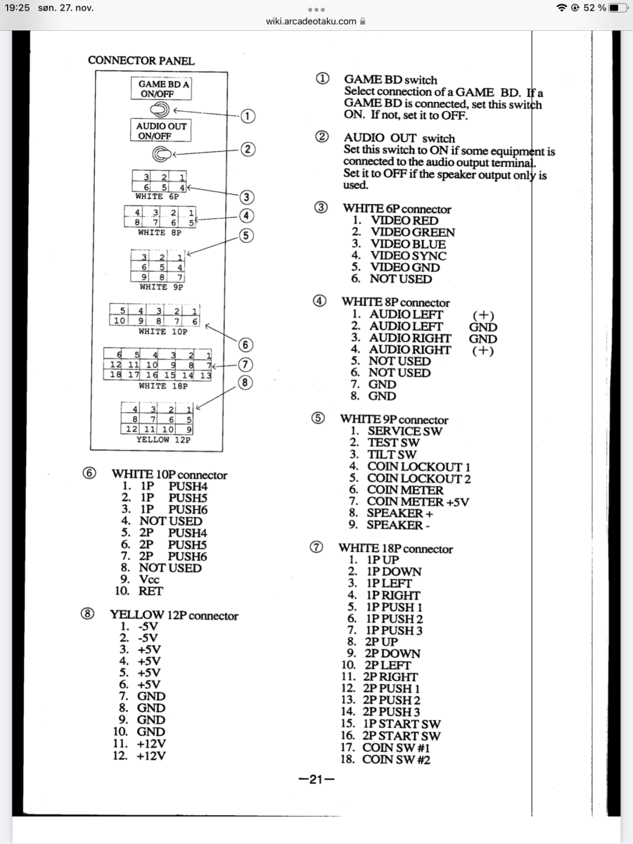

And the pinout for the harness if you are going to make your own jamma harness.
