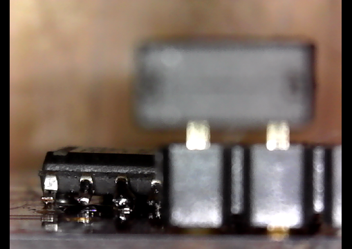

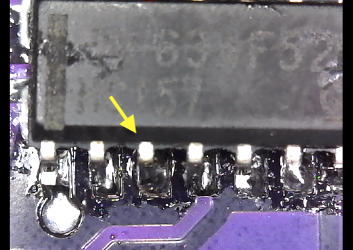

I'm building some off a PCB design I found online. Can't find any pre-built anywhere, so going to see if I can use my hot air station without major injury or property damage.

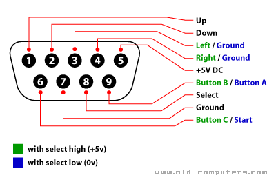

This PCB, with the listed surface mount 10kOhm resistors, 100nF capacitor and a 74157 compatible multiplexor. This is designed to allow the use of Neo Geo or similar DB15 controllers on a MegaDrive/Genesis. No idea how well this design works, not been able to find a lot of information on it. It does have a MS/MD mode change jumper, so fingers crossed it supports six buttons (thinking it does not based on the design, we can see here that pins 2, 3 & 4 from the DB15 side are not connected). But I'll find out!

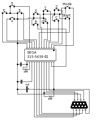

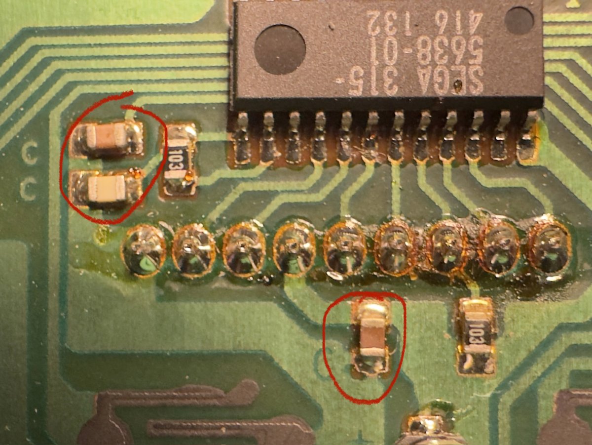

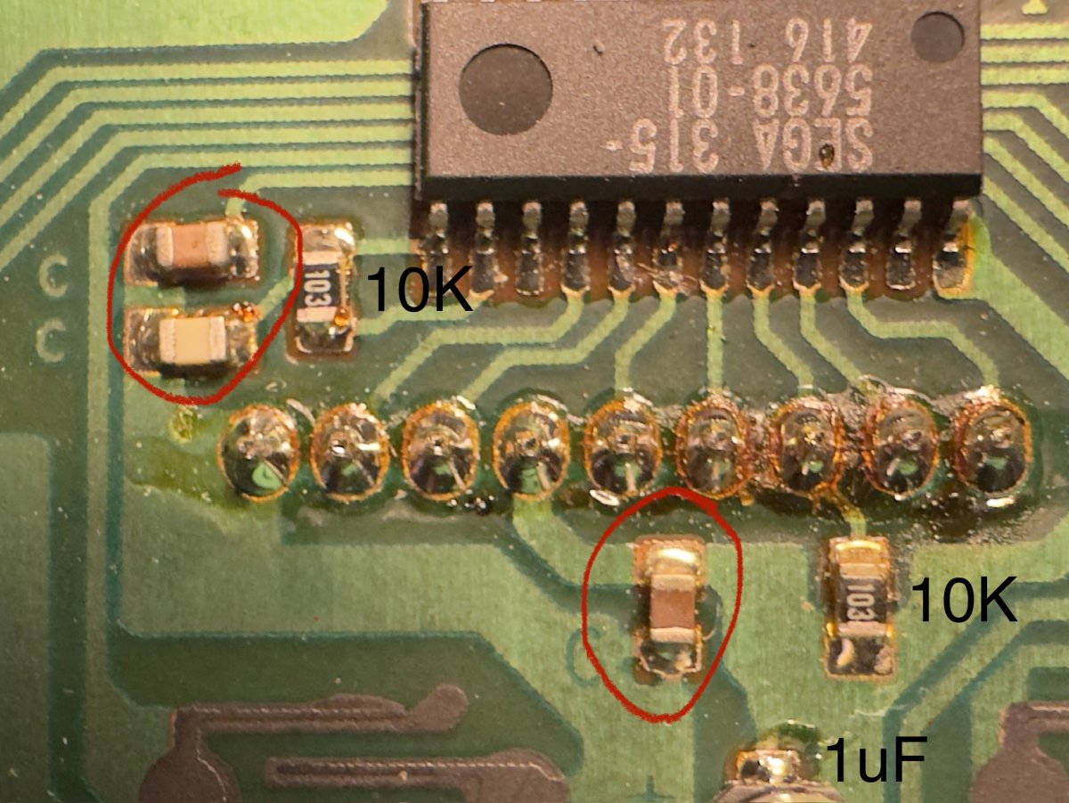

- symbols that indicate a VCC source. But not the polarity or the voltage.
