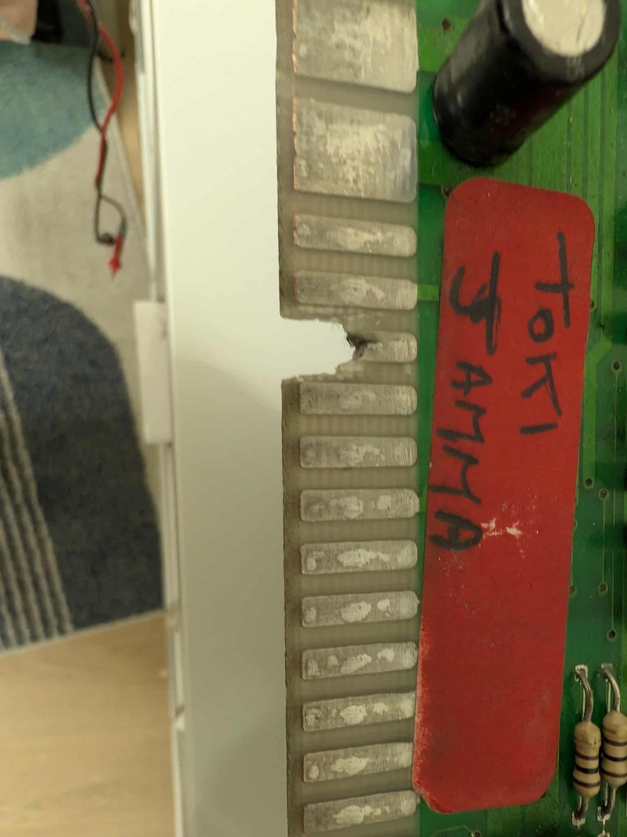

So I have one of these, which has been working quite well, until this evening. I got my hands on a bootleg TOKI and it was playing fine for an hour or so, but then the graphics started glitching and all of sudden there was smoke pouring out of the SuperGun.
So I need to get a replacement SuperGun, is there any recommendations? I'm slightly concerned that the issue was the SuperGun so am concerned about buying another of this type, so any recommendations? Wouldn't mind switching over to a USB interface if anyone knows of any,
The other question is if the issue could have been casued by the board itself rather than the SuperGun?

To be fair, I think the board I was using played a part in the problem and should of inspected before just plugging it in. Just noticed that this isn't your standard notch || so I'm presuming they'll be something up with the board that caused the issue.

I have a mak and ut works okay. Just dont use undamned decoders or it will fry.
Please wait for the HAS - they restock regularly. You're lucky that it was only your AliExpress SuperGun that burned up and not any of the things plugged into it. I've read plenty of stories of damaged upscalers, displays, controllers and of course game boards from folks using poor quality Chinese SuperGuns.

Just wait till the HAS is back in stock, or post a WTB thread for one, or get someone to build you a Minigun. I have NEVER heard of a situation where a HAS or Minigun (if built correctly and to spec) has damaged equipment. Better to be safe than sorry.
