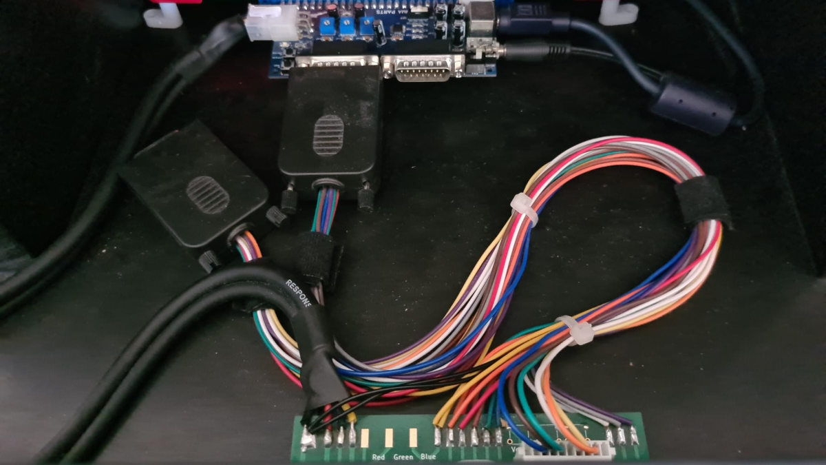

If I were you I would take the opportunity to modernize it. Because the rear connector is a 56 pin jamma connector for example you can just remove all that stuff and bolt in a minigun or a HAS and be done with it. Superguns have come a long way since this one was made back in the 90's. All this one does for the RGB lines is add 100 ohm resistors on the RGB lines and nothing to the sync line. There's no point putting the time in to reproduce something that's not best practice anymore.
I love the VEGA control box and I use mine every day but I don't run any of my video through it anymore. I was too lazy to modify the internals of mine and I just made a harness like this:
If you desparately want to keep it original, that board doesn't look too rough to draw up in KiCad someone would just need to put the time in.
