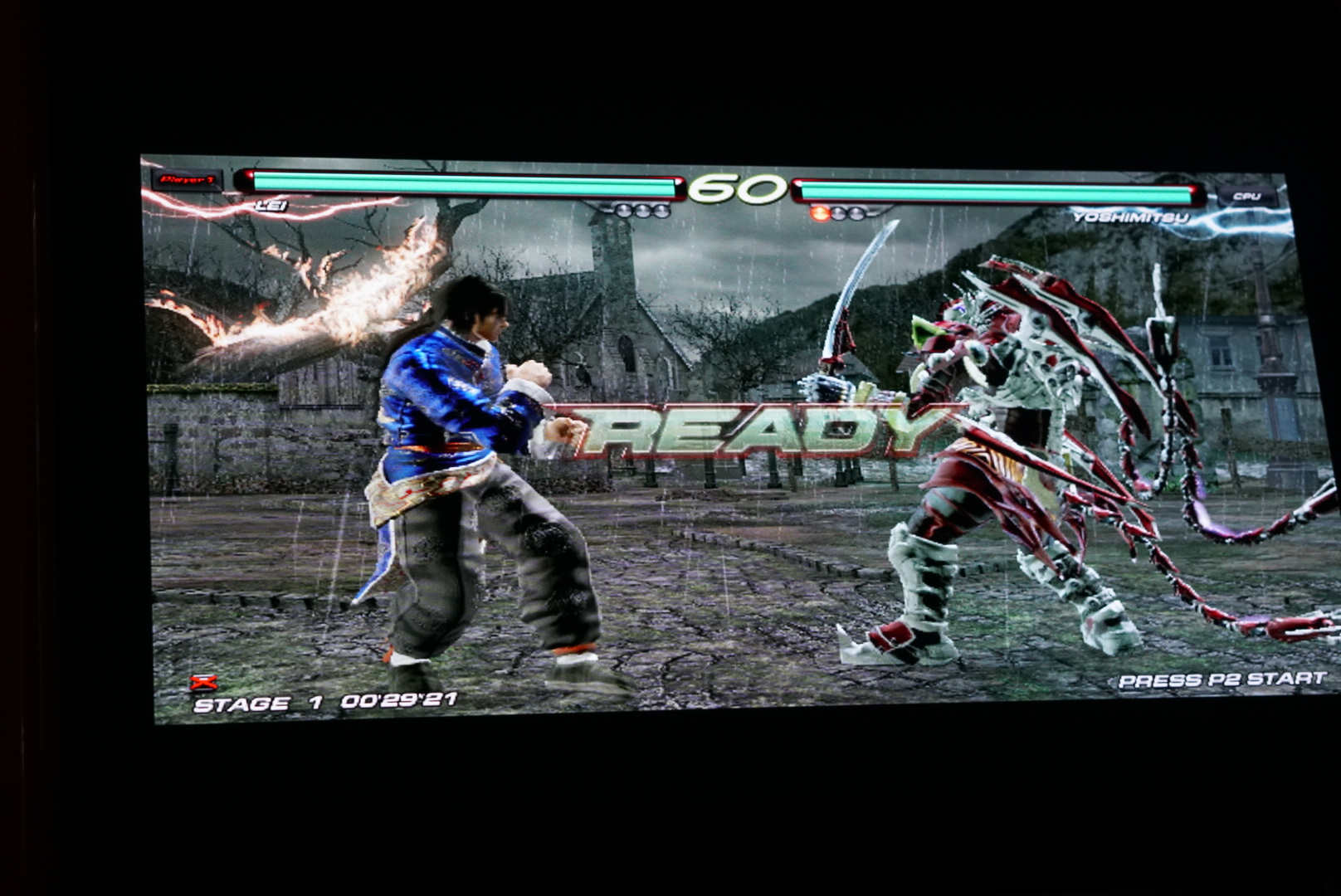

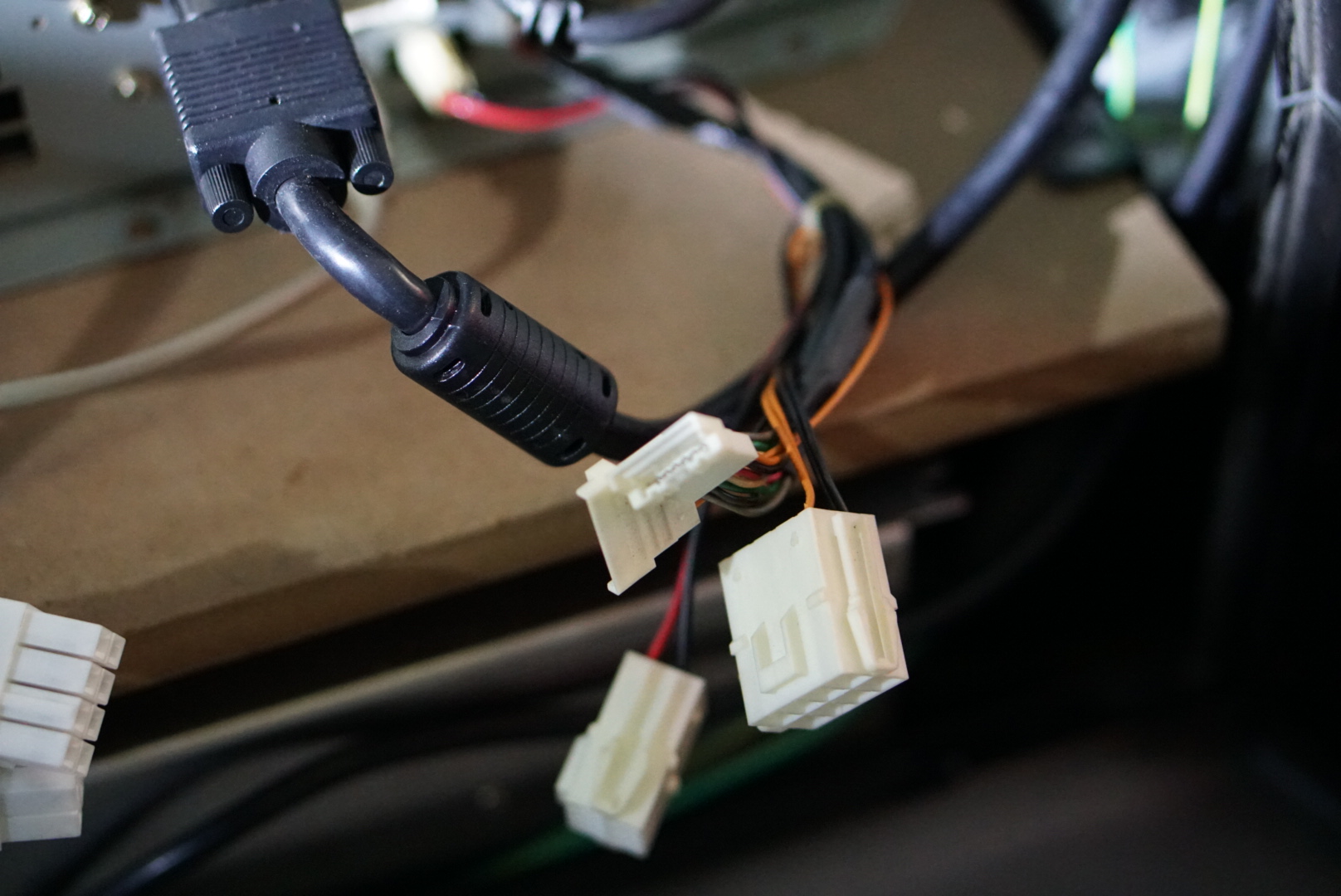

Thank you guys for the help! I got it to work finally. I'm a complete newb, though all I needed was to plug in the power cable and hdmi to vga cable to my vewlix. It came with the jvs molex cables and I didnt think I needed since the system was already powered by the other power cord. Plugged it up and it worked. Didnt have to mess with the i/o or anything.
