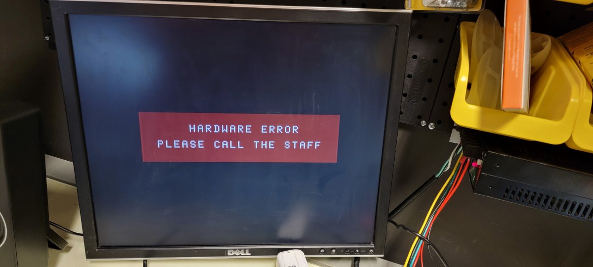

Hello everyone,
I have been working on this fisher man's bait 2 for a bit now. It started with a CD rom error so I bought a CD/DVD-ROM Simulator for Konami 573. I got it to boot using this but now all it says is hardware error. I checked the voltages and they are pretty much where they should be. I was trying to google some stuff and I couldn't find much of anything.
If anyone has ever seen this and has anything I could try I would greatly appreciate it.
Thanks,
Zack
What do all the other self test results say? in my experience the 'hardware error' comes up once one of the other self checks has failed. See here for example when I had a bad ram.
I would also get the same when the disc drive/cdr was bad, it would fail to read the disc and again indicate 'bad' and then hardware error.

hmm yeah ok. Well at least it looks like a game error and not 573 hardware error itself. Can you get into the test menu once it comes up with that error?
My punchmania is similar, once it passes the 573 hardware self test the game will load and carry out a game specific test for pad feedback, if that fails it comes up with something similar and halts but you can still get into the test menu from there and diagnose faults.
Negative. Its totally locked up. I tried the board test button and the test button from the jamma harness
feck, hhmm yeah sorry mate I got nothing else. I guess the obvious (not teaching you to suck egg) suggestions would be reinstall the game, unplug/replug all connectors, same with the daughter/addon boards on the 573 mainboard. Otherwise we're in the realm of having a second setup to swap parts.
It uses some analog controls, doesn't it? Are you testing this on a bench with nothing connected to it apart from video and power?
It is on the bench but I have the reel connected to it. The reel is from ebay though so I'm not 100% sure if it's working or not
