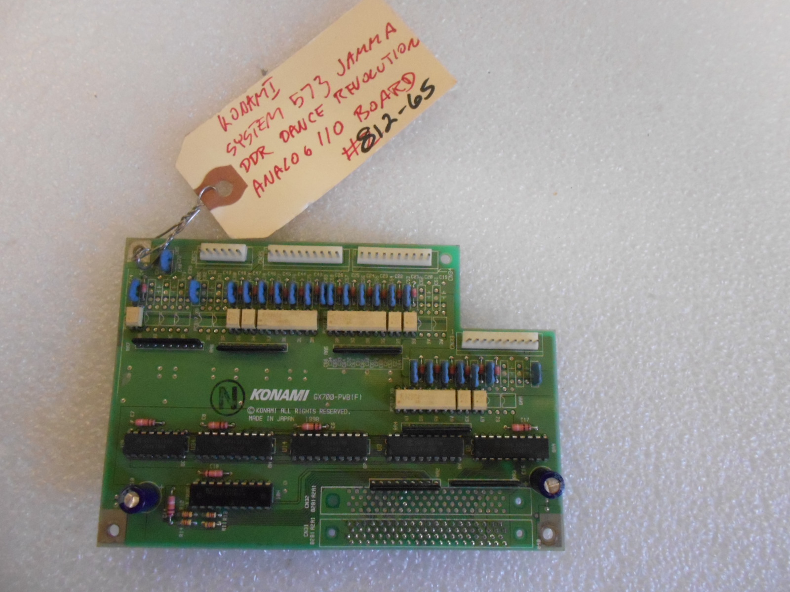

It's been a while since I cracked open my DDR Analog 573/Fisherman's Bait 573/DDR Digital 573s, but...
The DDR Analog and Fisherman's Bait units would run a 4-pin cable from the CD-Rom drive to a port behind the audio heatsink on the motherboard. The main difference between them is the sub-PCB to connect the pad lights or fishing rod.
The Digital 573 units instead have a 4-pin cable running from the Digital sub-board to that heatsink port.
So all the games listed here should be Analog-based, to my knowledge, but they don't necessarily use redbook audio tracks like DDR 1st-2nd did and work without a flash card: http://system16.com/hardware.php?id=582
Most of the games also use the small security cartridges that aren't tied to the system, so you can swap games. Even later games like Salary Man Champ that use the bigger DDR 3rd-Extreme cartridge style is swappable.
