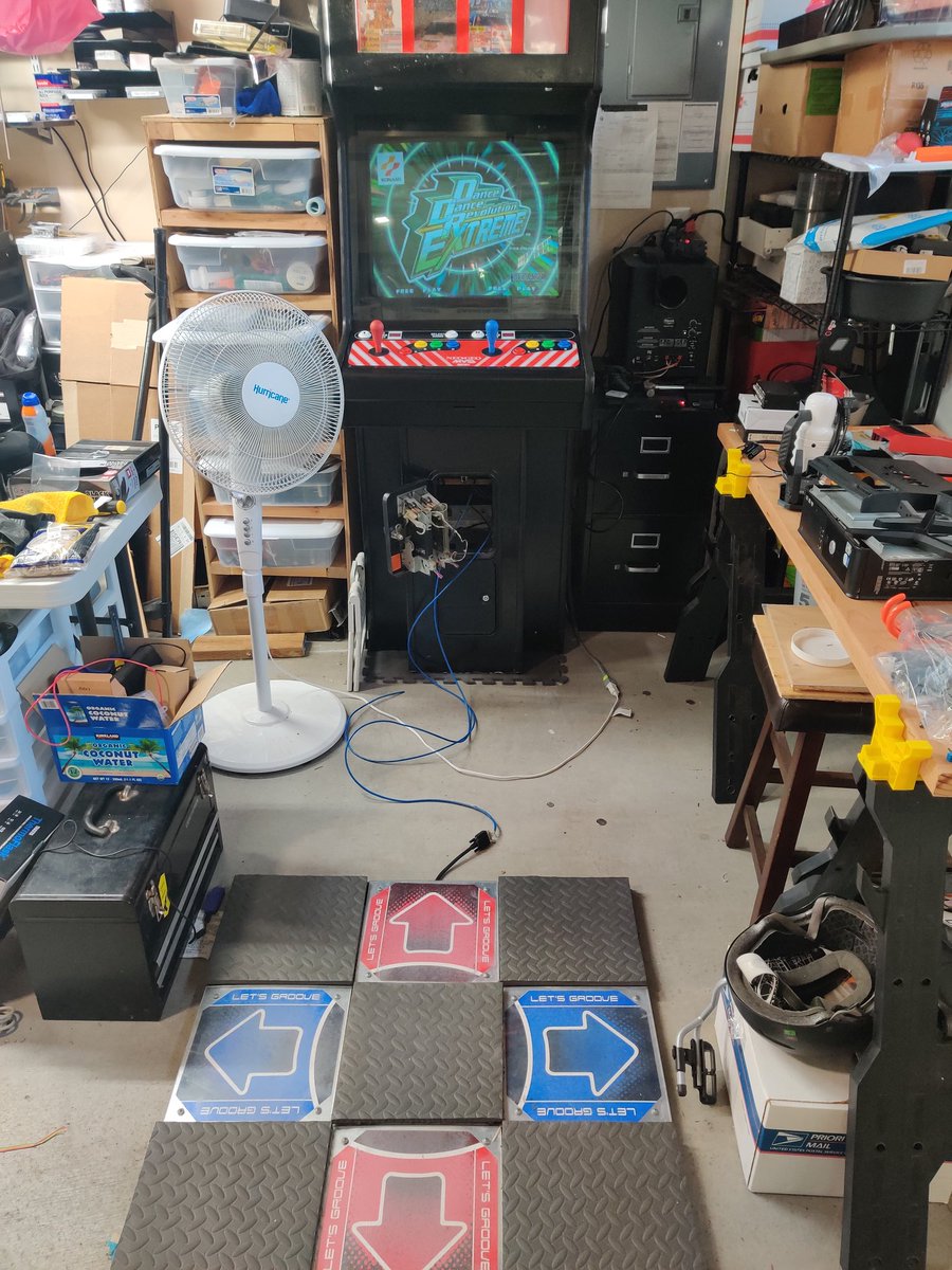

Unsure if this is off-topic, but I finally got around to buying a 573 and created a harness so I could play it on my MVS cabinet (space limitation, wife won't let me have more than one cab :P)
The System 573 came with a DVD-R with no label, and as far as I can tell, it is using DDR Extreme Pro - is this the same thing as the 12-in-1 super disc people talk about, like the Dance Maniax video in the OP?
How do I switch between mixes on this disc? Otherwise, any advice on getting MAME CHDs to run on official hardware? I assume the MAME dumps contain the no-cart patches, but attempting to convert those to a bin+cue and burn them just makes my System 573 boot loop (tried DDR5M)
That's an incorrect assumption. MAME dumps always strive to be 100% original an unmodified. if they are patched versions they will usually be labeled as a bootleg or hack alongside the original modified version.
The Discs have no protection so you can uses a CD-R but you DO need the correct security cart to go with it.

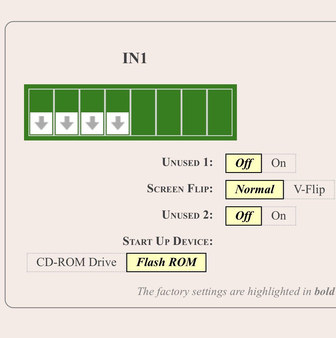

Thanks @twistedsymphony . So what about this security cart error? Does this procedure above get by that, or do I need something patched or an updated Syskey.cpp driver? The other fellow @Dion on this thread referred to some games he patched for the security cart. No idea how to do this. Just want to get this working, it’s bugging me. Ps. Here is a screenshot of the dip switches on fisherman bait - a bass challenge. What one is install and what one is run mode that you reference above. Thanks again. Cheers
Which game are you getting that on? like I said the process is game specific... I just ran through Fisherman's bait no problem
This is the process for Fisherman's Bait
1. leave dip switch in "Flash ROM" mode
2. when prompted push your test button
3. wait for the flash process to complete and give you the message telling you to reboot
4. exit mame
next time you play it will start without any messages
it's possible you have bad ROMs or CHDs that don't match and that's why you're getting an error.

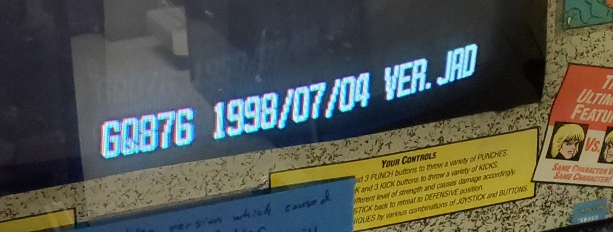

Recently I was lucky enough pick up what I belive is an original Japanese three player HBBC with a version of software that has not been dumped yet (at least that I can find).
"GQ876 1998/7/4 VER. JAD"
One of the flash rams throws an error occasionally and I'd really hate to lose this version if there isn't a backup of it already.

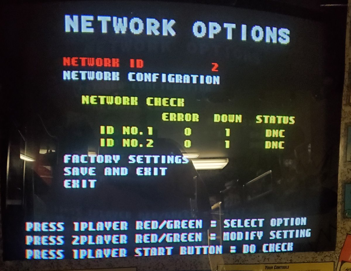

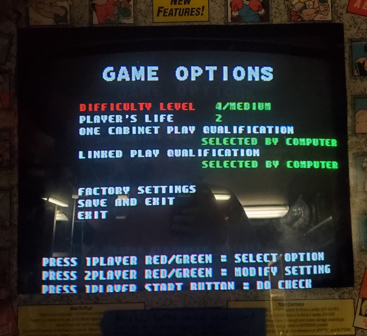

As a side note this version also has a "network" section in the game menu which appears to allow you to link two games (which I hadn't seen on the 2 player version).

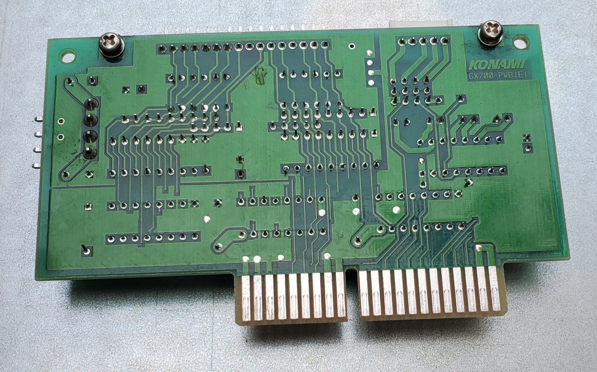

Attached are photos of the "security cart" and such for reference.
Thanks in advance for any assistance!!!

What is the appropriate method to grab this software as a backup and too share with others?
Lend it to someone who can dump the these flash chips.
In theory, it might be possible to create serial terminal to dump the flash via usb connector on the board, with custom program loaded via cd. But that is another story.

My suspicion is that the flash chips would need to be desoldered and dumped that way, but I've put an ask out to the DU to see if anyone has any advice.
You don't need to de-solder them, if you have an ATA CD drive and an ATA hard disk drive.
