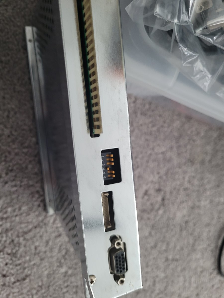

2 - You can run it as a straight JVS or as a JAMMA. There are dipswitches on the motherboard to change between. In JVS, you can use the 15 pin VGA style connector for the video.

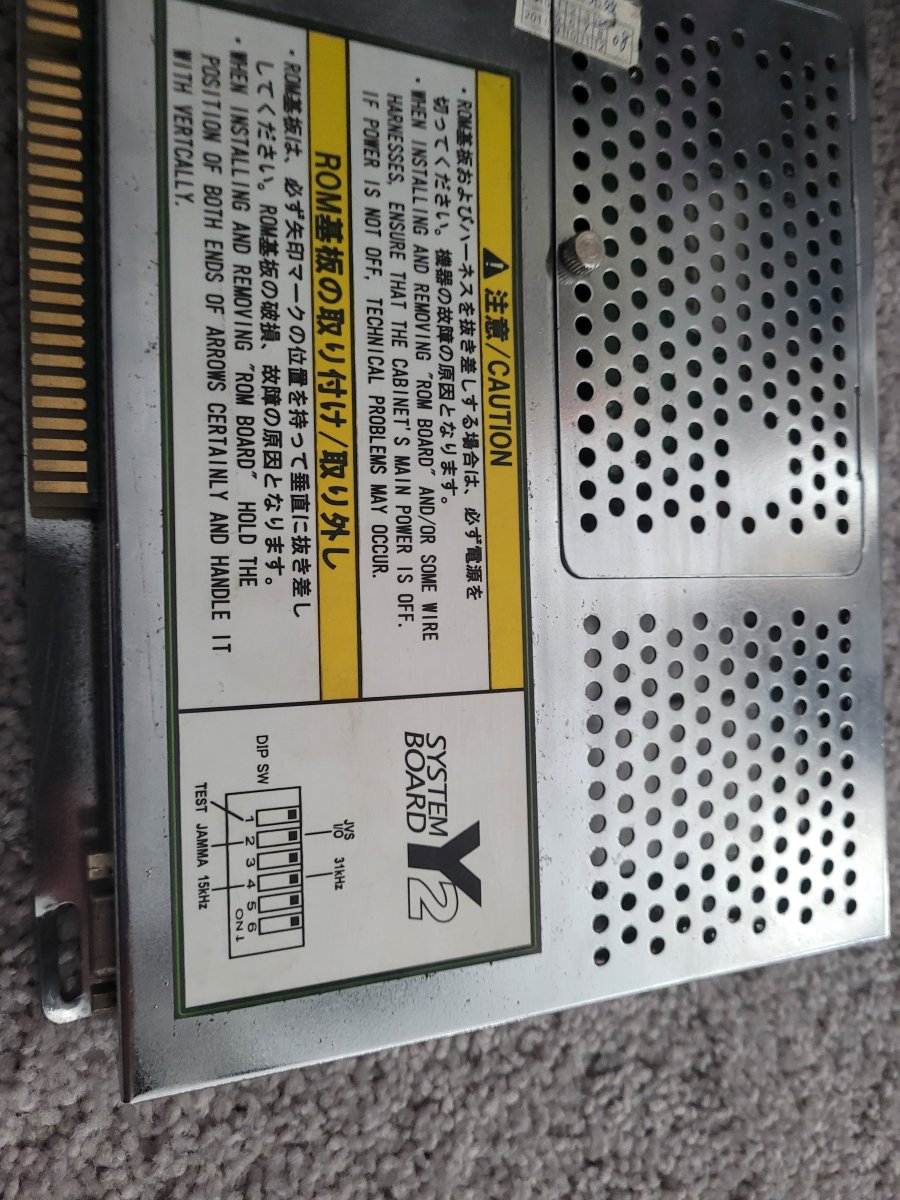

These are the dip settings I'm using at the moment. This produces 15Khz video via jamma and requires coins to start - not sure how to enable free play assuming that's an option at all. I believe there is a test menu? Been a while since I fired this board up.

What are the best options when hooking these up in a Blast City? Ideally, without using a separate USB I/O board (JAMMA controls). Looks like the options for dipswitch 2 are JAMMA or JVS I/O, so I assume that just affects controls? Are there any benefits to running 31KHz video over the VGA-style connection vs the JAMMA edge that it would already be connected to? JAMMA doesn't have stereo audio, so could I just connect the RCA cables? Power would be all JAMMA too. And all the dip switches would be off. Any dangerous combinations here?
VGA connection will give the best picture for the system Y2. I dont have a cabinet, but I do use a supergun and connect the VGA with the dipswitch set to VGA mode. then use the jamma edge as a means of powering it on, but you can also use a sun power supply like that of the naomi in order to power it on as well. It does not require any sort of IO board of any kind

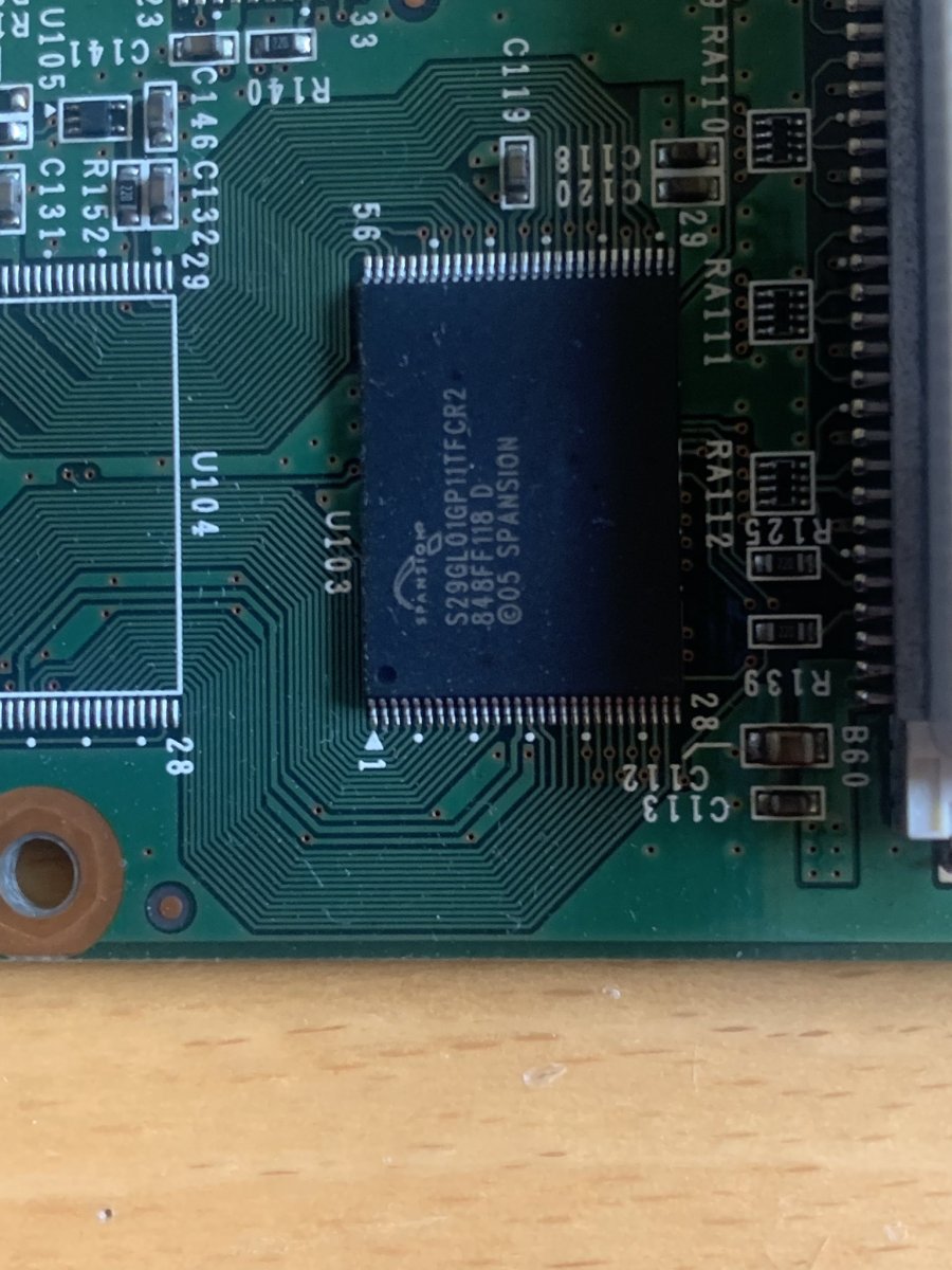

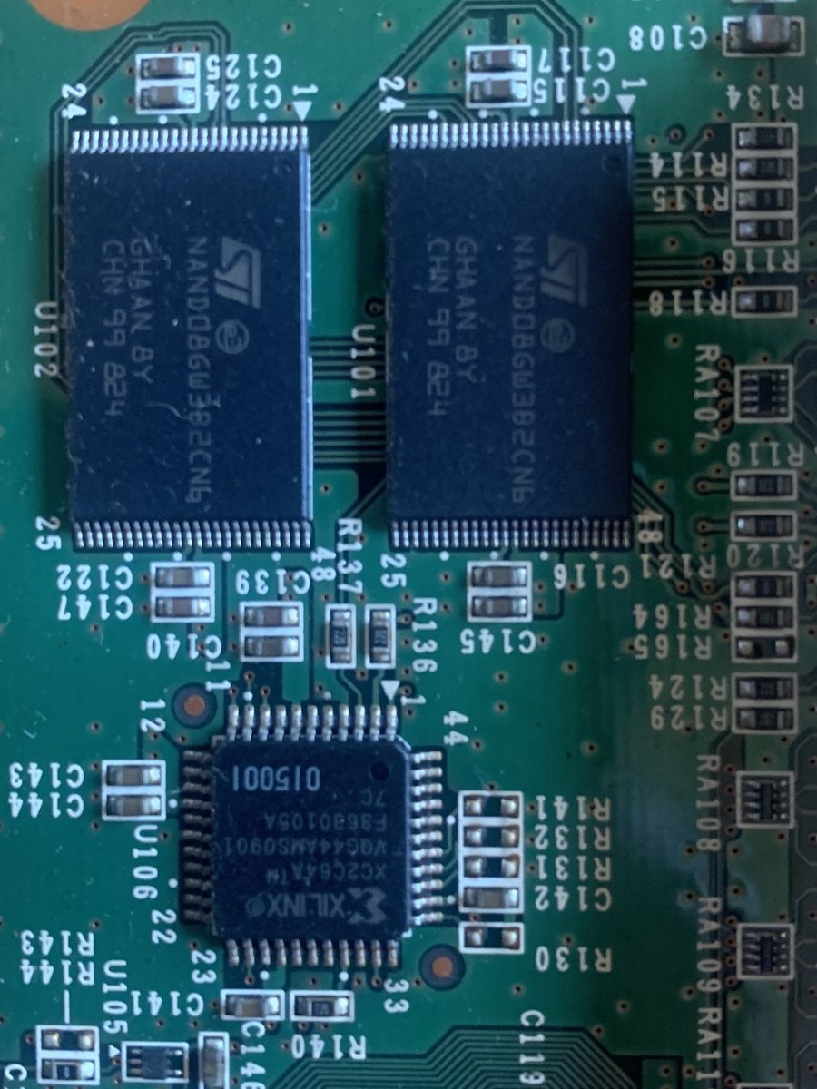

From the look, each romboard has three NANDCHIPS
STMicroelectronics - NAND08GW382CN6
SPANSION - S29GL01GP11TFCR2
Anyone know which NAND flash burner works with those NAND chips above?
I think it maybe possible to desolder the existing NAND chips and install new NAND chips in with KOF2002JP version
