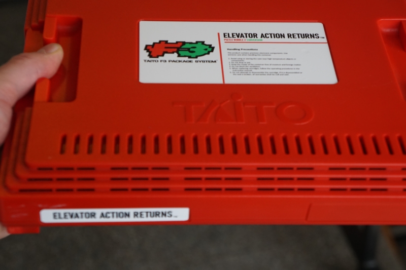

Created a label for my Elevator Action Returns Conversion and got a local print shop to print them off.
Unfortunately had no option for curved corners so had to try to cut them myself with a craft knife and scissors which hasn't resulted in the best job but I guess they are good enough.
Have a few spare because of minimum paper use being way too big for my needs.
EDIT: Including a JPG image for the label I created. Also can provide it in easily editable PDN and PSD formats if anyone cares.

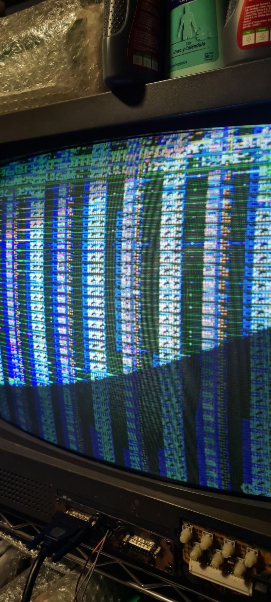

hi sorry for making such an old thread but i'm having trouble converting a darius gaiden the splash screen doesn't go past a couple of introductory sentences and then the game crashes and restarts i'm using a puzzle bobble 3
