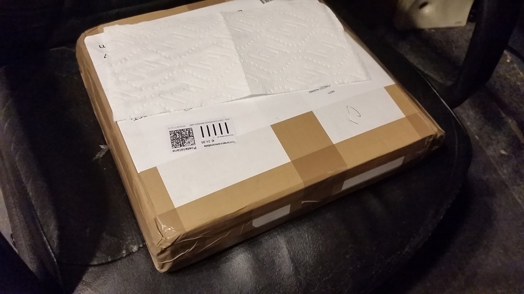

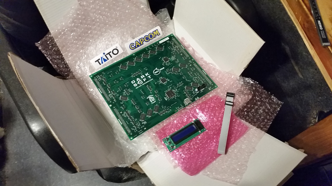

I wanted to post a mini review of @CPZ - SAVEYOURGAMES
I ordered the F3 Multi through them on August 4th, it shipped on August 8th and it arrived yesterday, August 17th.
I was initially impressed as I received a partial refund because the actual shipping charge came out lower than what they had charged me.
After reading about the packaging that others had been reciving with their F3 Multi I was anxious to see how mine would fair but it was packed extremely well. essentially doubled boxed with lots of bubble wrap:
