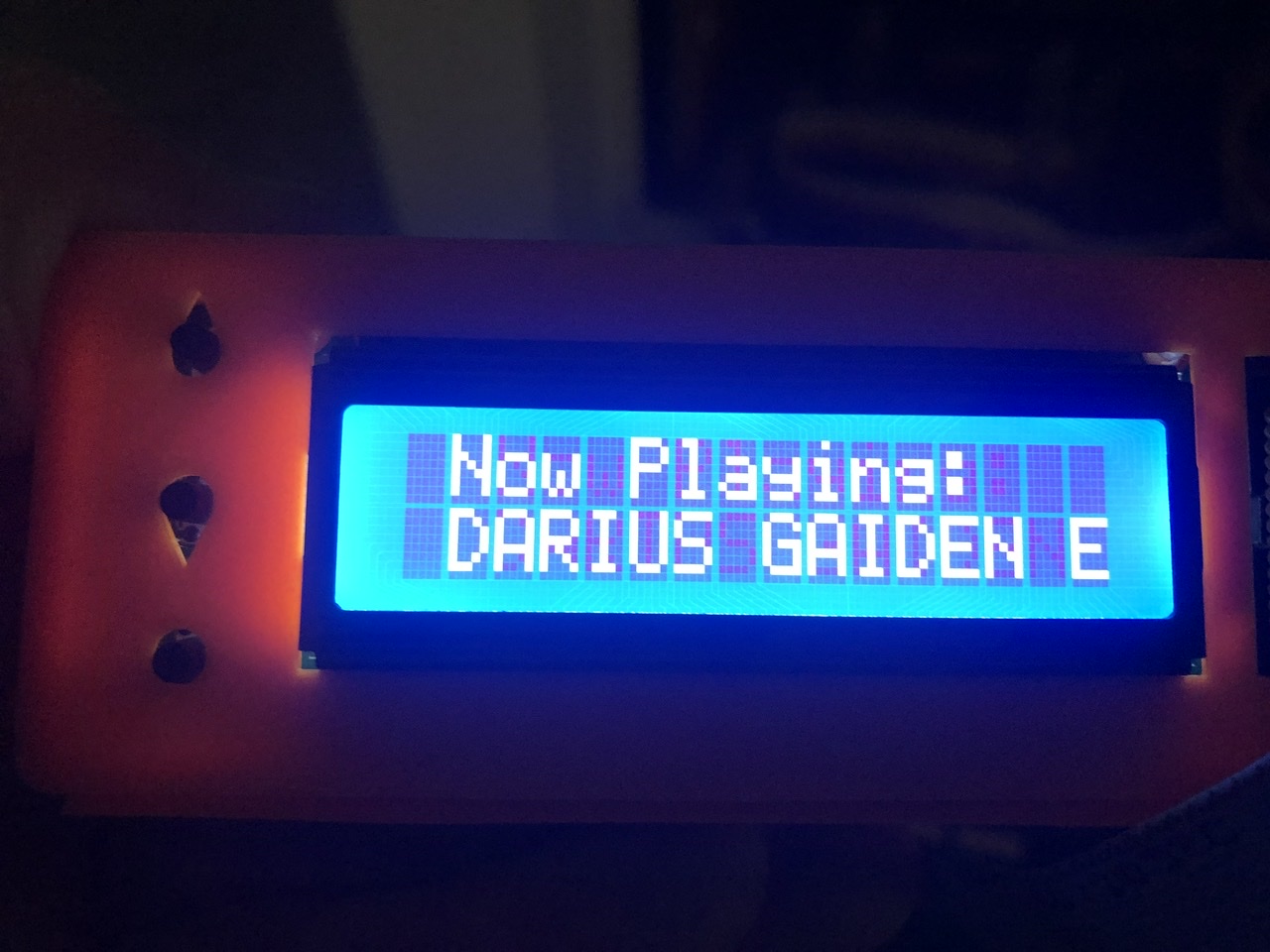

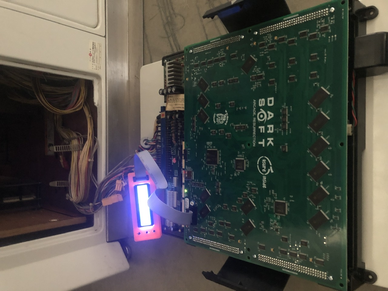

Took me around 30 minutes, most of which was getting the LCD screen in it's holder. Very pleased with this. Setup was simple.
Now to get the M72 installed. I've had the roms burned for almost 6 months and never got around to it.
Thanks for making these.

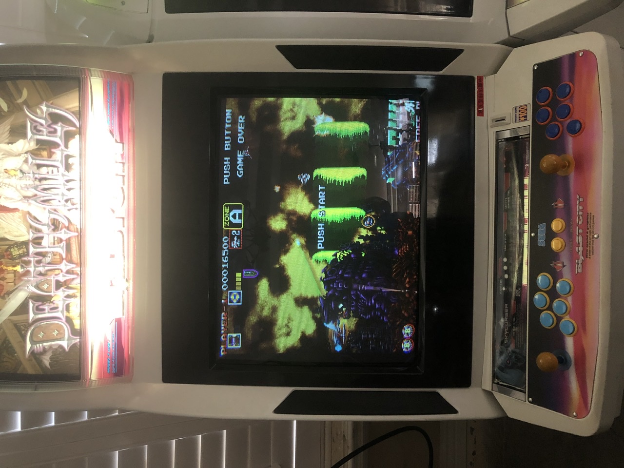

One other question and more of a general F3 query than a Multi specific item - Does anyone get a missing pixel in the bottom right corner of some games?
It does this with mine on Darius. It's barely noticable. It actually looks like the pixel has been cut from the bottom right corner and put up at the top of the screen on the right side. I think it is my 15 year old $30 motherboard...Not looking to replace it just for this. Just curious if this is normal.
I also get a color ram error when booting Gunlock, but this happened on my Rayforce conversion cart as well.
Got mine yesterday ! Nice product, installed but doesn't work. I'm testing all I can but no solution for the moment. I have posted earlier a topic.
I installed last night and it does work. I haven't tested all the games but a handful loaded fine. The breaking of the region lock tabs was a little stressful but nothing I couldn't handle. Will post pictures in all it's glory soon. :thumbup:
Does anyone know the answer to my problem or know which RAM is the color RAM?
Color (palette) RAM will usually be close to the JAMMA edge because it's part of the output stage.
According to the MAME driver, the custom TC0650FDA is likely a priority mixer, and is right next to the palette RAM. My guess would be the colour RAM is the pair of MB8421s
These are very unlikely to have failed unless someone has run way too much power through the board in which case that's not going to be your only issue. Check for broken traces.
Thank you. That was my first guess given location to video DAC. I ordered some Ali special and will see if piggyback ride takes it home. Until then, I will trace my steps and make sure the train is running. Appreciate the help.
