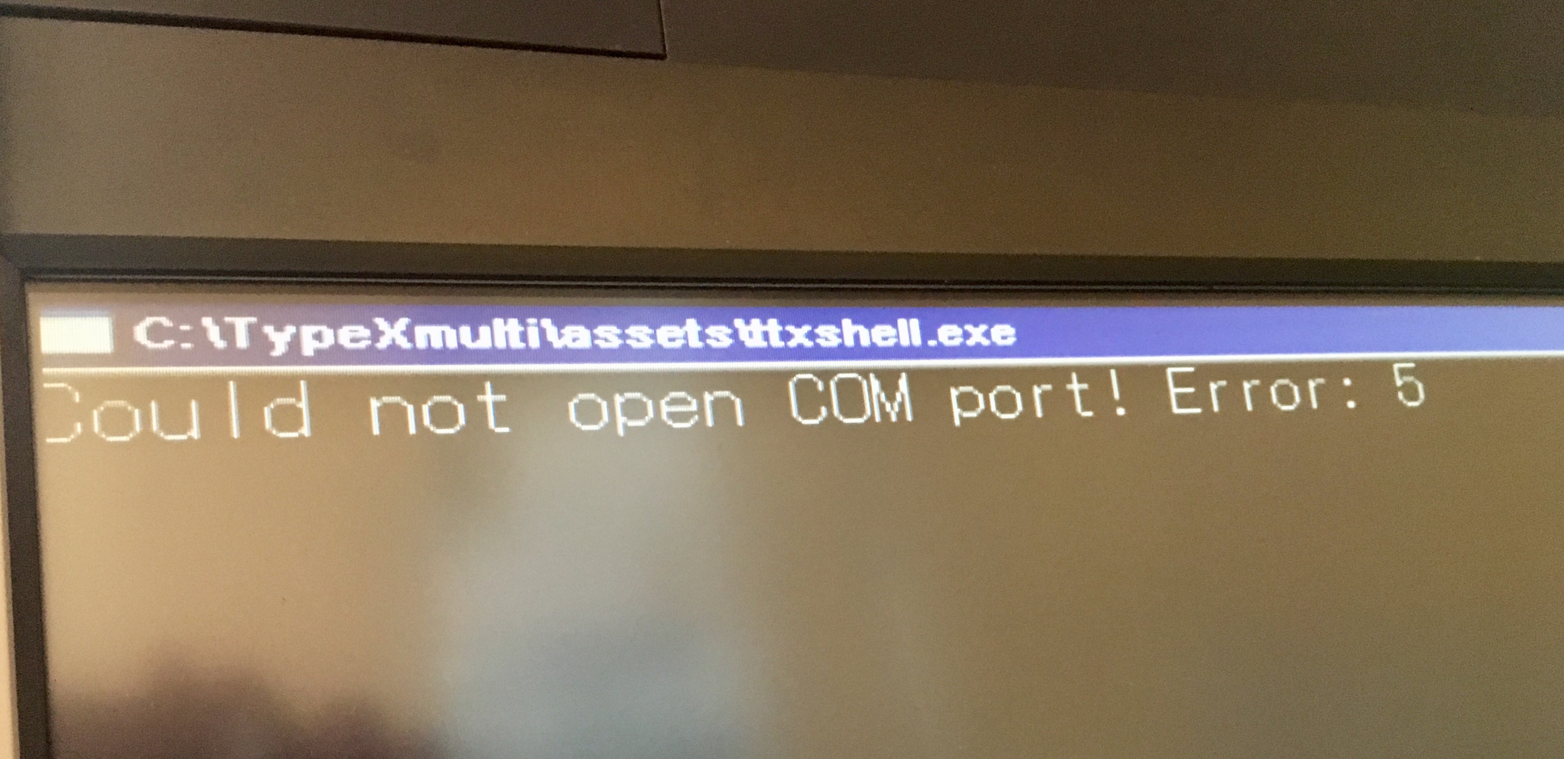

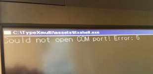

So I had time to try this today. I ended up with the following error during the boot process:
Any ideas what else needs to be done?
Make sure that COM2 is available on your computer and not in use by another app. That's what X2 uses for JVS communication

How do I do this? This is a real Taito Type X system. I cloned a working drive and copied the files and set it up as per the instructions above.
Well first in device manager make sure COM2 exists and then you need to see if there's any background processes running that might be using COM2

So I did the following:
  • Re-flashed drive with Dinomax image to SATA SSD drive
  • Created new 3rd partition titled "GAMES", drive letter G:
  • Copied the games to GAMES partition (copied a couple of shmups like Raiden III & IV)
  • Copied Niko's multi files to both C: and D: partitions
  • Removed "TypeXsys" directory
  • Created new "Shell" Registry entry in: HKLM\X1\Microsoft\Windows\CurrentVersion\Run
    • which points to: %SYSTEMROOT%\TypeXmulti\assets\ttsxhell.exe
This results in the following error message:
