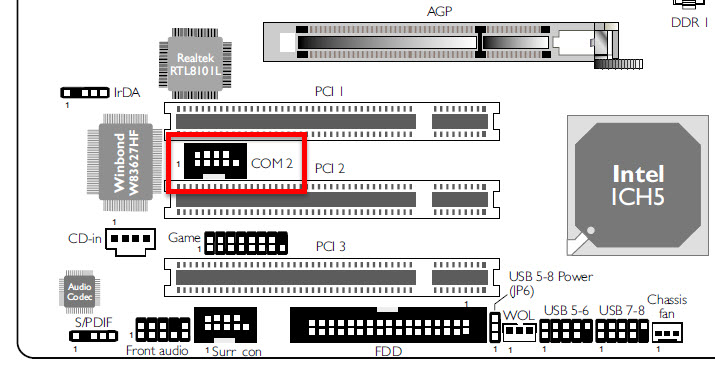

@waiwainl Negative. The middle connector is the SPDIF connector. That is connected correctly.
The COM2 port with Dips is the 9pin header at the top in the first picture.
You want that plugged into the COM2 labelled port connection, between PCI 1&2.
The 12 pin header plugs into the front panel connector.

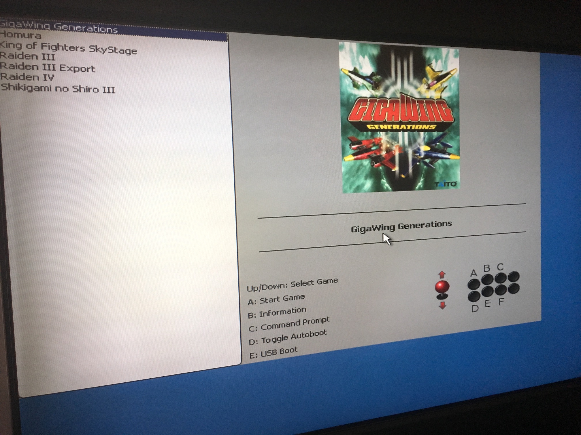

So I made two change:
Edited the path in the Registry to be the explicit path: "C:\TypeXmulti\assets\ttxshell.exe"
and renamed:
C:\Windows\system32\Ttxshell.exe
to
C:\Windows\system32\Ttxshell.bak
And we have....
Woohoo!
