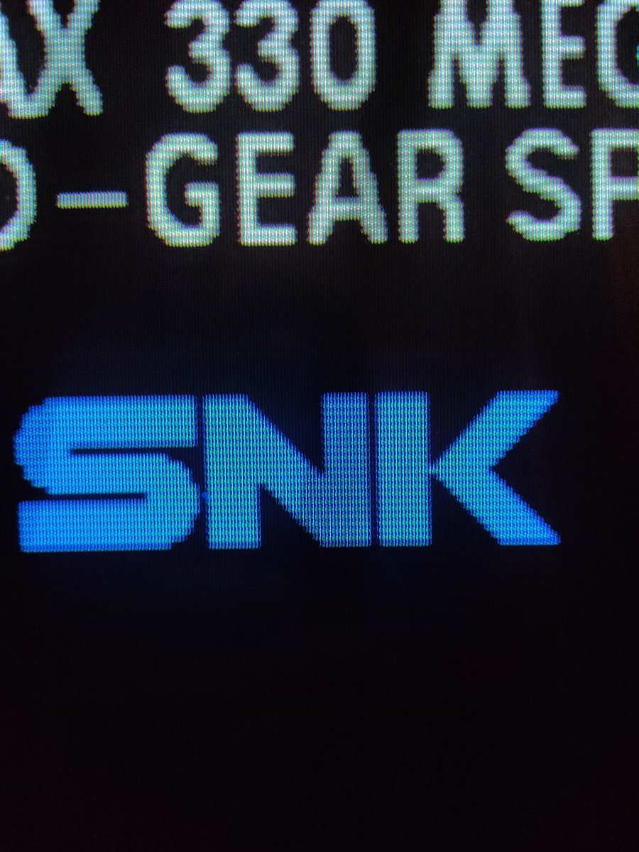

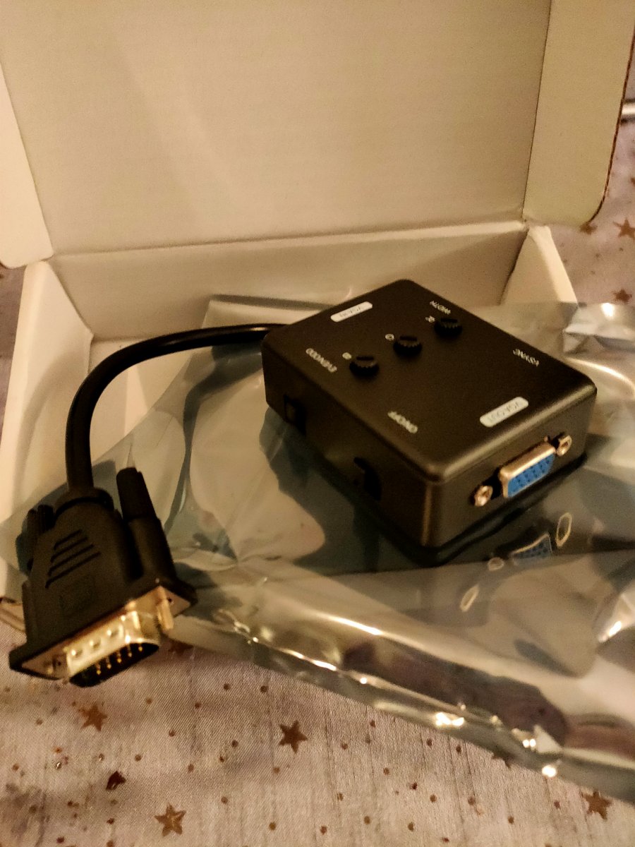

I found a solution for scanlines in Mame et Nesica 15kHz games ( street fighter 3, puzzle bubble...) , "Vga scanlines generator"
