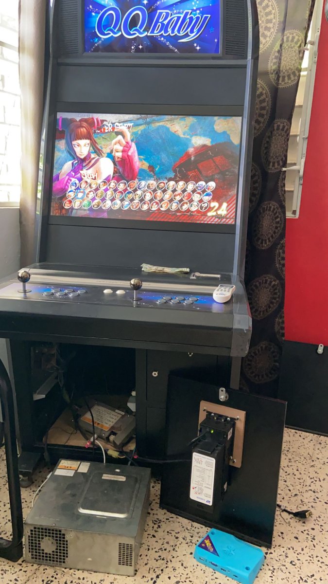

Its a qq baby that has jamma connection . I have a ttx2 running in it fine with the capcom i/o just wondering if it will work the same with the ttx3
Thats the cabinet that im using

I had no idea USF4 could run on a ttx2 being it's a ttx3 game. But, you could use a capcom io just fine for ttx3. I have in a Blast. I use the fast io in a Viewlix F tho. Not sure what a QQ BABY is.
The QQ Baby is a Taiwanese LCD cab by Weche. Same company that did the OK Baby. Or it should be the same company given it's identical name, origin, and business. I've never seen one in person in Taiwan before though, at least not in the biggest arcade chain (Tom's World) or any of the local places I'm aware of in the Taipei area.
Edit: I should probably answer the question... Yes, you should be able to use a Capcom IO in the same way as the TTX2. There should be a PCB next to the GPU that accepts both JVS (via USB port) and FASTIO (via ethernet port)
