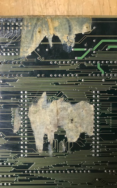

At this point, I decided to visually inspect the board. The first thing that caught my eye was on the solder side of the board. There were 2 large areas underneath the board that have the remains of old adhesive masking tape. At some point in the past someone recklessly did this:
I carefully removed the tape, which was not easy & took quite a long time to do so safely & properly, but I was successful and the end result was quite nice:

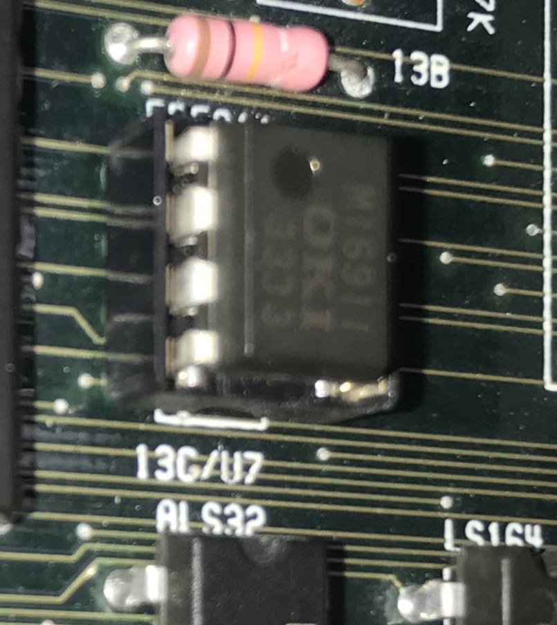

I then decided to focus on the 2 reported “bad” chips. Even knowing full well that the rom tests are often incorrect and can report chips as bad, when in fact they are not. I began with the bit eeprom chip. A tiny and simple 8 leg chip. I desoldered it from the board, installed a socket, and replaced it with the exact same chip that I sourced from a Konami Run and Gun parts board I have. And no change:

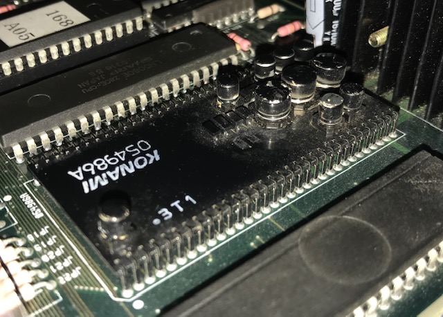

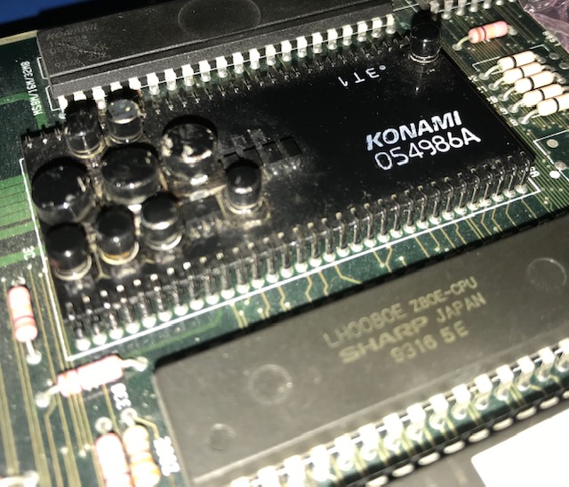

Edit: added pics of the sound module:
