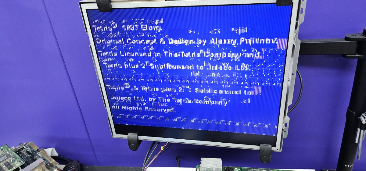

I found a junk Rev X board with lots of 27c040 100ns chips on it and replaced 26-29. Still doesn't work entirely, but progress! I now get this garbled screen followed by static. Power is fine an upping it some didn't help.
does it get past that screen? if so it seems to imply that at least the program ROMs are correct now... probably has some issues with the txt ROMs which I think are 10 and 11
yes, that's it! ... so do you think BBB only works with this stuff removed?
hmm all of my MS32 stuff is in storage but I don't think any of my boards are missing those chips. I distinctively remember comparing mobos side by side trying to work out what was different to make one work and the other not, and aside from a few small capacitors bridged across pins on a couple of chips I didn't see anything, I certainly don't recall any missing chips.

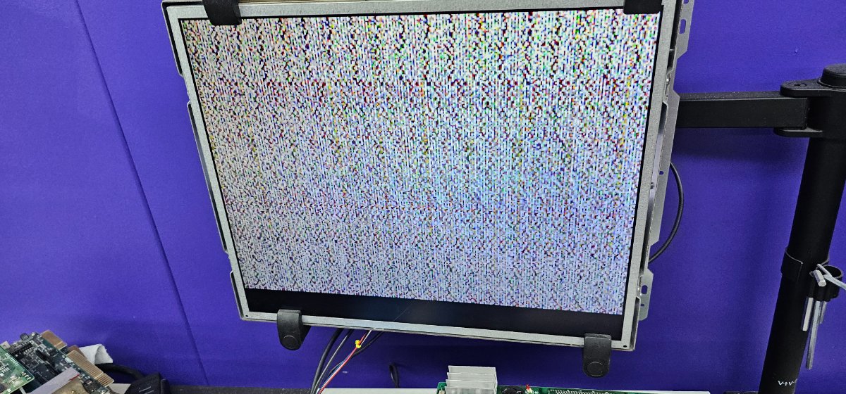

Yeah. It goes past that to this screen. It almost looks like something is going on underneath the static. I'll check out redoing 10 and 11 a little later today.
That to me looks like what you get when you're using the wrong data encryption for the security chip.
the "security" is just encrypted graphics, so the game plays but you get garbage like this when it's wrong.
that is to say, I'm sure your security chip is the right one, so I would focus on the ROMs that are encrypted which are ROM 10 and ROM 30
For the Game Tengoku ROMs? I haven't, but I could. The security chip has the number printed on it, so unless that's wrong it's the right one as far I can tell.
