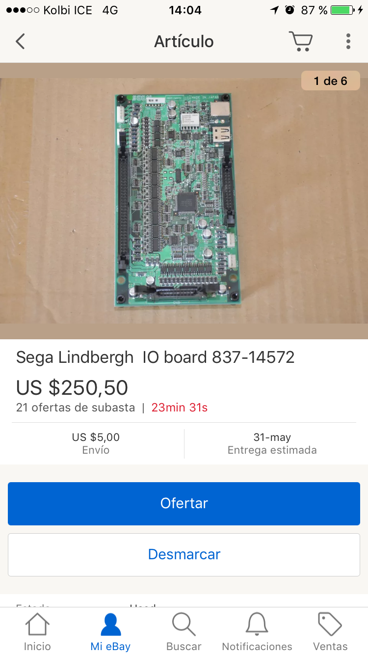

Man, don't eat lunch at your desk while watching an eBay auction end. Those are all my bids as I finished my soup.
No wonder I got outbid on YAJ for one of those today, mind you 6400 Yen was probably optimistic.
