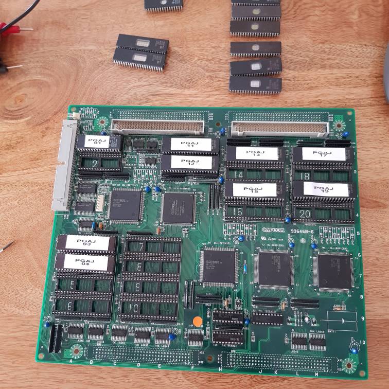

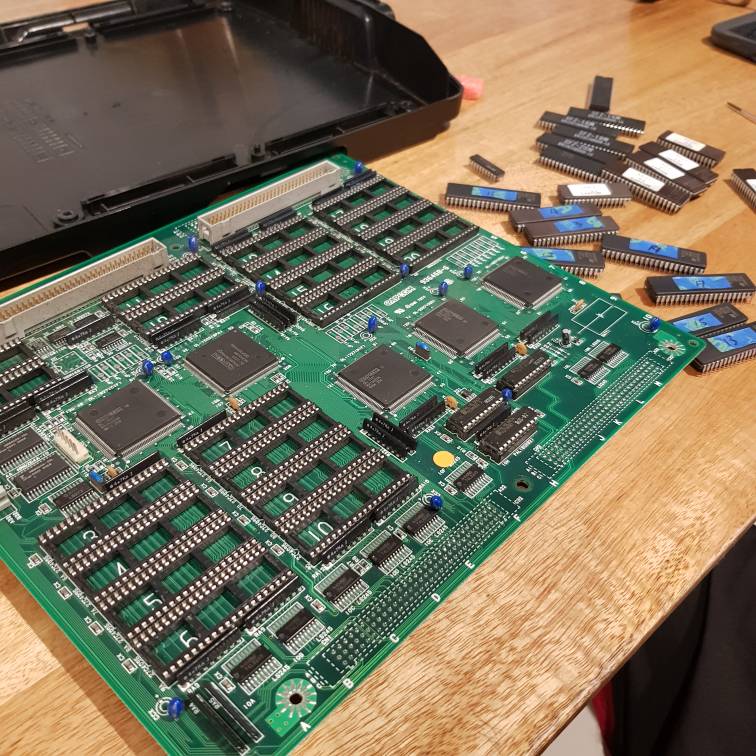

Once again thanks for the write up!! You pretty much followed me through the journey on messenger :D :D :D
I didn't do it exactly the way it was written up as I didn't have to combine roms - the files I had were already combined!

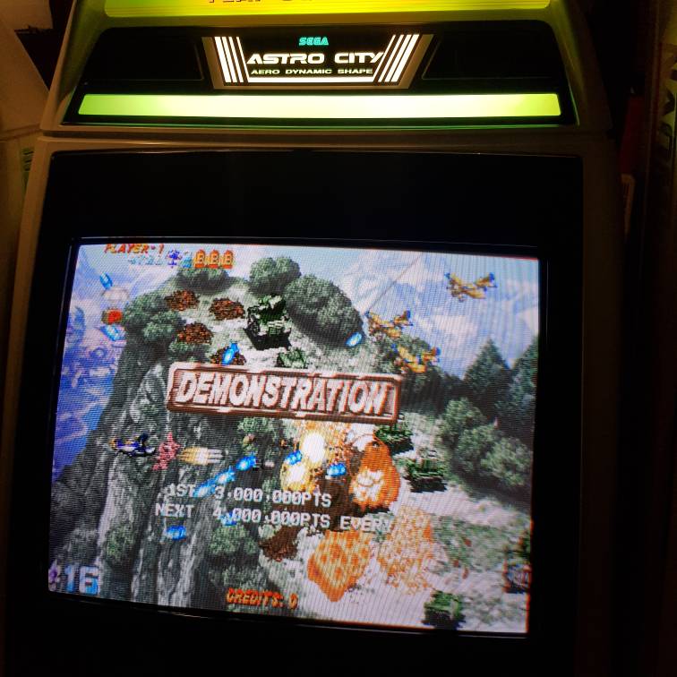

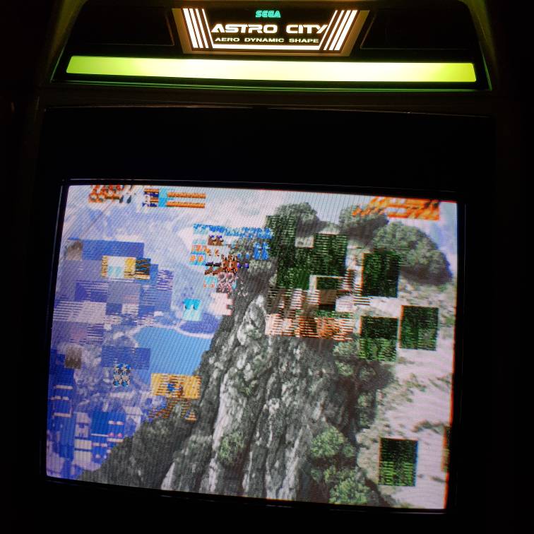

First attempt is Progear. Burnt and installed the required roms
Booted and I was happy it booted, but the image was all over the place.
Correct the jumper settings on the board and voila! Image and game play is perfect!!

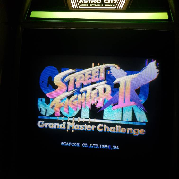

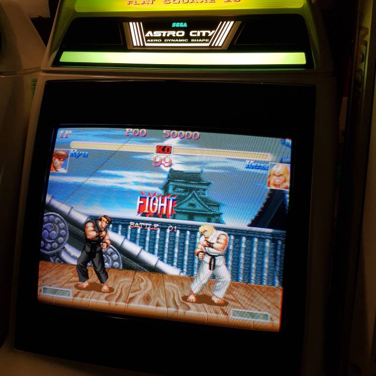

Next attempt was SSF2X - this took pretty much most of the Saturday afternoon
First burnt and installed all the roms.

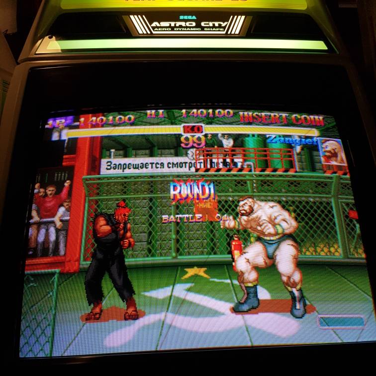

Upon first boot, I noticed a lot of the sprites were all over the place..
After some time troubleshooting, I eventually found the issue to be a faulty rom - of course it to be the very last rom on the board that was faulty!
Once changed, image became perfect

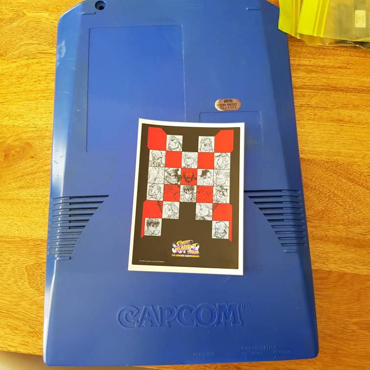

So I present the biggest hack job ever...
A US CPS2 case and label but inside it is the Japanese rom without the daughter board like the original.
Now to try and find another cps2 board so I can have ssf2x and Progear inside their own case :)
