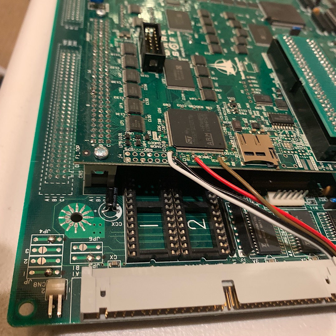

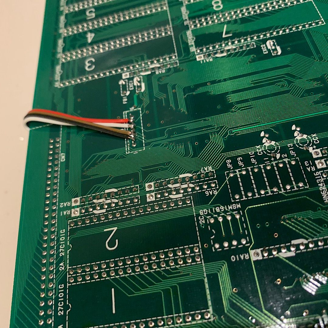

Here’s how I did my wires since I didn’t have a plug for CN9.

I get a solid green screen, and I found out why I had a friend solder the wires because I don’t know how and couldn’t bare to try. And he jacked the pad up where the key writing wiring goes for the clock the wire isn’t even soldered to it because the pad is done, all the others are soldered. So pretty much thinking I’m just going to have to purchase another darksoft Kit ‍♂️ +400 bucks wasted time to save up for another kit.
Or you could just solder to a different point for the same connection.
This has happened to a few people. It can be repaired without replacing the kit or you can run the decrypted ROMs without issue. Since you're in the US, contact @Mitsurugi-w
It's caused by using too hot a soldering iron and holding the iron to the pad too long. You should be tinning the wire, holding wire to pad and heating the wire. And not using the iron at 400C
