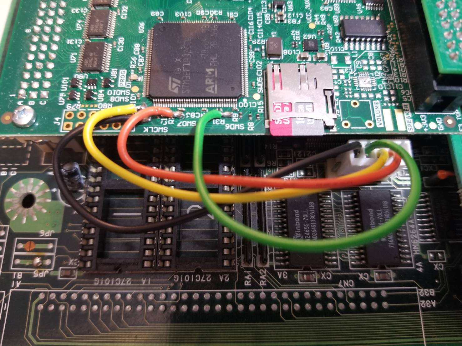

I bought my cps2 multi back in 2019. It worked fine before trying to install the Key writing. I tried putting in the 4 test games after installing the new wires but I get a black screen and the LCD panel is just black bars.
I do have a B-7 board and using a Sandisk 16GB SD card that was recommended that worked before trying to get the key to work. The SD card should only have the games folder and then the games inside of it which I do have.
I believed everything is soldered correctly? From what I understand I should not need to update the firmware since I bought this after 2017 new? It has been a while since this stopped working for me and finally had time to go take a look at it again. Wondering if there was anything else I should try before I try to ship this off to someone to help fix this. Thank you!

are you using the new roll up pack with the encrypted roms or the same rom pack with the decrypted roms from before you added the key writing wires?
I'm pretty sure I am using the new encrypted roms from the Roll-up Base pack. I also tried using the 4 roms in the original post and I still get a black screen.
