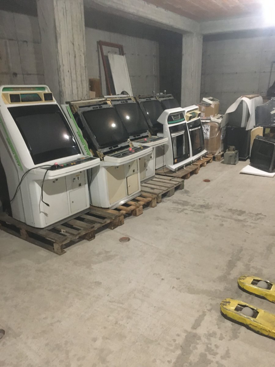

What's up guys, me and @Mukuro_W we got hold of these 9 beauties.
The restoration work will be huge and there will be a series of problems to be solved which I will talk about later.
Unfortunately, a couple of important pieces are missing and three of these are in bad shape and without front panel and black bezel.
So we will need the help of @YATON to complete them (and not only).
I will update the post as we progress with the restoration, Good night!! :thumbsup:

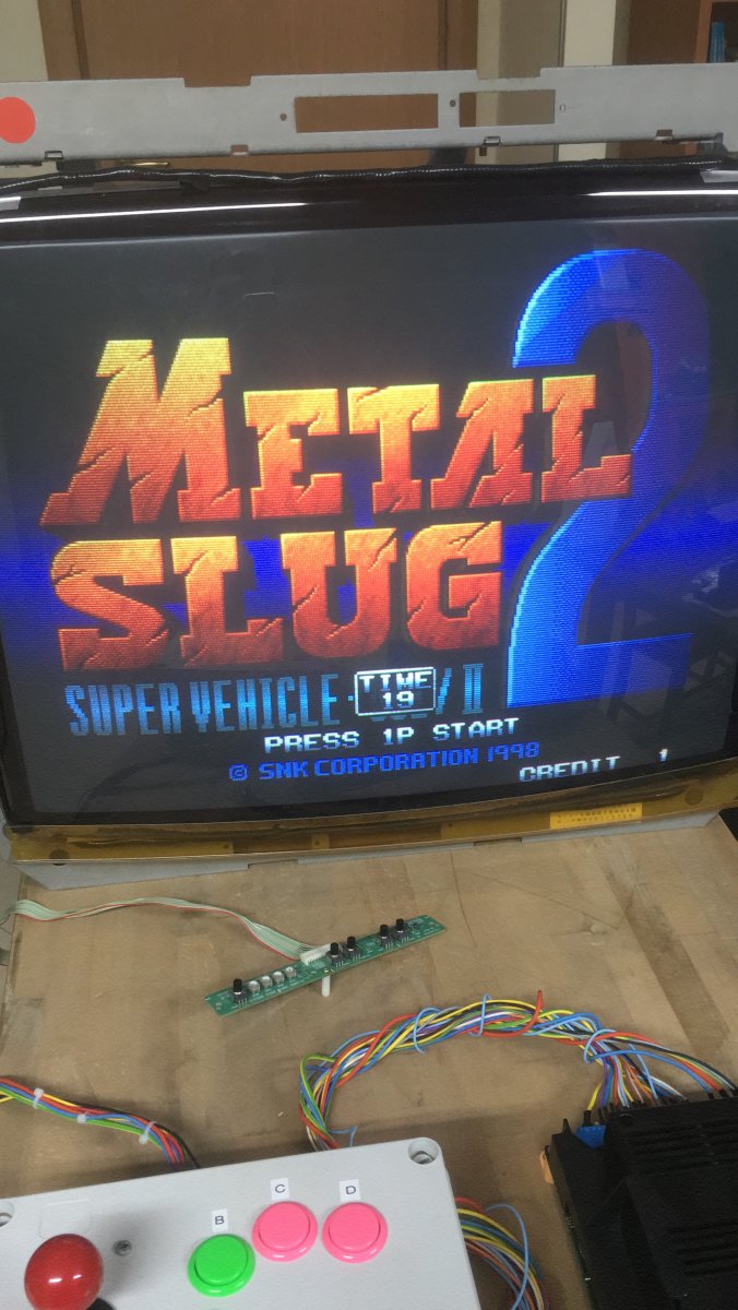

In my opinion, a healthy CRT makes 90% of a cabinet, that's why the first thing to do is undoubtedly to secure the monitor and electronics.
Here are some photos of the washed monitors and the overhauled and re-capped electronics.
I will post updates shortly.

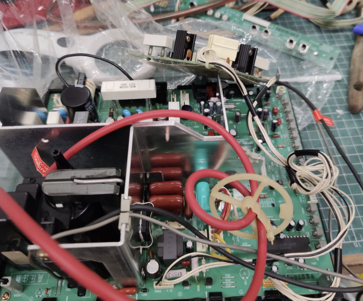

I decided to mount the astro city 2 power supply (SEGA 400-5220), with SEGA MODEL 1 amplifer for stereo sound (SEGA 838-8689).
After cleaning and recapping the power supply and amplifier, I proceeded to assembly.

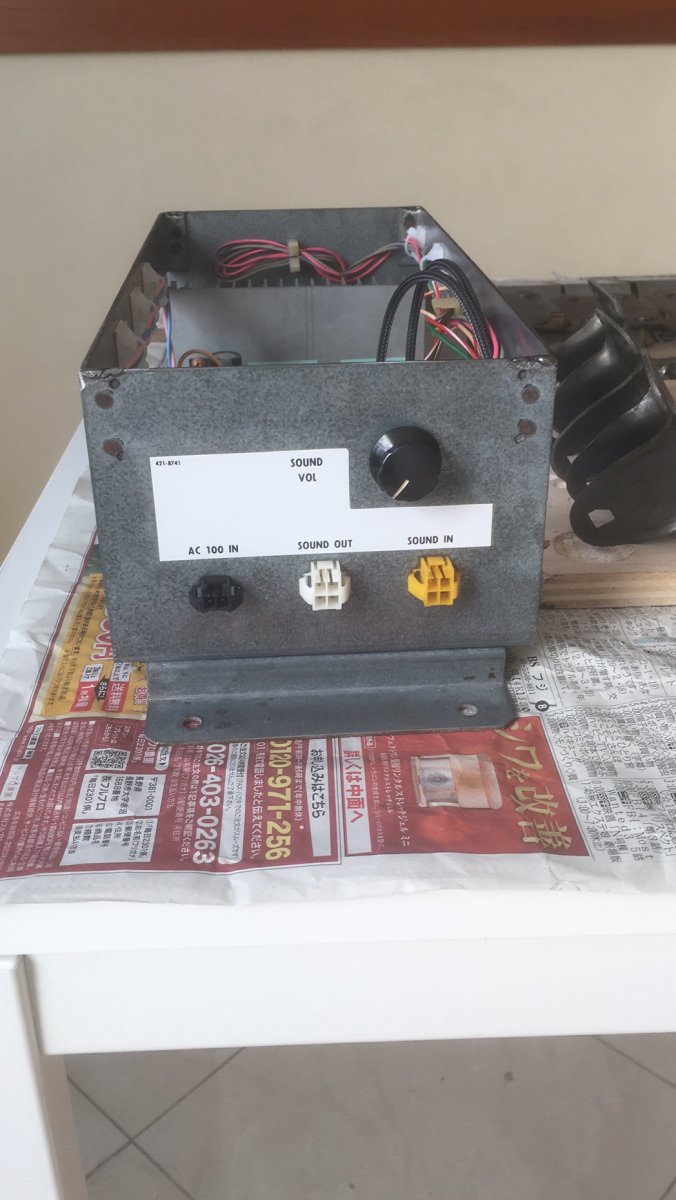

As for the placement of the amp, I decided to use the case of the old amp (SEGA 601-6227-01), making some changes.
I had to prepare these three cables to finish the job, because the old amp had different wiring:
Here is the finished work,
I decided to change the unobtainable red 4 pin male amp up with the yellow one (like in the NVS 4000):
