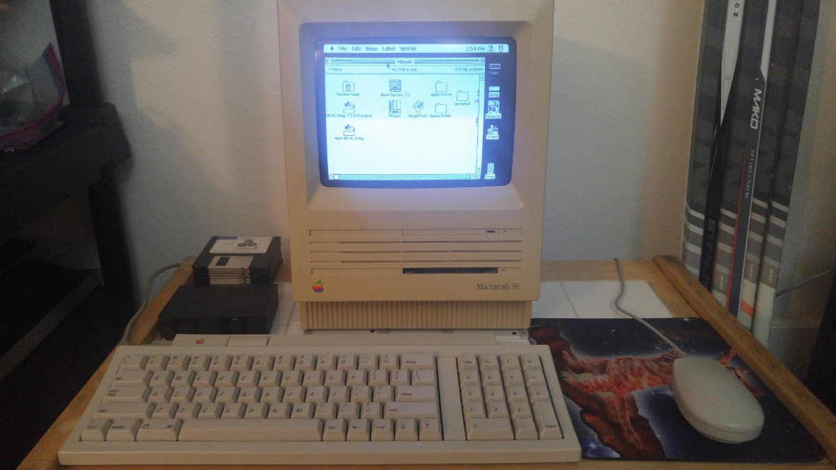

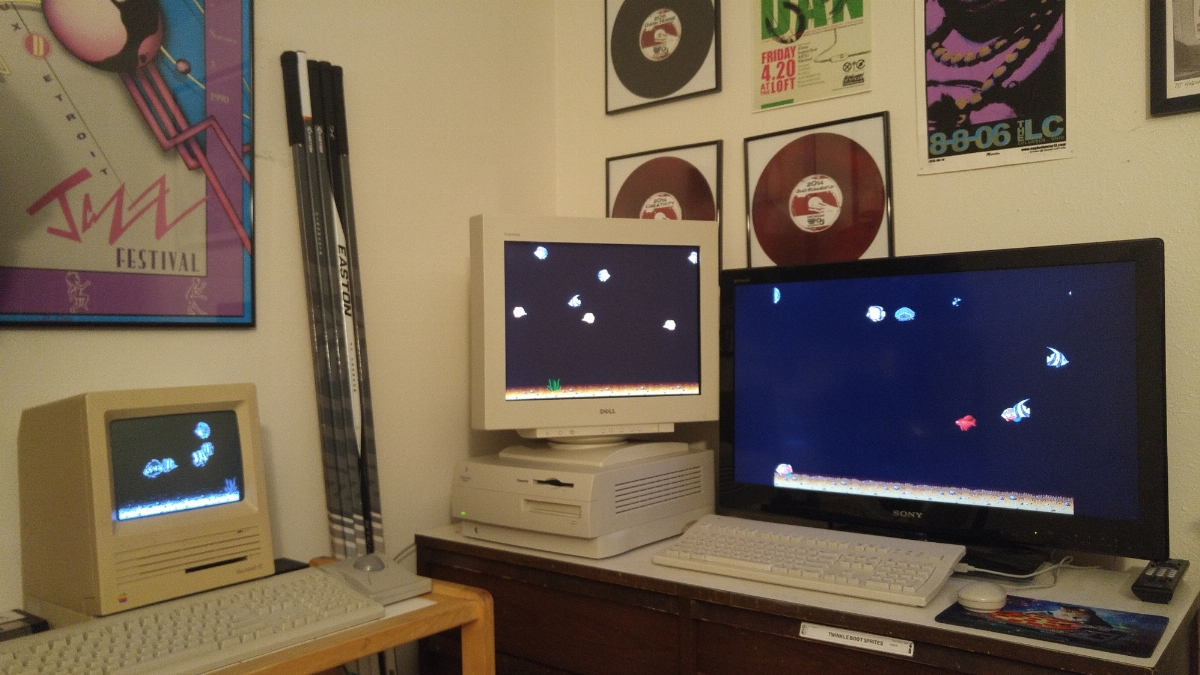

Anyway, below are some pictures of the Mac SE I rescued from craigslist. It was absolutely filthy and reeked of farms and cigarette smoke. I wish I had proper before pictures but I always suck at taking photos during restoration.
For the restoration I did effectively a full tear down. All PCBs were recapped: analog board (chassis for us arcade folks), logic board, and power supply all got fresh caps. A few tweaks on the monitor and it looked great.
The original 20MB HDD was still intact, and had a users data from the early 90s on it. I tossed that, as a SCSI2SD made much more sense. The final config ended up being an internal SCSI2SD with multiple virtual hard disks, booting OS6 and OS7. The machine is capable of appletalk serial connection to my powermac 7500, and the powermac has internet access and file sharing capability. In short I can access a file share on one of my internet connected macs, and that's pretty sweet for an old 68k mac.
I also set up a 2nd SCSI2SD as a virtual zip drive, with hot swappable SD cards. It didn't end up being a necessity for me but I documented the config over on the 68kmla forums. It was really cool, as using the normal zip100 driver and device ID's I could set 1GB volumes in scsi2sd config and they worked fine. The tl;dr was hot swappable 1GB micro SD cards which appear to macos as zip disks.

Beautiful stuff. That After Dark screen saver takes me back. My Mac LC2 and was one of the most fun computers I've ever had.

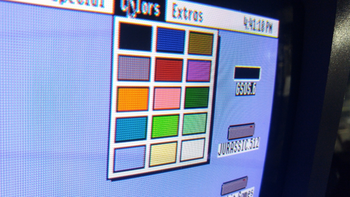

Scored a minty iigs from craigslist recently. The original monitor needs a recap which I will get to eventually, but in the mean time I made a RGB cable for my NEC monitor :D
These pictures don't do the video quality justice, Arkanoid and other games (Silpheed, Out of This World...) look great.
The guy I got it from purchased it from the original owner. I got all the original receipts from when the original owner, a teacher, bought it through Apple Computer's educator buy program in the late 80's. It was like getting a 1 owner car with all the service records lol.
This thing was loved, and aside from the dim monitor, it's in immaculate shape. The archive of software and manuals that came with it were like someone handed me a chunk of the past. The folders contain a bunch of copied manuals and original disks for software like number munchers, oregon trail, and other apple ii classics. I'm really happy to add this one to the collection.
Last pic is using an iigs emulator to work with disk images. Until I spring for a CF solution or floppyemu, that will have to do (but it works quite well).

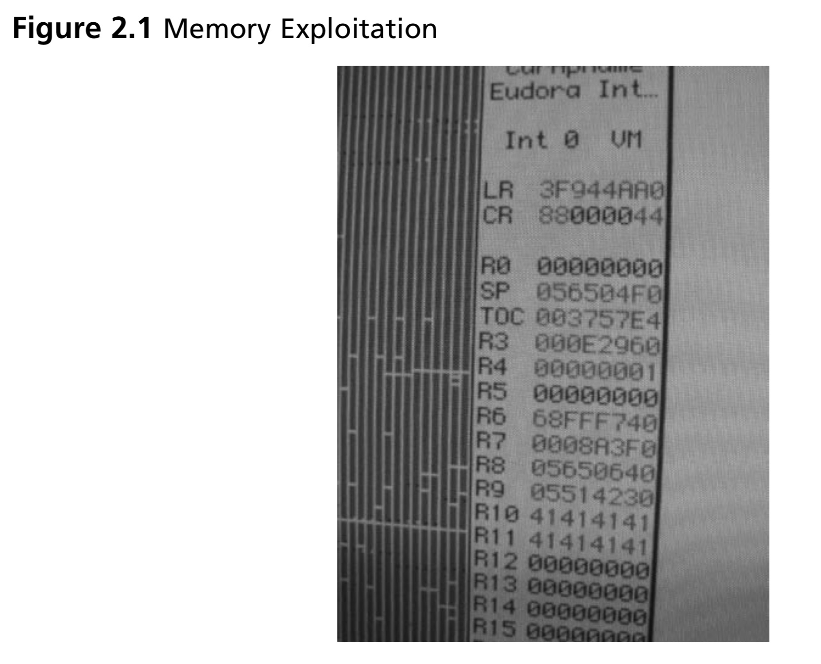

You guys may get a kick out of the second chapter of this Book that I co-authored, I briefly discussed memory corruption in the context of security on OS9 and earlier platforms.

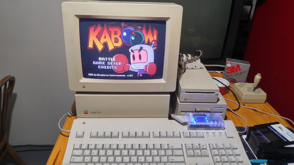

Ordered a ReActive Micro CF card for the IIGS.
It's basically an IDE controller that comes with a CF adapter and card. Apparently it has DMA (direct memory access) so it's a very fast internal storage solution.
I'll definitely follow up when I've had a chance to test it out. For now, I've just been using half of my 4MB ram as a 2MB ram disk, which works for installing and booting GSOS and 1-2 games.

ReActive Micro card is legit. It's basically ram disk fast with DMA enabled. My IIGS cold boots in like 20 seconds lol.
I ended up also getting a floppyemu. While the internal CF drive is great for storage and actual iigs files, some programs (read, copy protected games) are happier running from a floppy / emulated floppy. For ones that don't have to run from a floppy, I have all the disk images on a large HFS partition, and a few prodos partitions where I can just restore the disk images to. When that works, I can reboot to the reimaged disk and it's lightning fast to load compared with a floppy or the floppyemu.
For a hard drive solution there's no comparison though, floppyemu is very slow for every day use. Still a great product, but if storage is your goal, go the CF route.

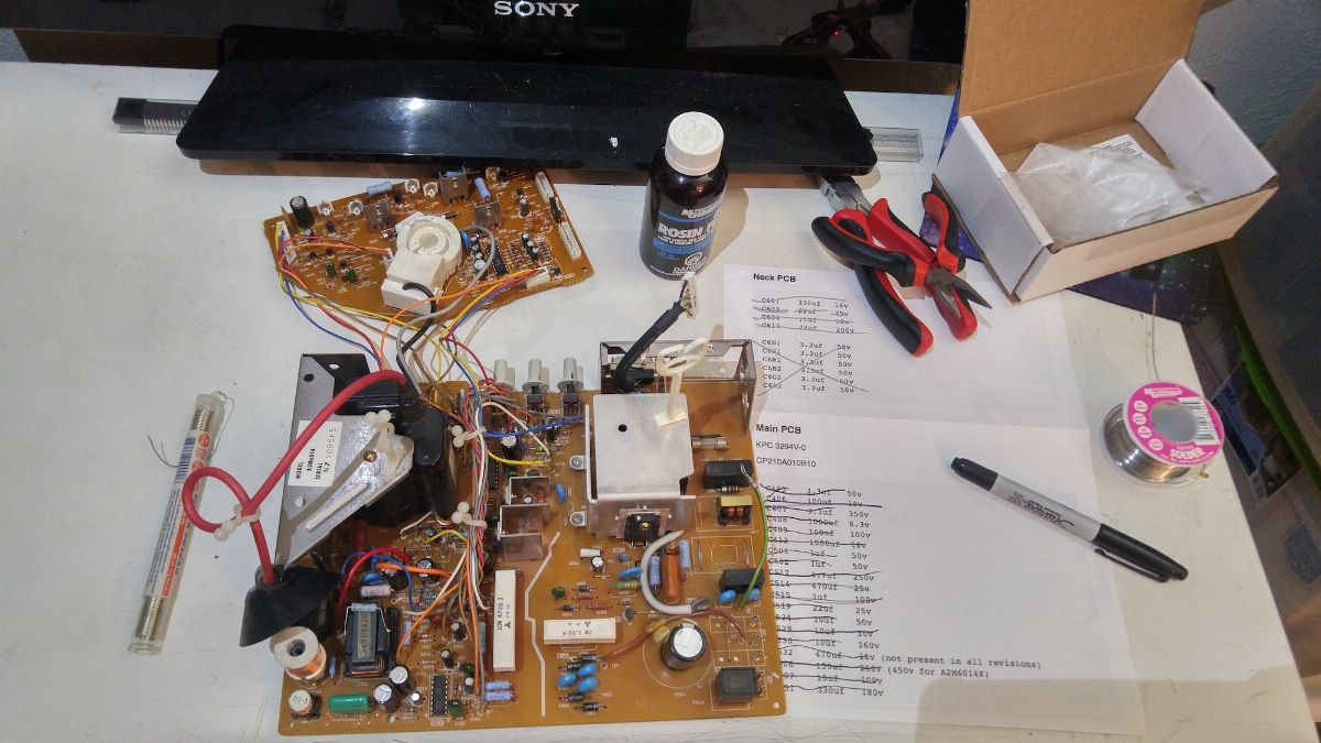

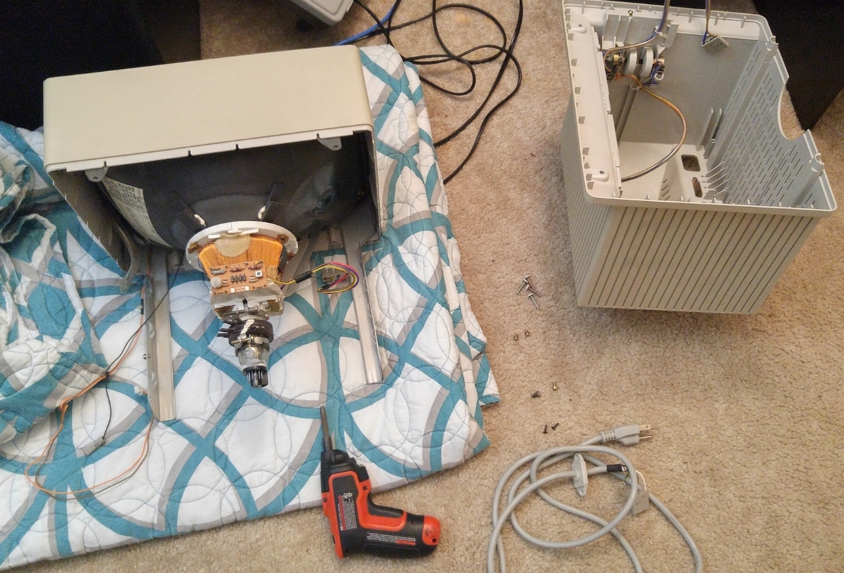

Recapped and dialed in the old monitor today. Copy/paste from my 68kmla post;
This IIgs was clearly loved and used for a lot of hours, despite how clean it is. The tube is definitely high hours; I dialed it in "cold" and this was a huge mistake. I should know better than to adjust a monitor that hasn't been running for an hour or two, but sometimes you can get away with it when the caps are all fresh. In this case... I could not. Once it got to full temp it was way over bright, so after I ran it for an hour I had to completely readjust the screen/focus on the flyback as well as some cutoffs.
The end result, given the age and the fact that being $TIME on affects brightness, was that I had to dial it in to be just usably bright for the first few minutes it's on. Once it's warmed up, it looks pretty darn good for a 30 year old tiny tube.
My only complaint is that this monitor model has virtually no ventilation by design. I may have to look into adding a small fan at some point. It really gets warm after a couple hours. Anyway, here are the pics I managed to snap along the way.
