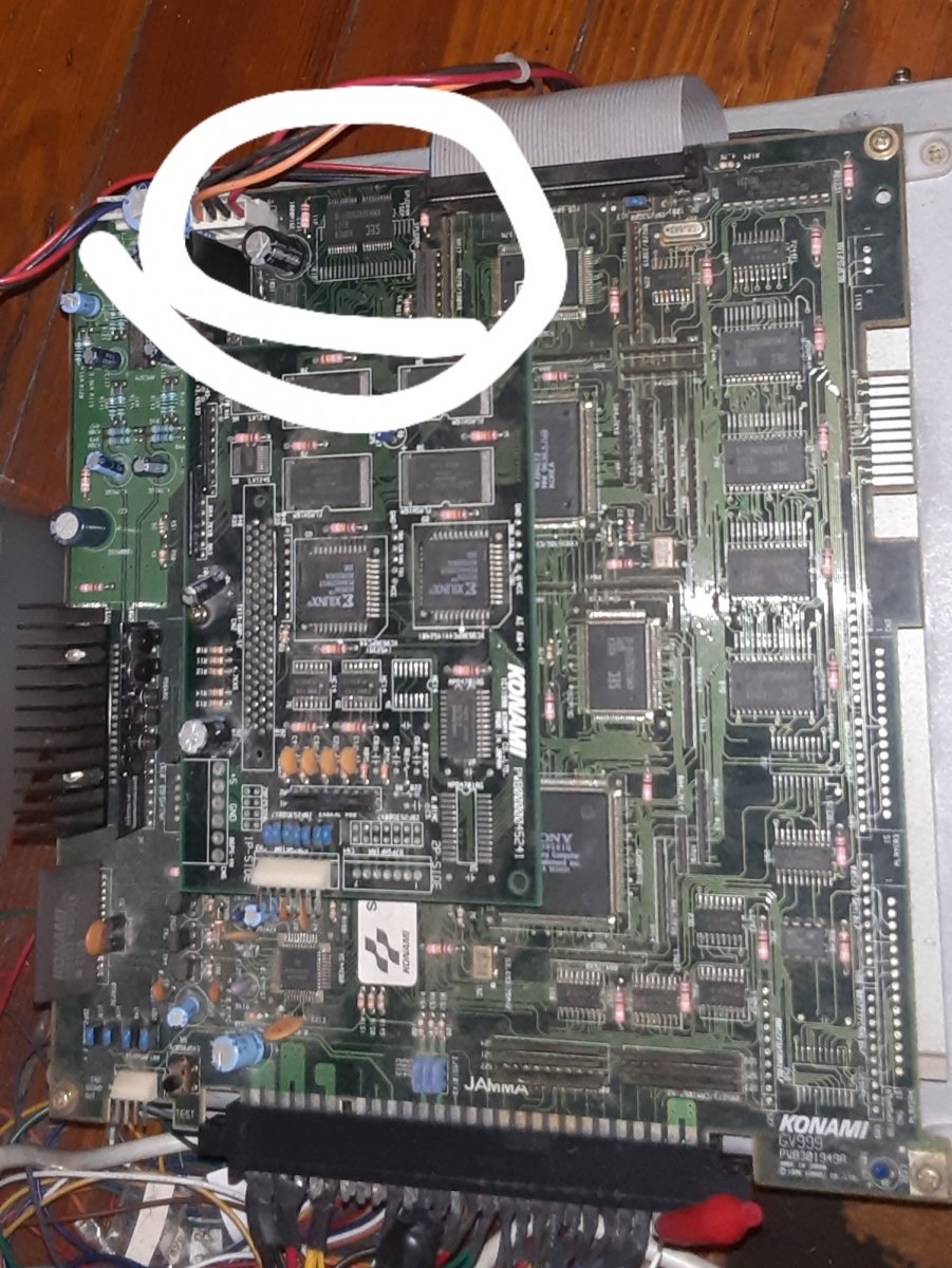

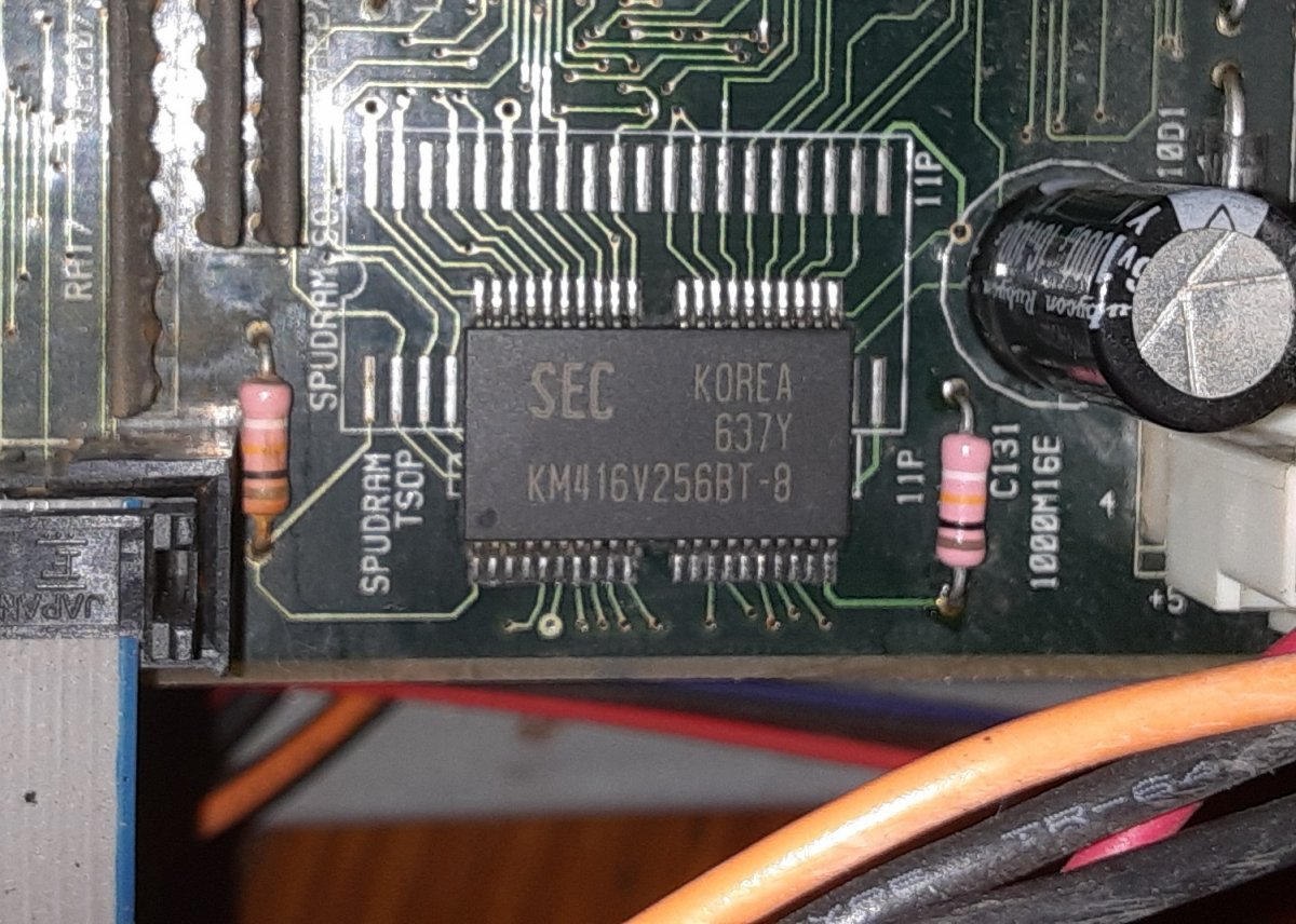

Took a couple pictures, one of the full board with 11p circled and a close up.
I have not been able to get this so called flash chip reprogramming thing to even happen let alone succeed. The manual says press the test button, others have said hold test and service. Nothing happens.
Cleaned the cd disc, was able to rip an image of it without errors.
Edit: Upon some further research, the flash rom check is after the main hardware check and will not start unless the main chips are ok,so any help on the 11p chip would be appreciated.

So, I would figure if this chip is replaced, as long as nothing else is wrong, the board should, in theory work again?
Is there anyone I could have do this repair for me as I would not know how to do it myself?
well i would swap it with another ram first to see if the fault changes - if not then you dont want to waste time/money getting another ram.
it could just as well be a bad track or solder joint or a chip linked to the ram.
Had the same error on my Hyper Athlete board.
I ended up replacing the spu chip. Took one off an old PSX motherboard.
