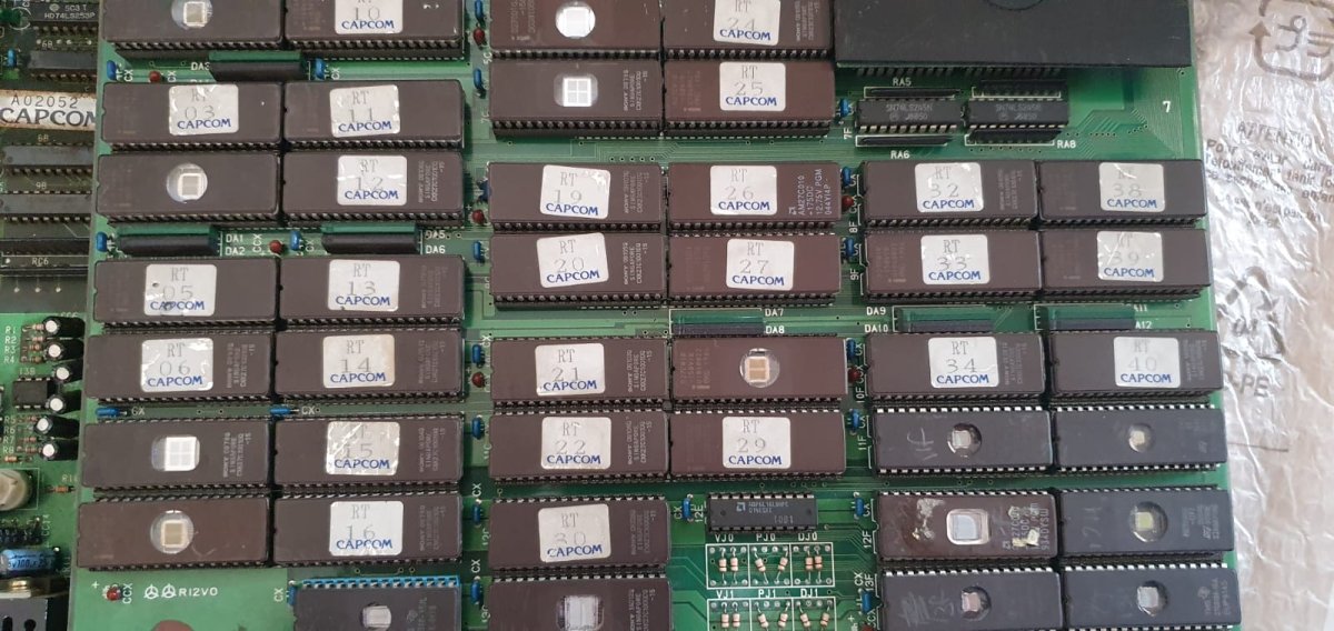

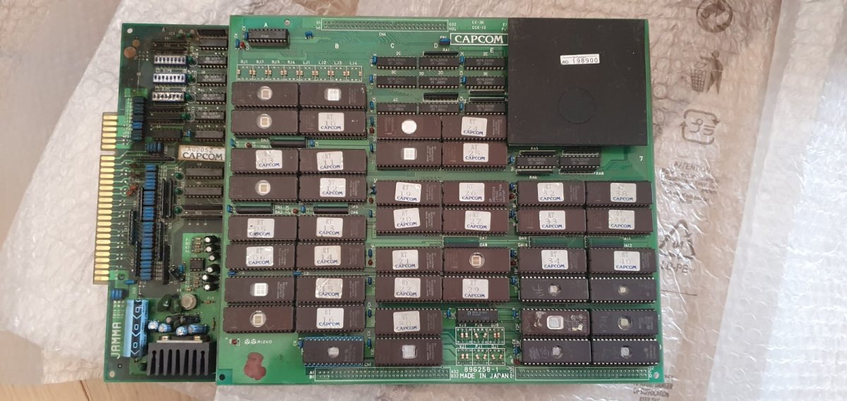

Hi, I have Three Wonders PCB (I think it's been de-suicided because I don't see any batteries on board C).

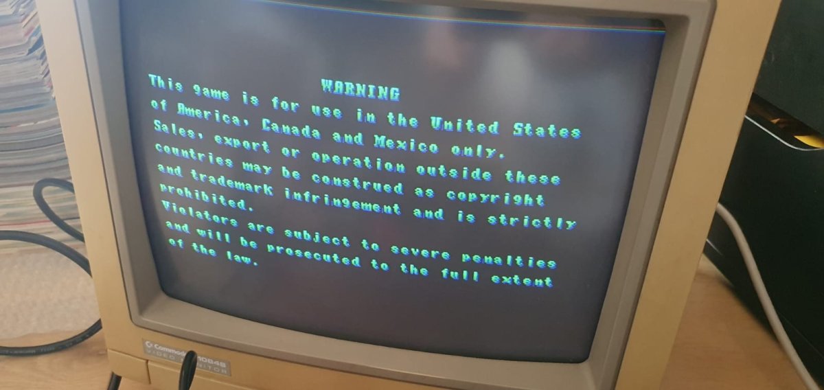

I'm not sure which version it is. US or Japanese? Looking at board B, it looks like the Japanese version, but when I start the games, it says
the first game is Midnight Wanderers, not Roosters.
Any ideas? Maybe a japanese version converted into us version? I don't know if the b-board of the us version is identical to the japanese version (surely mine it's not world version)

Japan version with desuicided set ETC i think
Edit Usa set , but seem strange, original disclaimer have not this color.
Yep looks like it likely started out originally as a Japanese version with de-suicided us version program roms added later on.
That color is due to a cable issue
Yes, I think you're right
