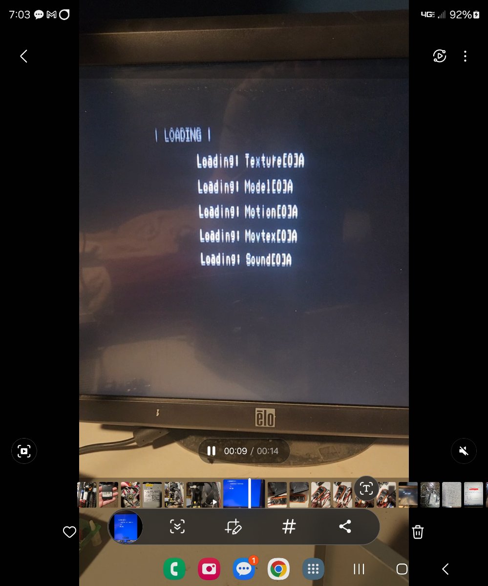

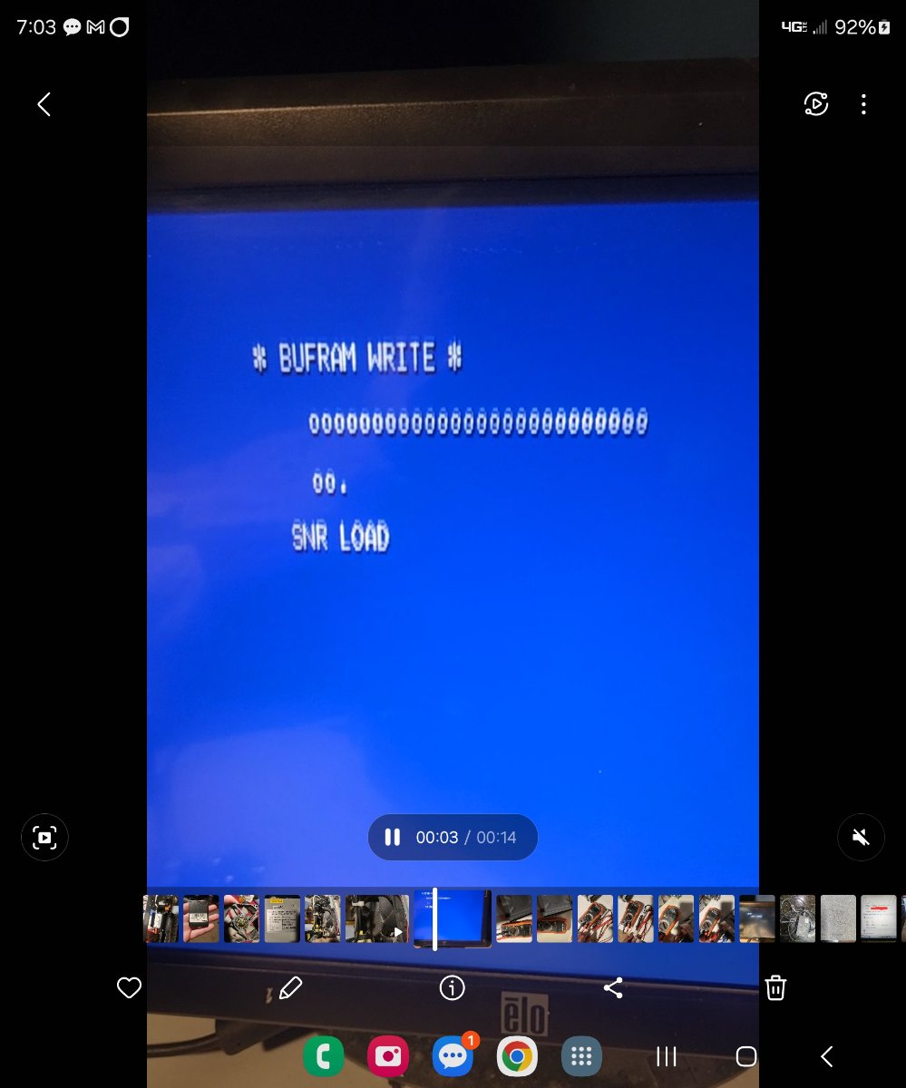

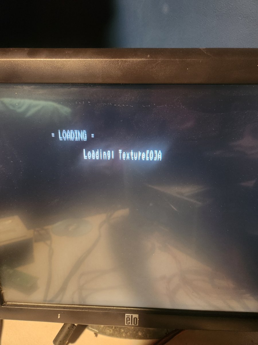

After a few mins most of the time the dvd just stops reading, but while it's reading I can hear the disc spinning and coming though the speakers. When I do get it to load it comes up to a blue screen buffram write (see pic below). Then goes to a black loading screen ( also pictured below). Every now and then it will freeze on the first loading prompt ( 1st picture below with a single loading). But most of the time it will load into the game if I get to the 2nd blue screen. The image on the monitor looks doubled but this could just be the computer monitor I am using.
