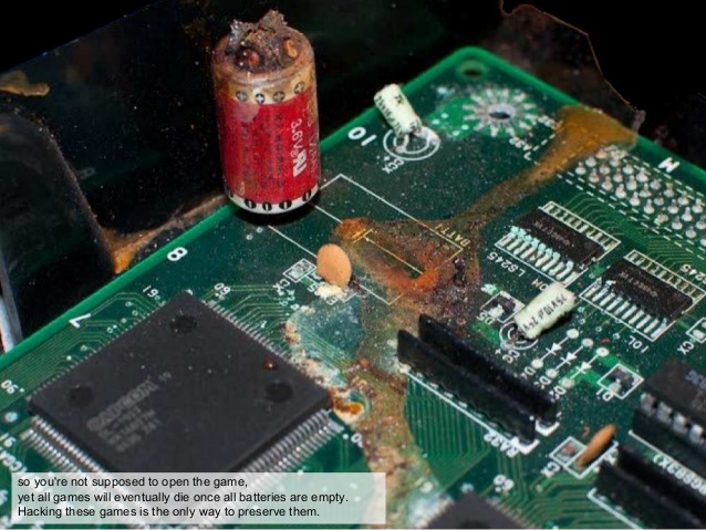

They don’t call them suicide batteries for nothing
A picture is worth a thousand words! The sum of all fears. Just as I'm about to sleep (Japan time), this will give me nightmares, but thanks for sharing :)

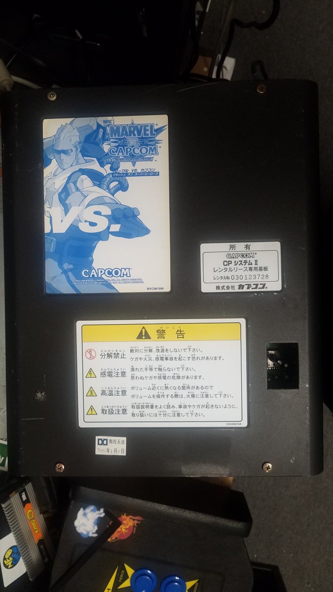

I’m curious about this as well. I’m new to board collecting and I have an ’all-in-one’. Can those boards also take infinity keys?
all in one like this one?

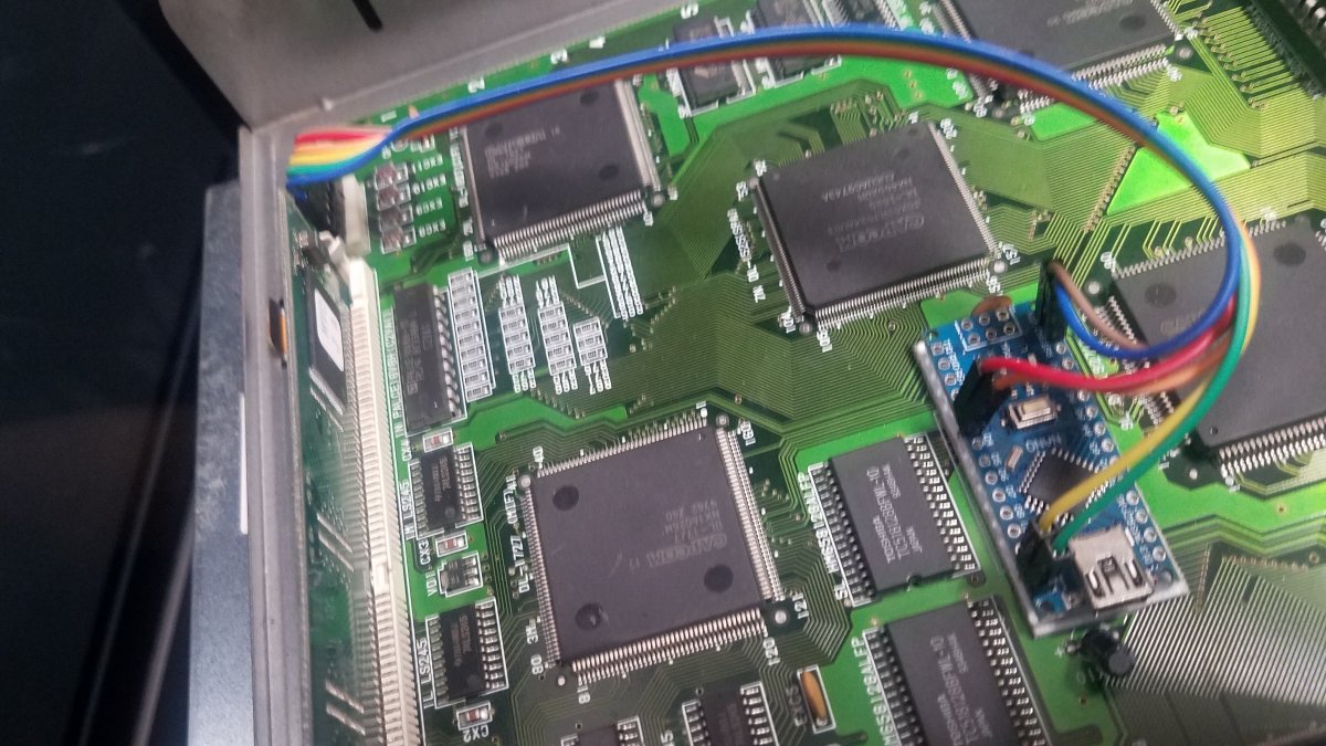

I just got it and it came with the Arduino mod. It's working great.
I never knew about the Arduino mod until I got this on the mail this week
