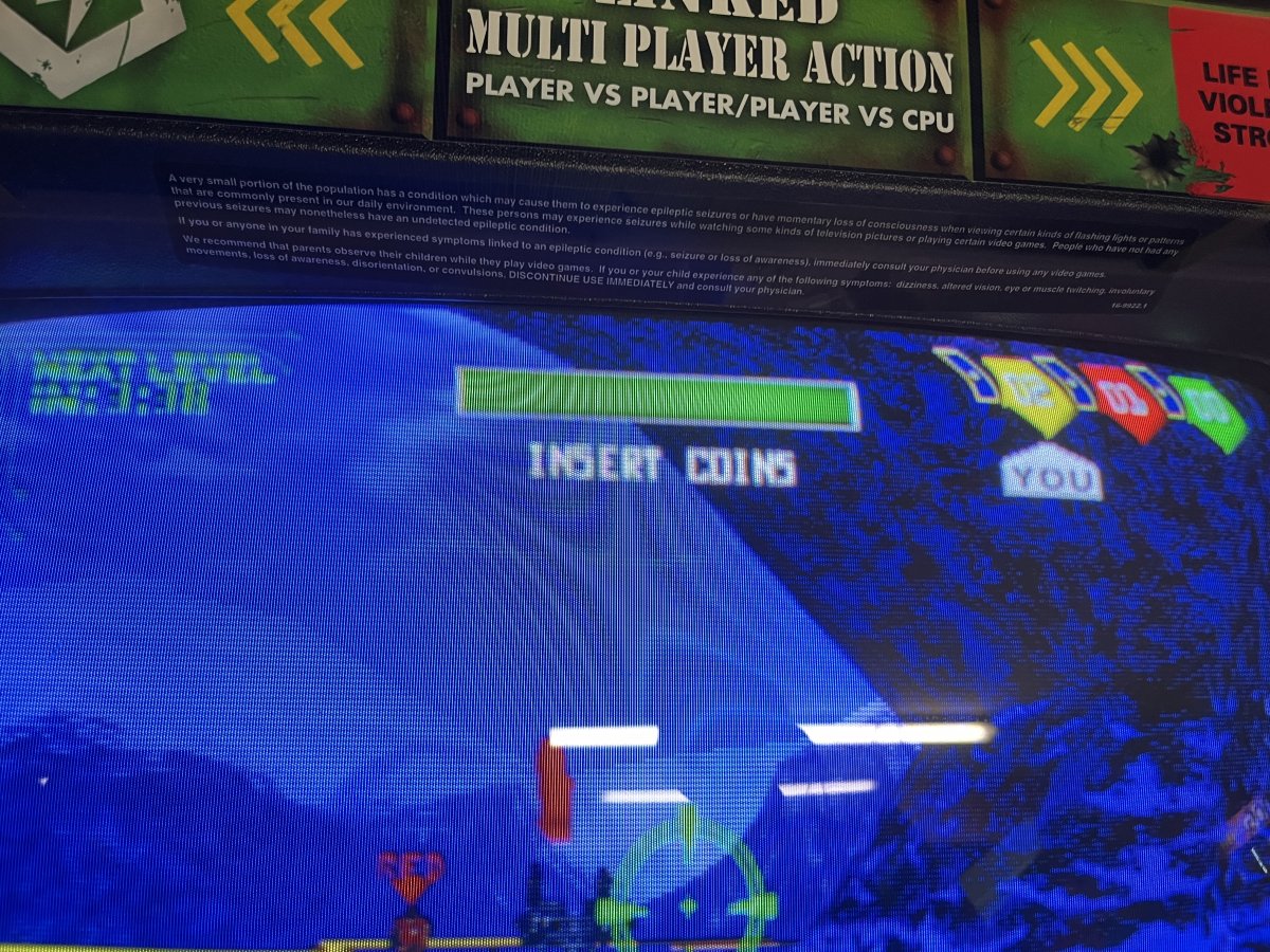

I've been working on this game for a while. "War Final Assault" Was able to get the PC inside working again. Latley the monitor picture has started to bend at the top (after about 30 mins of play) , and then the screen just shears and scrambles.

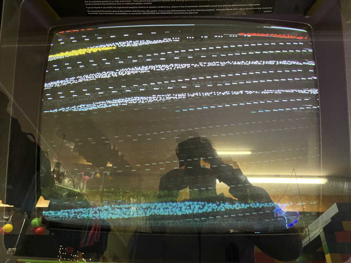

It will fix itself after i turn the game off for 30 mins or so, but again, it will start to warp and then shear/scramble again. Vpos and Hpos seem to be okay.
I am a complete newb on how to work with these monitors, other than the basic adjustments.
Where should I start? Do you think it would be an overheating issue?
Thanks for your help / advice, in advance!

The monitor is losing horizontal sync. If you're lucky, it's just a bad solder joint somewhere on the sync line. If you're unlucky, it's a component that is breaking down under stress.
What monitor is it?
